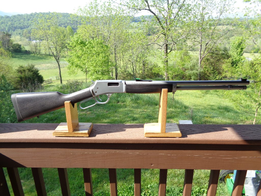

Post by tractortad » Mon Jun 25, 2018 10:18 pm
ESquared wrote:Since we're discussing options, has anyone tried the HiViz three-dot set that's on the Henry website? I'm very accustomed to the three-dot sight picture from all my years with handguns.
https://henrypride.com/collections/rifl ... 7840240665
Thoughts and/or opinions?
Well, since you asked, we have a Henry All-Weather 44 Mag BigBoy that is set up with the the HiViz three-dot from the Henry website. We did this just to see how these sights compare to a peep/globe setup.
Henry BigBoy All-Weather 44Mag.JPG (272.48 KiB) Viewed 2562 times
In my opinion, they work much better than the original factory buckhorns (especially in low light situations), but I think I still prefer the Skinner rear peep/Lyman Globe setup. We mostly use our Henrys to plink at steel targets/coke cans from 25 yds in good lighting and the Skinner/Lyman setup seems to give the best sight picture for this use. If we were to use this rifle for hunting, the HiViz might be better, but for now we'll probably be changing out the HiViz on this rifle to another Skinner/Lyman setup. I installed the HiViz sights myself - it is an easy job for a do-it-yourselfer with average mechanical ability and a good brass punch.

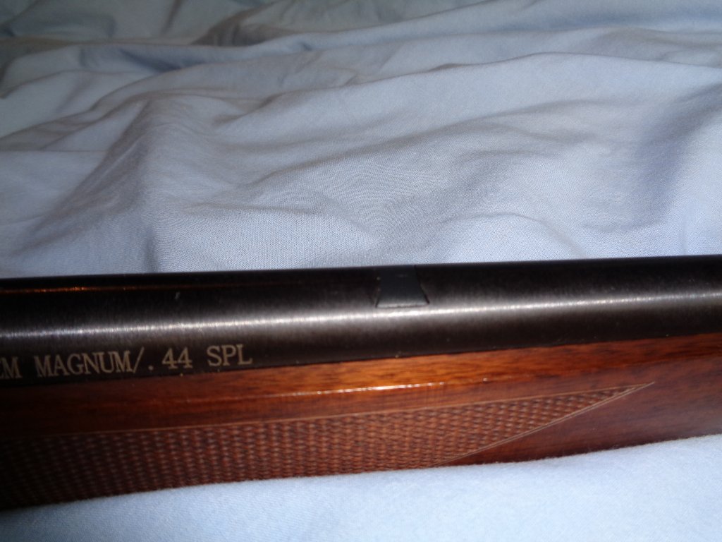

Post by tractortad » Wed Jun 27, 2018 8:02 pm
ESquared wrote:Thanks again, tractortad! I'm about 100% sure (+/-) that the factory sights will have to go. Won't waste a bunch of ammo at the range to prove it, but will give it a fair try. No Buckhorns for me - Low Pro, here I come!
Will try it with the brass bead and go from there. I like that brass bead, based on what PT7 shared with me this week.
More to come!
My guess is that low-pro will work with the factory brass bead, but you will probably have to raise it a few turns from the bottomed out position. Good luck. By the way, if you are looking for a good way to fill the empty dovetail slot after removing the buckhorn sights, check out Ranger Point Precision's "profiled" rifle barrel dovetail fillers - they really clean up the look of the rifle...
Dovetail Filler.JPG (123.75 KiB) Viewed 2812 times

Post by ESquared » Wed Jun 27, 2018 8:18 pm
The hits just keep on coming! Love that dovetail filler!
Is this the one:
http://www.rangerpointstore.com/rifle-b ... fillers-1/
In 0.850 Sporter Barrel size?
tractortad
Re: New Guy, Older Eyes, Head About to Explode, Have Questions
Post by tractortad » Wed Jun 27, 2018 8:46 pm
ESquared wrote:Is this the one:
yes - the .850" in blued steel.

Post by Mistered » Thu Jun 28, 2018 12:26 am
So do I but not the price! I just ordered three 'standard' style dovetail plugs from Skinner for about $ 27 for all three!
