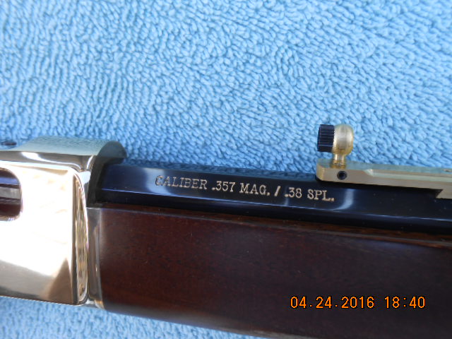

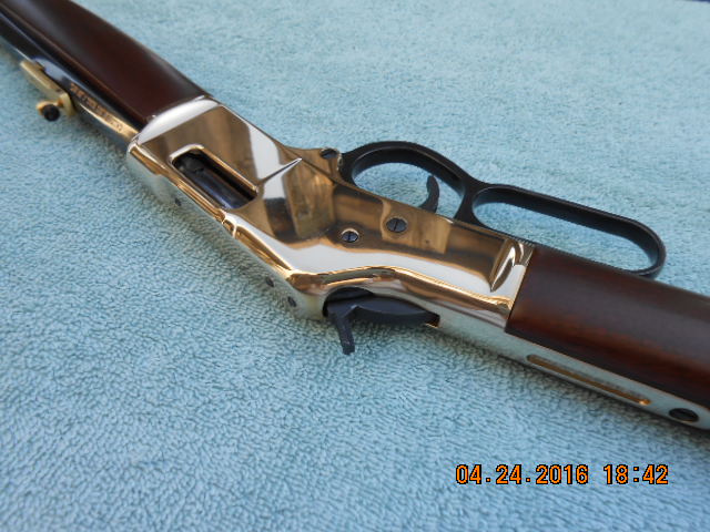

Re: Carbines with barrel peep

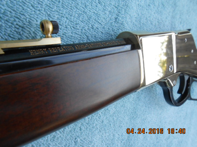

The first .357 magnum Henry I had, which is gone now, was a BBB 20" octagon barrel model. The pics I'm posting below of this rifle & peep really don't look any different for a 20" model or 16.5" Carbine model. Also here is one of the Range Reports I posted in April 2016 when I shot this BB using the peep sight. http://henryrifleforums.com/viewtopic.php?f=42&t=463 I liked it a lot, and it really worked well; easy to quickly grab the sight picture, and quite accurate.
I'll make this comment though. My current two Henrys both have receiver-mounted peep sights. The shorter distance from peep to eye does make a difference....easier to get a good sight picture, and I'd say some accuracy improvement. Either way would be a good way to mount a peep sight. Yes, the cost factor does come into play for sure.
Best on making your decision which mount style to use. Both are darn good. I really like using iron sights, so that's a plus for me.

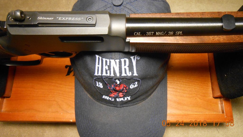

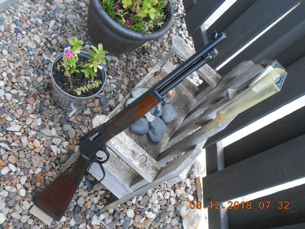

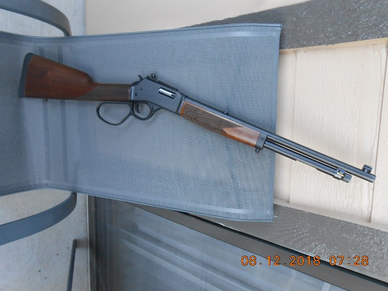

All photos are posted in other threads, but these should give you exactly what I have on my BBS .357 Magnum Carbine.
~~Skinner Express receiver-mounted peep.
~~Skinner dovetail slot blank on barrel.
~~Stock Henry front brass bead sight.
For me and my elder eyes, a great iron sight setup!

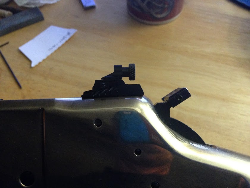

Don't forget the $39.95 option of the Williams WGRS-336 mounted backwards on the Henry receiver with the windage slide simply flipped around. Works very well.but if I buy the Express and a round dovetail filler for my BBS it is almost triple the cost of a barrel mount Skinner
That one item is all they have, and then just for the Henry SGC. They essentially have nothing else for Henry. The WGRS-336 you see in the picture on my BBB is intended for a Marlin 336 but works well on the Henry retrofitted as such.I’ve gone on it twice to look for options for Henryrifles and they only show one item
A .490 standard blade off of a Winchester.What are you using for a front sight?
