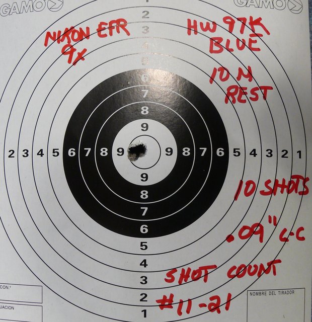

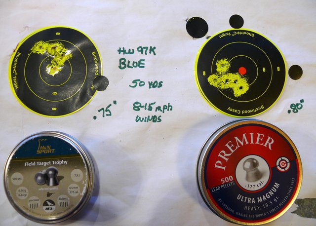

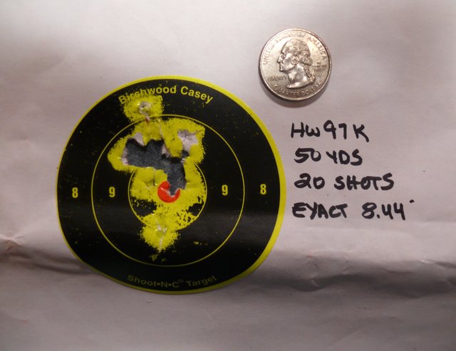

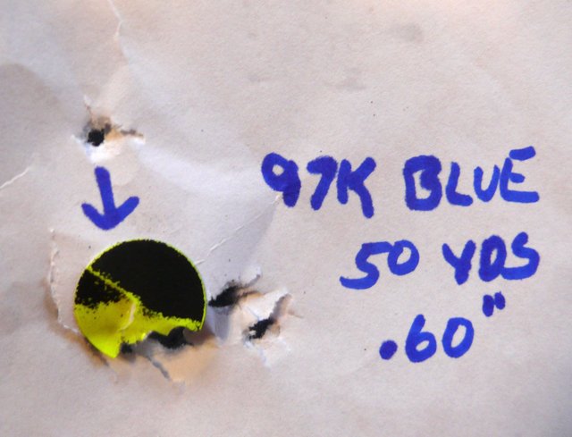

Re: Umarex Origin
As promised. We have two 97Ks. One is the standard stock 97K and the other is the blue laminate stock 97K. The blue lam version is a heavier gun, thanks to the more robust stock. The blue is the better bench gun, but too heavy for my preferred offhand work. The standard 97K with scope is just doable for short offhand sessions.
Here are some 97K groups.

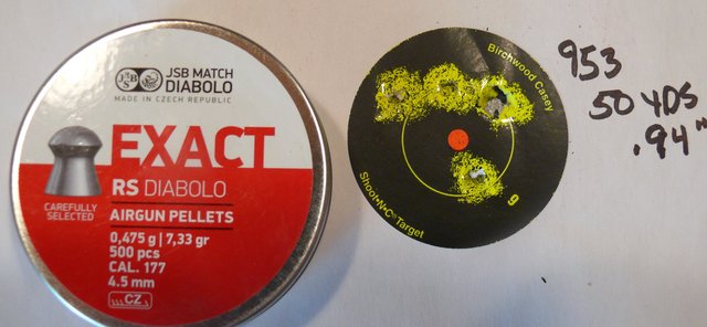

Re: Umarex Origin
Thanks, guys.
Again, I do not want to leave the impression that shooting under an inch at 50 yards requires high dollar air guns. It's still the shooter.
Here's one I shot with a Daisy 953, the cheap version of the better known Daisy 853. Cost me all of $80 new. It's basically a 400 fps 10 yard shooter, so you need a perfect day to shoot at 50.

Re: Umarex Origin
Yep. A good gun will not make a bad shooter good but a straight shooting gun will make a good shot better.
I’m amazed at your accuracy Joanie. A good gun doesn’t shoot itself and still needs someone to pull the trigger.
