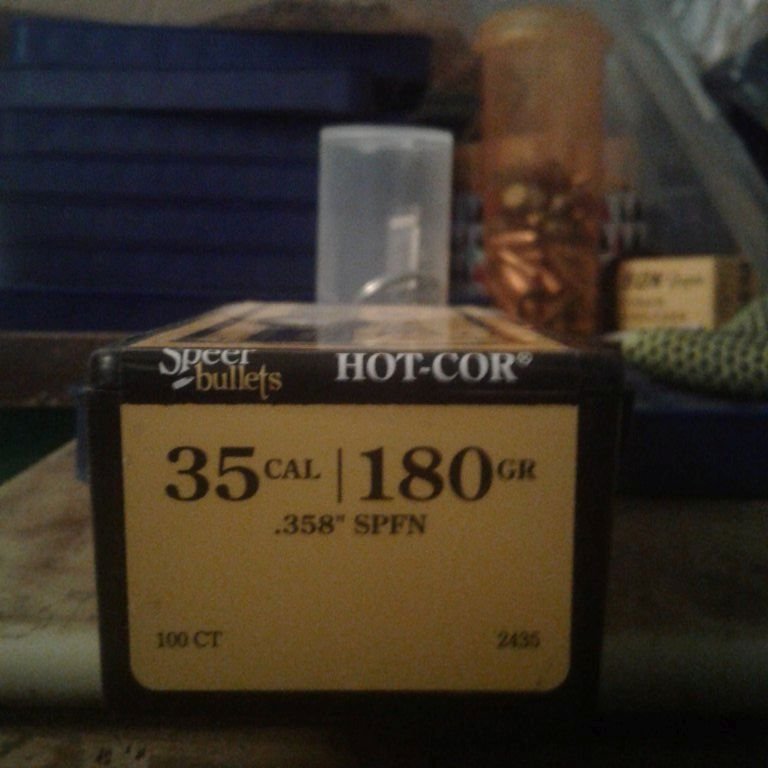

I can send you some 35 cal/180gr, .358" SPFN
Well Heck! This is pretty dang generous of ya!
That being the case I think ten would be enough to let me know how well they would work in the .357 BBB.
I'll PM ya my address if you can spare ten!
