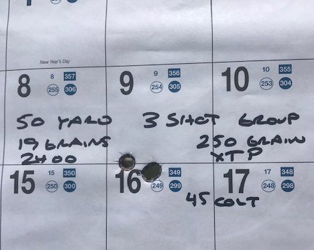

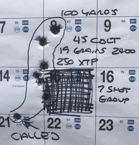

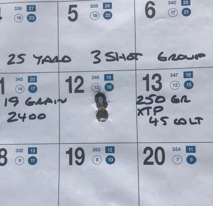

The buck in my avatar was taken with my Henry .45 colt and 250 grain lead bullet. I was using Buffalo Bore 250 grain Deer Grenades. I took two deer that year with the Henry .45 colt (one while wearing only my long johns!) The one in the avatar was about 30 yards away and the long john deer was about 80 yards away, neither deer went more than 100 feet before dying. Last year I hunted with my 45-70 and 300 grain handloads, I also shot two deer that year and the 300 grainers were impressive to say the least. Once again neither deer went more than 100 feet. Here are some range pictures from out at the range the other day. My youngest daughter is going to hunt with my Henry .45 Colt this year so I made sure things are set up for her. these pictures were groups with 19 grains of 2400 under 250 grain XTP.
25 Yards.jpg (64.72 KiB) Viewed 3062 times
50 Yards.jpg (62.69 KiB) Viewed 3062 times
100 Yards.jpg (88.29 KiB) Viewed 3062 times
