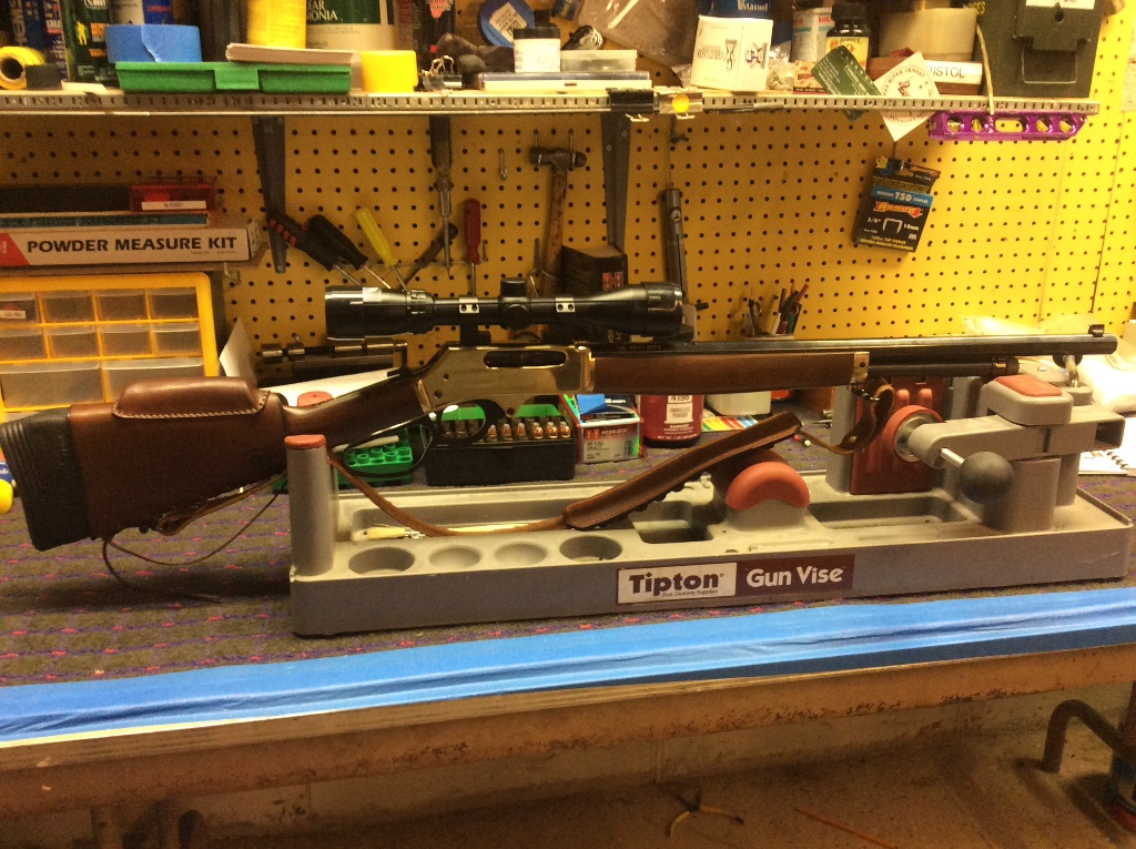

Hello everyone!
I’ve recently purchased a beautiful H010B (45-70) with the intention of using it for deer/boar hunting with my three sons.
After taking it to the range and getting battered by the 300g snhp factory ammo (Great Lakes ammo), I’ve been investigating recoil mitigation options.
I posted a thread concerning recoil on the centerfire page here, and received great input from the members here (I LOVE this site!).
I’ve implemented a couple of the suggstions I received, and am currently starting to reload my own rounds as another option to help with recoil (as well as cost per round).
This is where things start getting a little confusing. The Lee Loader lists a safe load using IMR4198 with a 350g fnsp, the Hornaday book lists a different powder weight for the same powder/projectile, and the 45-70 reloading manual (covers every load published by all the bullet manufacturors in the same book) lists different powder weights for the same projectile.
Kind of hard to determine what muzzel velocity (recoil) to expect when different data is presented for the same components.
I’ve read that around 1600fps is the sweet spot as far as accuracy is concerened, and that people load down as low as 1300fps for hunting loads. If I understand correctly, velocities above 1800fps are not as effective for hunting purposes as the round passes through without imparting its full energy in the animal, plus the added nefative effect of the extra recoil.
Having gone through all that, I dont own a chronograph for developing load data (yet), for the meantime, I will be using felt recoil as my gauge.
I have started with IMR4198, Hornaday 350g fnsp, CCI large rifle (#200) primers.
1st load: 39 grains
2nd load: 32 grains
I am looking for a third and fourth load to try, and will bring 10 rounds of each to the range for testing.
Hopefully one of you fine ladies and gents have a round you have come up with that works well for hunting purposes, without having to worry about knocking the fillings out of my teeth every time I send a round down range.
Thanks for any help you can offer!

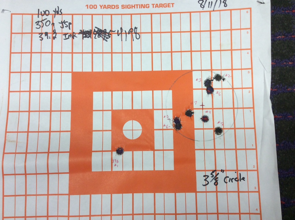

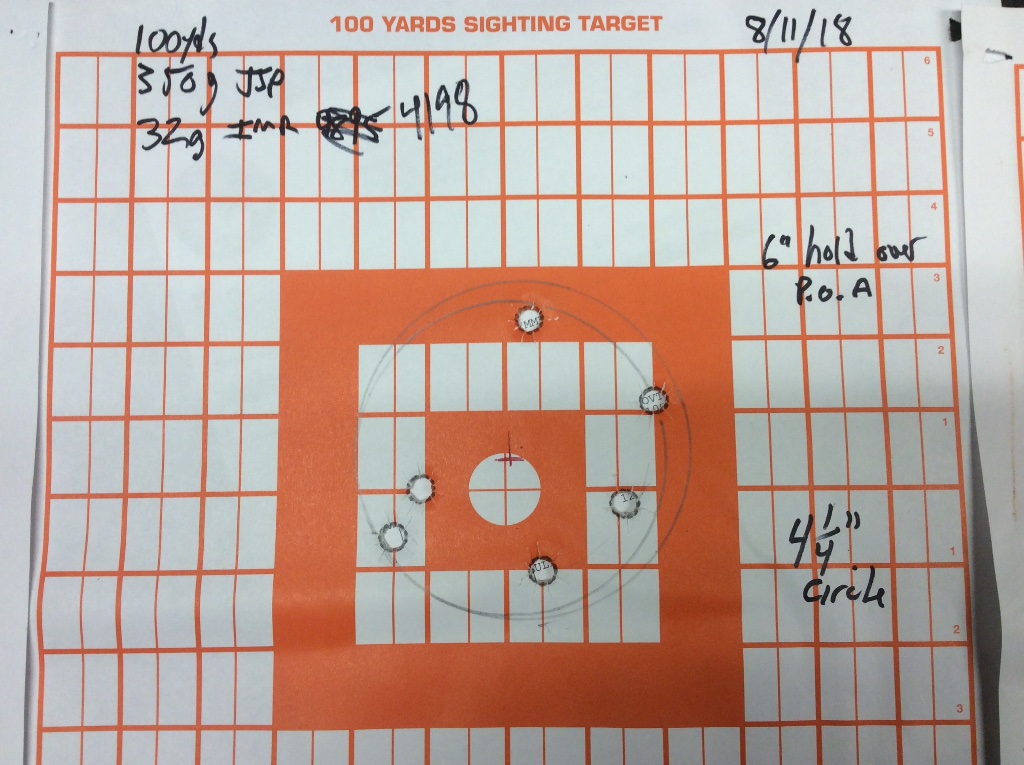

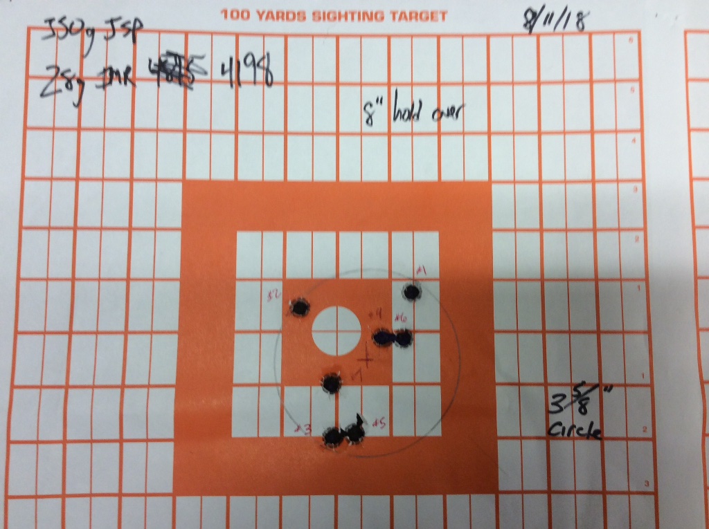

G’morning All,
I was able to slip off to the range yesterday to test my first batch of handloads for the 45-70.
I had some interesting results and would love to post some pictures for review and comments, but I have to admit to being technology challenged. I do not see an option for attachments.
I loaded three different powder weight loads (39g IMR4198, 32g IMR4198, and 28g IMR4198), each using the same brass, primer and projectile.
The 39g loads shot a 3 5/8” group (9 rounds). Point of aim = center of target. The group was centered 3” right and 1” high from the point of aim, at 100 yards. Using a Limbsaver recoil pad, the felt recoil was still quite brisk.
The 32g loads shot a 4 1/4” group (8 rounds). Point of aim = center of target, 6” hold over. The group was centered at the center of target, 1/2” high from the center of the target, at 100 yards. Using the Limbsaver recoil pad, felt recoil was noticeably less than the factory loads and the 39g loads.
The 28g loads shot a 3 5/8” group (7 rounds). Point of aim = center of target, 8” hold over. The group landed 1/2” right and 1/2” low from the center of the target, at 100 yards. Using the Limbsaver pad, felt recoil was very manageable.
I fired a couple factory rounds (Great Lakes, 300g jhp), as a comparison to each load. The recoil was very stout, even with the Limbsaver pad.

All shots taken at 100yds, from a rest with bags, 3-9x scope
