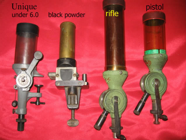

tx gunrunner
Re: Powder Measure
Post by tx gunrunner » Sat Jan 06, 2018 8:06 pm
I have the Lee scooper too .... It takes all 4 powder measures to load all the different type of powders . I have not found any powder I can not load with them .They are for sale too .
