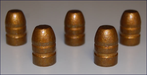

Yeah, the chrono has been fun. I talked to the owner of Missouri a year and a half ago or so. He was planning on having some dies built so he could size to .432. He suggested that I call him back in about a month. When I called him back he told me that had all fallen apart or changed and he wasn't going to be able to size any at .432. I may still give them a try. I have heard nothing but good stuff about Trail Boss, except the price as you mention.
Re: Chronograph testing with .44 Magnum Speer 200gr Gold Dot
Well, I just called Missouri Bullets Company and was very pleasantly surprised. I spoke to an extremely pleasant lady who informed me that they are now sizing some of their 44 bullets at .432 diameter. They are special order of course, but they had some leftovers of a few different 44 bullets from previous special order runs. They had 4 boxes of 500 of their 240gr RNFP 18 Brinnel Hi-Tek coated sized at .432 on the shelf. I ordered 3 of those boxes since that is the most that would fit in the flat rate box. http://missouribullet.com/details.php?p ... &keywords=Squatch wrote:Yep the plated bullets in the same weight and charge seem to fly a bit slower than lead or coated for me as well.
I've been pretty happy with both the lead and coated bullets from Missouri Bullet Company. I've bought in bulk so that keeps the cost down. Nothing custom sized just the off the shelf 18 BHN. No leading issues either.
If you get the chance try some Trail Boss powder. Very clean and consistent though it is a little pricey.
Having a chrono sure is nice isn't it? Nice to know what's really coming out of your barrel.
These will be great to try. They are shipping today and I'll post my results as soon as I test them.

Great stuff. I need to slug the barrels of my 44's and 45/70. but so far the off the shelf MBC have worked fine. If the hardness is right for your load they should seal OK as long as they are close. i've had no leading problems with the MBC bullets coated or plain lead. All are 18 bhn and I've loaded them as low as 750 fps. As high as 1,400 fps.
They also have a nice cannalure. Makes for a nice crimp with my RCBS dies.
After reading about RCBS cowboy dies for lead bullets I called them. The only difference in the dies other than looks is the cowboy sets have a larger .430 vs .429 expanding die. They sent me the larger lead expanding plug for both my 44 mag set and my 45/70 for free. That's the only one I've used so far. The lead and coated bullets fit nice in the case with no scraping of the bullet.
I'll probably buy a 44 special die set this winter. I have a boatload of used 44 spl brass. That way I can leave that die set adjusted and don't have to always be adjusting my Mag die set.
