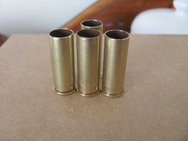

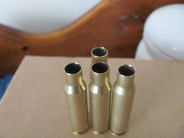

a little while ago I tested the Lee power case trimmer on 3 308 casings and 3 44 Mag casings .... the case in the middle of the front row was not trimmed .... sorry, the picture is about as clear as my camera can produce .... a slight bevel can be seen cut into the 3 surrounding cases .... right in front some thin brass shavings can be seen .... the trimmer sure makes a fine cut .... granted, I've only used it on 6 casings but so far, so good

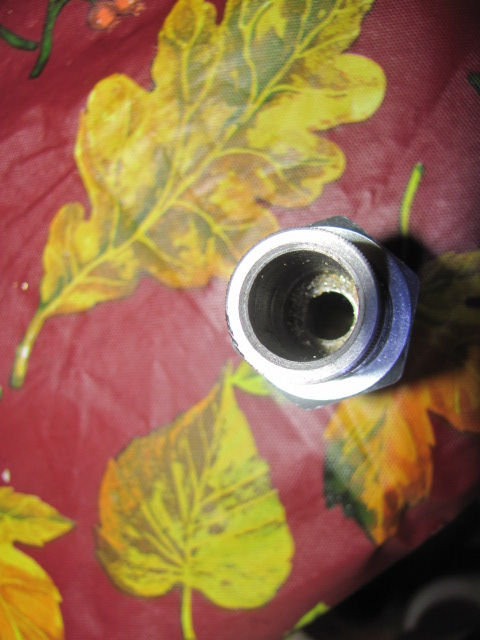

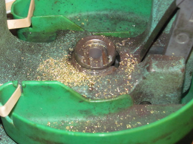

the more I use the Lee Power Quick Trim Case Trimmer, the more convinced I become that it is a good system and it is quickly becoming a valued addition to our reloading tools .... my camera isn't the best but collectively I think the pictures below do show the brass trimmed from 23 308 casings that was collected inside the trimmer die .... I see following the directions, spending time learning/practicing, and using an appropriate power (drill or screwdriver) are keys to successfully using the trimmer

shavings after trimming 50 often used but never trimmed 44 Mag casings ....
