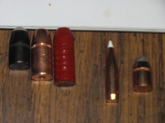

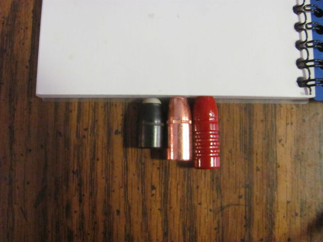

shown below (left to right) .... Nosler 300 gr ballistic silver tip ---- 400 gr Barnes .45-70 Jacketed FN FB .... 500 gr Acme Bullet Co. Grain RNFP hard cast coated bullets
links related to above bullets found in opening post in this thread .... each of the 3 will be loaded to the Max .... should be interesting

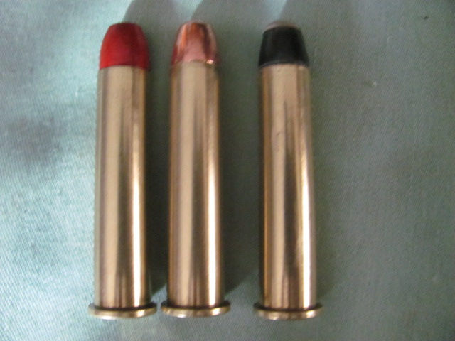

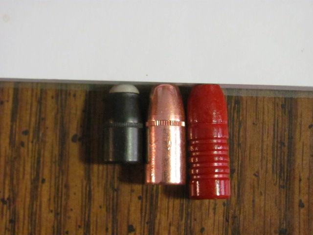

I'd love to be able to say I knew this all along but that wouldn't be the case .... take a look at the crimp ring on the (left to right) 300, 400, and 500 gr bullets shown below ....they are located on each bullet so that when crimped, the shell's OAL will be the same .... with that being the case, fitting in a lever action's magazine shouldn't be an issue .... the best loading data I've found for the 500 gr coated, cast bullet comes from RCBS as listed on page 40 in "The Complete Reloading Manual for the 45-70 Government" ===> https://www.amazon.com/Complete-Reloadi ... B004JOGNQS .... for Marlin Model 1896 Standards (which Henry has adopted) they list 4 different powders, for a 507g cast bullet .... since I have some on hand, I plan to start with IMR 4198 .... minimum load 30 g <muz vel 1254 fps> / maximum load 32 g <muz vel 1337 fps> .... over time I've come to highly respect RCBS .... I'm looking forward to getting some put together

Ojaileveraction
Re: Absolute and Final Plans
Post by Ojaileveraction » Sun Jul 09, 2017 6:38 pm
I missed that. Great info! Thanks.
The Picture is worth a thousand words itself.

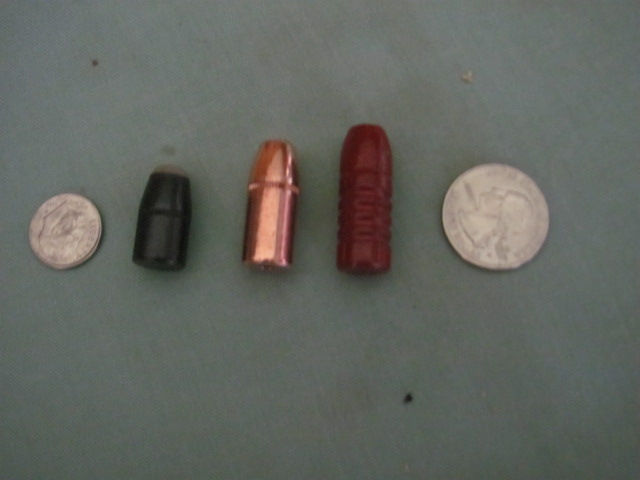

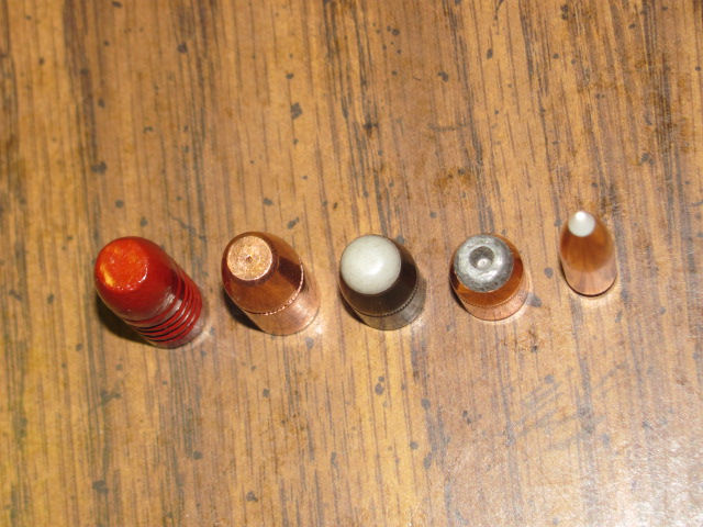

preparations to begin reloading for our 45-70 continue .... the pictures below show them with a 30 caliber 180 grain spitzer bullet and a Nosler 44 caliber 240 grain JHP .... the pictures do not do justice to the real size and weight difference ..... I'm looking forward to getting some loaded and sent down range

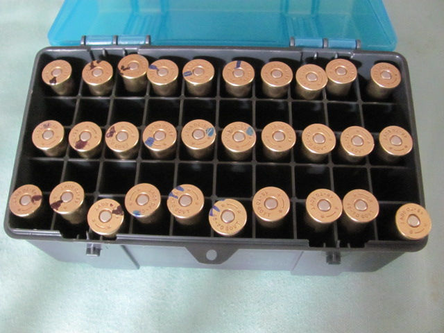

I spent a good portion of the morning loading 30 test 45-70 hunting level rounds .... as noted above, 300, 400, and 500 gr .... 10 of each, 3 minimum recommended powder charge, 3 mid level powder charge and 4 maximum powder charge .... in the picture below minimum charge marked with black, middle charge marked with blue ink, maximum not marked .... I hope to get out next week and test them .... plan to take the chrony and will be looking for the best group .... will be using the Lead Sled so as to eliminate as much human variation as possible

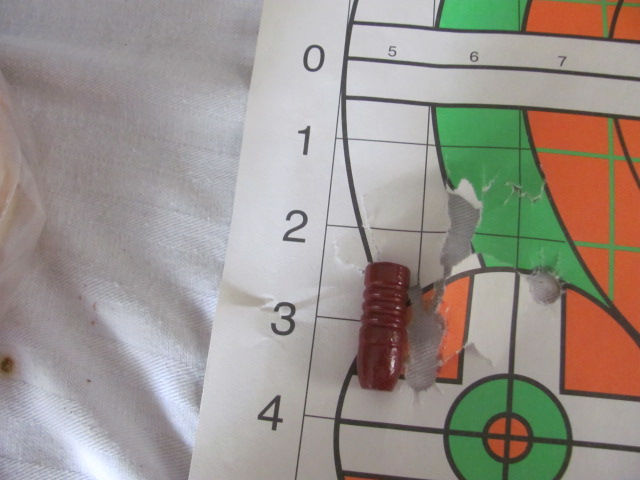

Post by JEBar » Wed Aug 09, 2017 1:58 pm
just got back from spending the morning testing the 45-70 hunting bullets mentioned above ..... biggest surprise, (first 3 pictures) at 35 yards the 500 gr Acme Bullet Co. Grain RNFP hard cast coated bullets tumbled unless loaded to the max .... I don't ever recall having a bullet to tumble like that .... I'm going to load 10 more to the max and will also try a different powder .... last picture shows a group of 3 max loaded Barnes Buster 400 g at 35 yards .... that appears to be a winner to me and I plan to put together more of them for further testing .... groups of the 300 grain Noslers were hands down the best .... regardless of load all 10 grouped within 2" of each other .... as of right now, Noslers will be our primary hunting round
