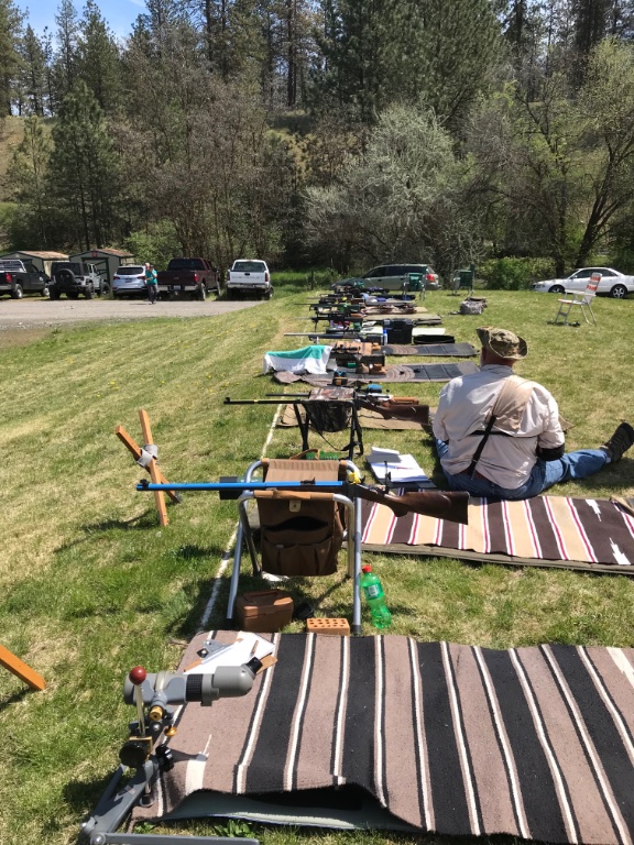

No experience with what you’re trying but I do have a comment. I shoot a modified F-Class mid-range event and we share the firing line with the local Black Powder Cartridge Shooters. We shoot at 600 yards (used to be 300 & 600 but the format was changed to 600 only). Anyway, it’s absolutely amazing to watch these BPCS shooters do what they do at 600. It’s kind of funny to be locked on my target and ready to send a shot and have a big cloud of smoke surround me. I’ve learned to time my shots with the BP guys.
As you said, these shooters drop the empty brass into a jug of water and they also use a tube to blow air through the bore. Not sure why they do that however. If I can find it I’ll add a picture of the firing line that shows a BPCR shooters rifle. They don’t shoot lever action’s, but some kind of single shot.

Hathhdog, Thanks for the photo. The blow tube is used so the moisture in the breath will soften the black powder fouling. Watch Tom Selleck in Quigley Down Under and you will see him do it

That is some fun shooting there! I notice the parking area located down from the firing line. Do they have a cease fire when someone pulls in?
