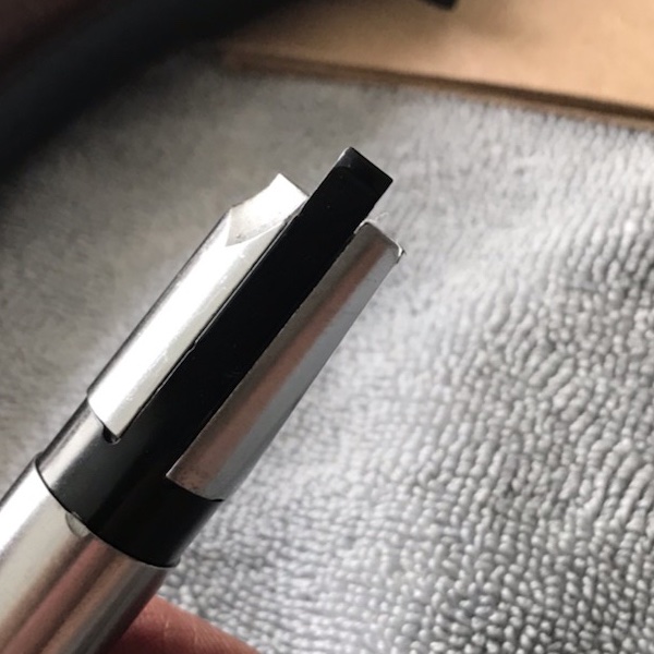

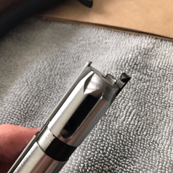

Ok I shot three Hornady loads and they hit nice and tight. Couldn't lock in the next grizzly loads - For whatever reason the lever wouldn't close. Had a panic attack thinking my bolt seared off some material and came home thinking there was a MAJOR problem and those loads $%&#ed up my rifle. Turns out my bolt is supposed to look like this and my grizzly loads were a tad long and for whatever reason messed up the cycling. Live and learn I guess but I'm really glad nothing is wrong. Strangest day at the range to date.
Here's my bolt and seriously thought it wasn't supposed to look like this...

Looks fine to me. Whats the OAL of those grizzly loads

I measured every single round when I got home. They were perfect 2.55" total length. They only looked long because my factory bear loads are shorter by .15 when I compared them at the range. Weird. Whatever happened soon will be yesterdays news (thank god) and my rifle is perfect. Only shot 12 rounds before I packed up. Was so distraught I didn't track or take pics of the target.

OK here is what happened... my first two crimping attempts on the Grizzy loads (I think my first crimping ever) was too much and bubbled out the shell a tad. This caused the round to get stuck in the chamber and not seat all the way creating this whole mess - whew I'm glad I figured that out because I'm really scratching my head on the lengths of the rounds. They all fell in the parameters of being OK
