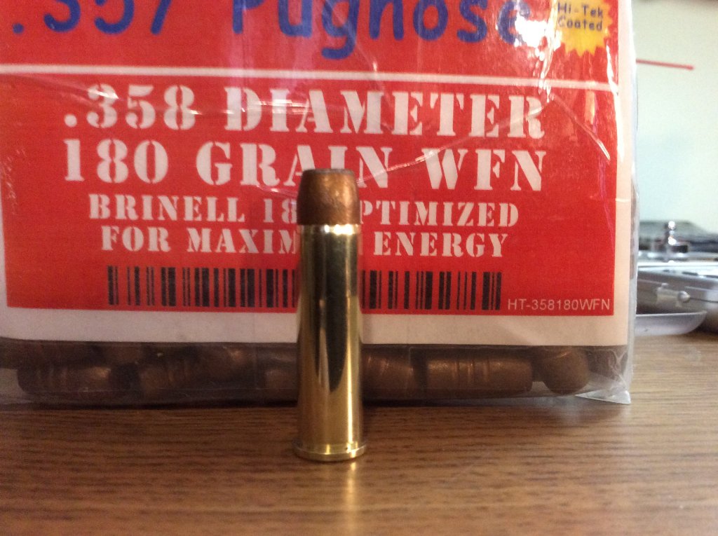

Post by fortyshooter » Mon Mar 08, 2021 9:59 pm
I use the Dillon dies on my 550 for 38/357 and get great results. If you set up the seating die with a short case a case .010 or longer will give you too much material and of course a tighter crimp compared to the one you set it up with.

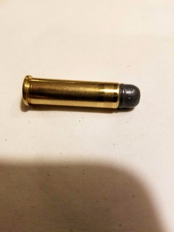

Post by gpraceman » Mon Mar 08, 2021 11:59 pm
Here's a sample round. There are two shiny bands near the case mouth where the carbide ring looks to be doing some sizing. Probably too little crimp. These are loaded to 1.590" COAL.

Post by fortyshooter » Tue Mar 09, 2021 9:01 am
Looks like it has a slight roll into the groove. Was that a shorter case length on that one? Looks like you have some crimp groove left.
My Dillon crimp dies use a modified taper crimp which for me seems to work well in revolver loads and .45 ACP type load or for bullets that don't have a crimp groove. On the 550B you still have seperate stations for sizing, powder dump, seating and crimping. I do use the Redding dual ring carbide sizing die for .45 Colt which sizes the lower part of a Colt case to a lesser degree to get rid of the over sizing look the Dillon and other dies do.
