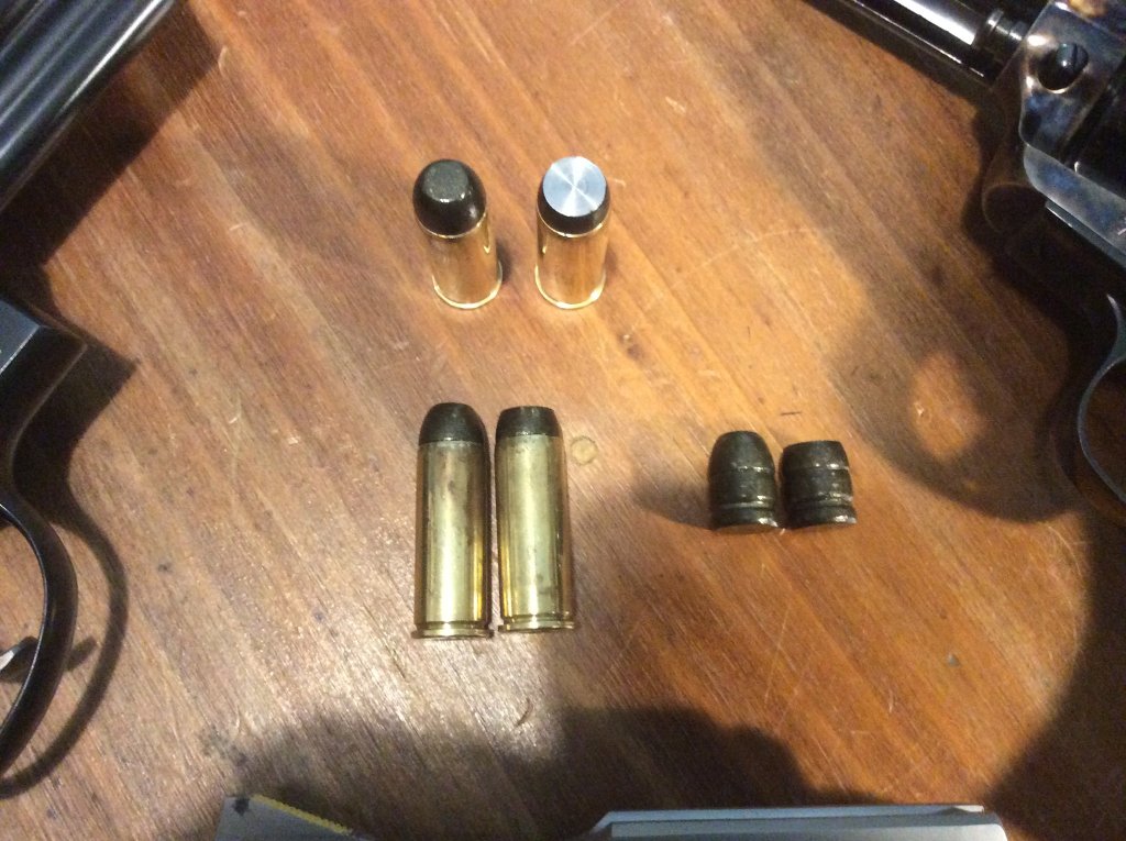

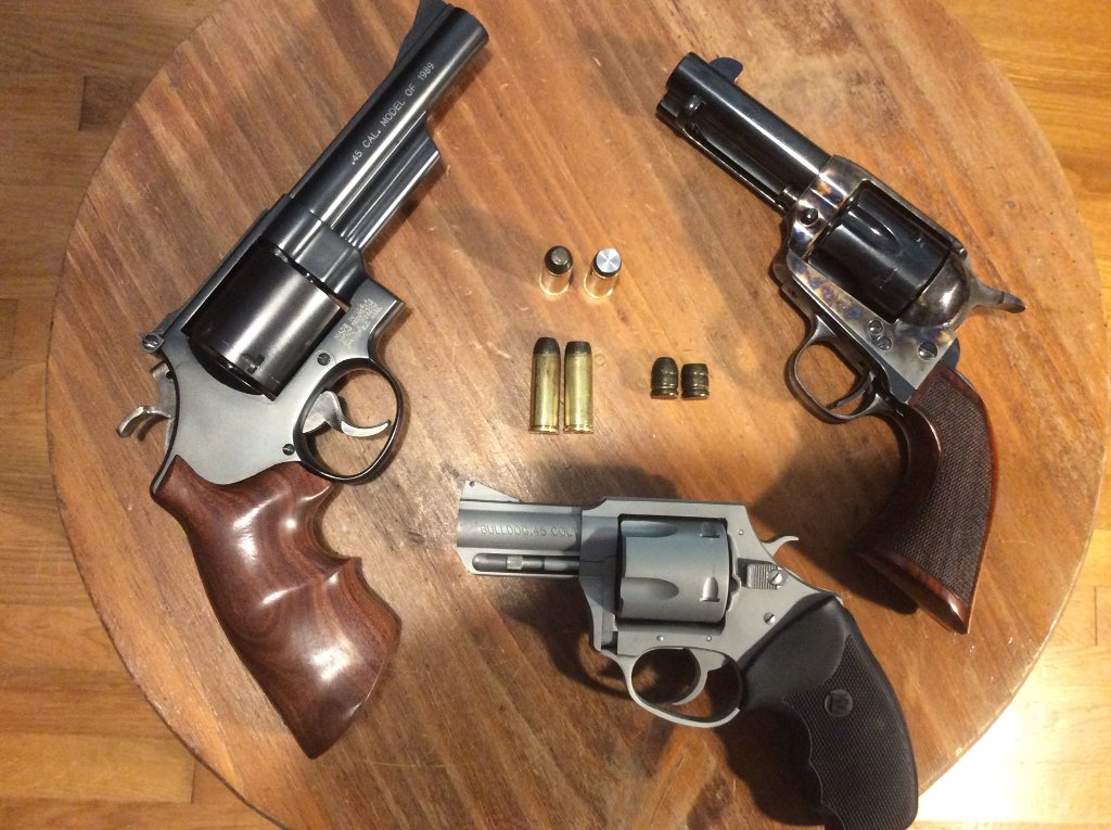

So here's a choice if what you have are 250 gr RNFP cast bullets but you want a harder hitting bullet at standard Colt 45 power level with excellent penetration. Not a full wad cutter and intended for revolvers but MIGHT feed in some lever rifles these are my 230 gr. Hammer Heads loaded with 8.5-8.7 Unique powder. I'll call them the "Trouble Shooter"
Work great in small to large framed .45 revolvers and will bring some thump to the target....plates...4 or 2 legged critters.
With the long wait for bullets if you order..I just setup a batch of the Missouri Bullets 250 RNFP in the lathe and cut them back to a true .380 diameter flat nose which gives 230-234 gr. weight. COL is 1.480
Should be in the 870-920 FPS range depending on revolver and barrel length.

Gotta say forty, fine looking bullet you've made there. As Al said, range report will be interesting to see. Like you pictured revolver collection. Know you have more. Finished all my .empty .45 Colt cases today. That means another desert trip. And wife wants more damn rocks! :?

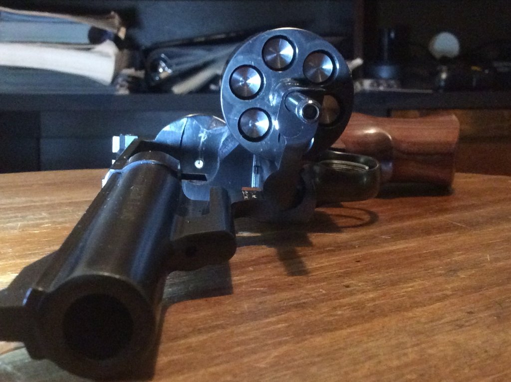

Post by Hatchdog » Sun Dec 06, 2020 10:15 am
Your first pic with the revolver pointed at the camera with the cylinder open is awesome. Those custom bullets look ominous :shock:
