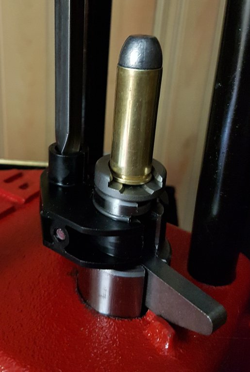

Post by RanchRoper » Fri Mar 29, 2019 10:52 pm
Haha...
I adjusted the seating and crimp...was a little too deep. Much better now. Looks like factory.

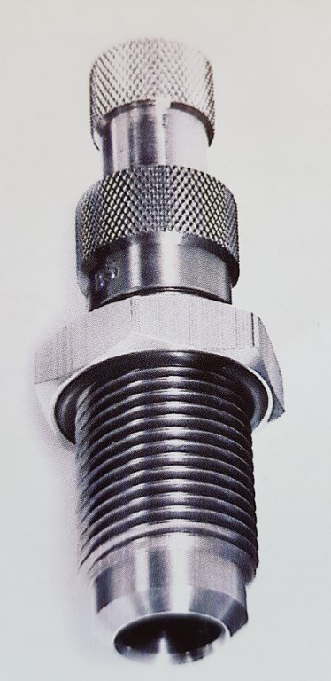

Re: RanchRoper's Reloading Ruminations
Post by RanchRoper » Sat Mar 30, 2019 12:23 am
I don't quite get this die at station 4. It comes with kit but says optional. Seems redundant. It does not feel like its doing anything and even says that.
Guess can't hurt to have a final quality control station.

Post by Rifletom » Sat Mar 30, 2019 10:29 am
That just crimps the round. It does not seat bullet at all. These are handy to use. It is adjustable for light, med or heavy crimp. Easy to use. You'll like it. BTW, what OAL[over all length] are you at? 250gr LRNFP correct?
Post by RanchRoper » Sat Mar 30, 2019 10:57 am
Correct. At Winchester factory spec right now.
The 3rd die seats and crimps, and the 4th die looks like a safety check for size and crimp.

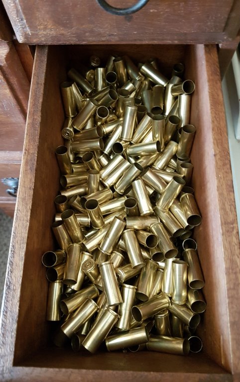

Post by RanchRoper » Sat Mar 30, 2019 11:52 am
Got another 300+ brass cases going in the tumbler this morning. I put in a little brass polish just to keep you guys happy. This afternoon I will load a few rounds. As per the manual 6.5 gr of Universal. Start with that and see where it goes from there.
Post by ESquared » Sat Mar 30, 2019 12:23 pm
The third die seats and crimps? That's a new one on me. I got Lee Four Die Sets, which included the Factory Crimp Die as part of the process...You want to crimp for sure, but I'm unfamiliar with the Lee die that does both...
Post by RanchRoper » Sat Mar 30, 2019 12:35 pm
ESquared wrote:The third die seats and crimps? That's a new one on me. I got Lee Four Die Sets, which included the Factory Crimp Die as part of the process...You want to crimp for sure, but I'm unfamiliar with the Lee die that does both...
Unless I'm missing something. I had a seated and crimped bullet come out of the 3rd die. ??
Post by ESquared » Sat Mar 30, 2019 1:42 pm
Hmm. As part of your tune-up/debugging, you might take a dummy round that you've seated, then set up your Factory Crimp die and run a couple through so you can see the difference. For revolvers, it seems like the seater die is good enough.
I think you WILL see a difference, so it's just a matter of preference, I guess. If you're getting enough of a crimp from your seating die to ensure that the rounds in the mag tube aren't going to move that bullet, then you're good to go. The factory crimp is just a bit of extra insurance for tube-fed rounds, as i understand it.
Ojaileveraction
Post by Ojaileveraction » Sat Mar 30, 2019 1:49 pm
I use a crimp die because I don't crimp during the seating process.
One or the other, not both.

Ojaileveraction
Post by Ojaileveraction » Sat Mar 30, 2019 2:04 pm
When Crimping jusing the seating die a common case length is important. The Lee Factory crimp die is more forgiving of different case lengths.
