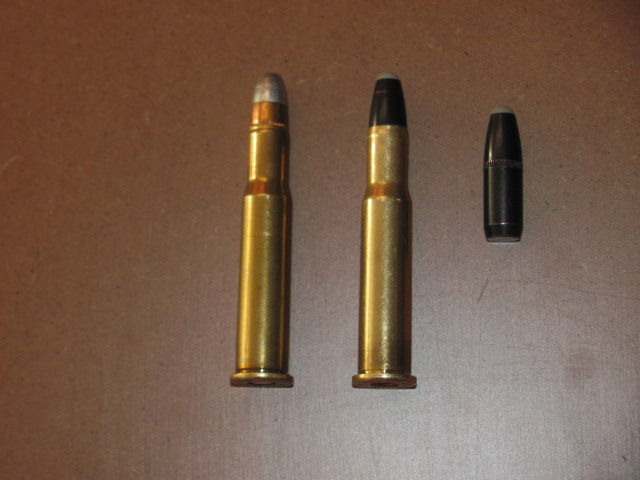

ESquared wrote:What's a "crimp ring"? Same as cannelure?
the picture below shows our old 30-30 loads that used a Winchester 150 gr Silvertip bullet, in that picture the crimp from a Lee Crimping Die can be seen .... the center shows our current Winchester/Nosler Combined Technologies Ballistic Silvertip .... the third shows one of the Ballistic Silvertips with its Cannelure (AKA crimp ring)
