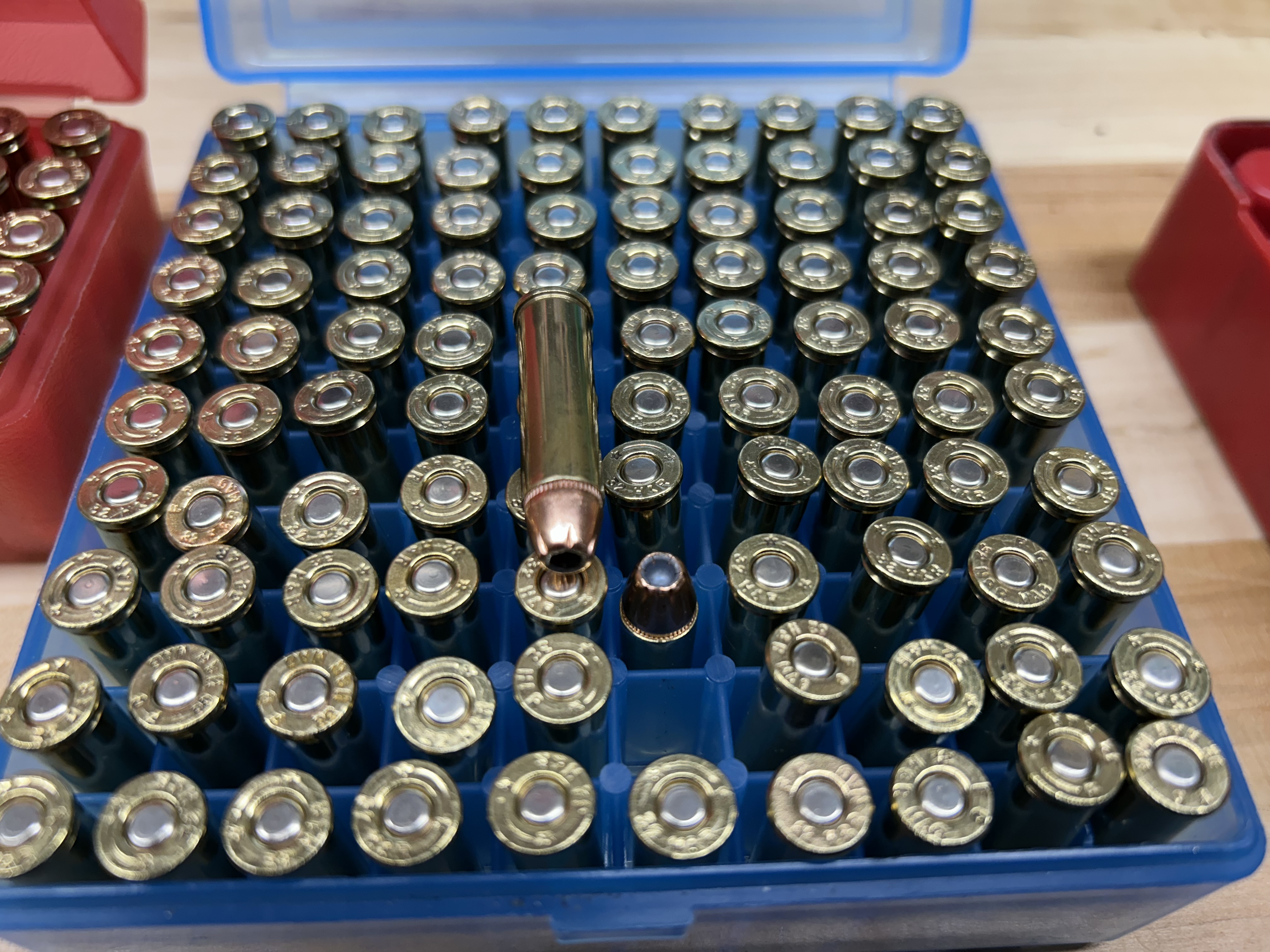

Yesterday I decapped and polished 118 32 H&R mag cases. Next up is to add some powder, primer and bullet and magically turn them into cartridges. :lol: I’m using the Hornady 85 gr XTP over 5.3 of Bluedot and a standard CCI primer. Makes for a nice soft shooting load for my SP101. Watch out bowling ping, I’m gunning for you.

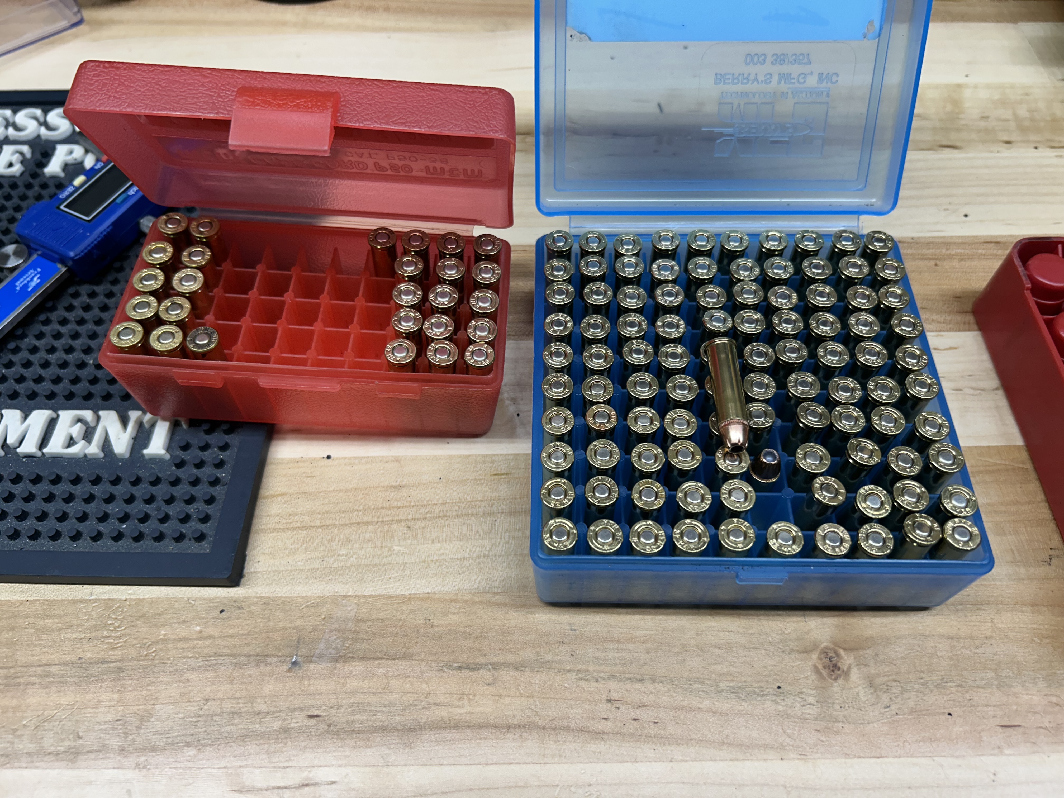

Yesterday I added primer, powder and bullets to the brass seen above and now I have an additional 116 32 H&R’s to shoot up this spring. Plus the 11 left overs from the last loading session for this caliber. Found two split cases which makes several from this lot of brass. I bought it used from a guy with a set of dies so I don’t know how many times it’s been loaded. It gets a very close inspection due to the number of split cases I have found.
Hornady 85 grain XTP over 5.3 of Bluedot and CCI standard sm pistol primer.

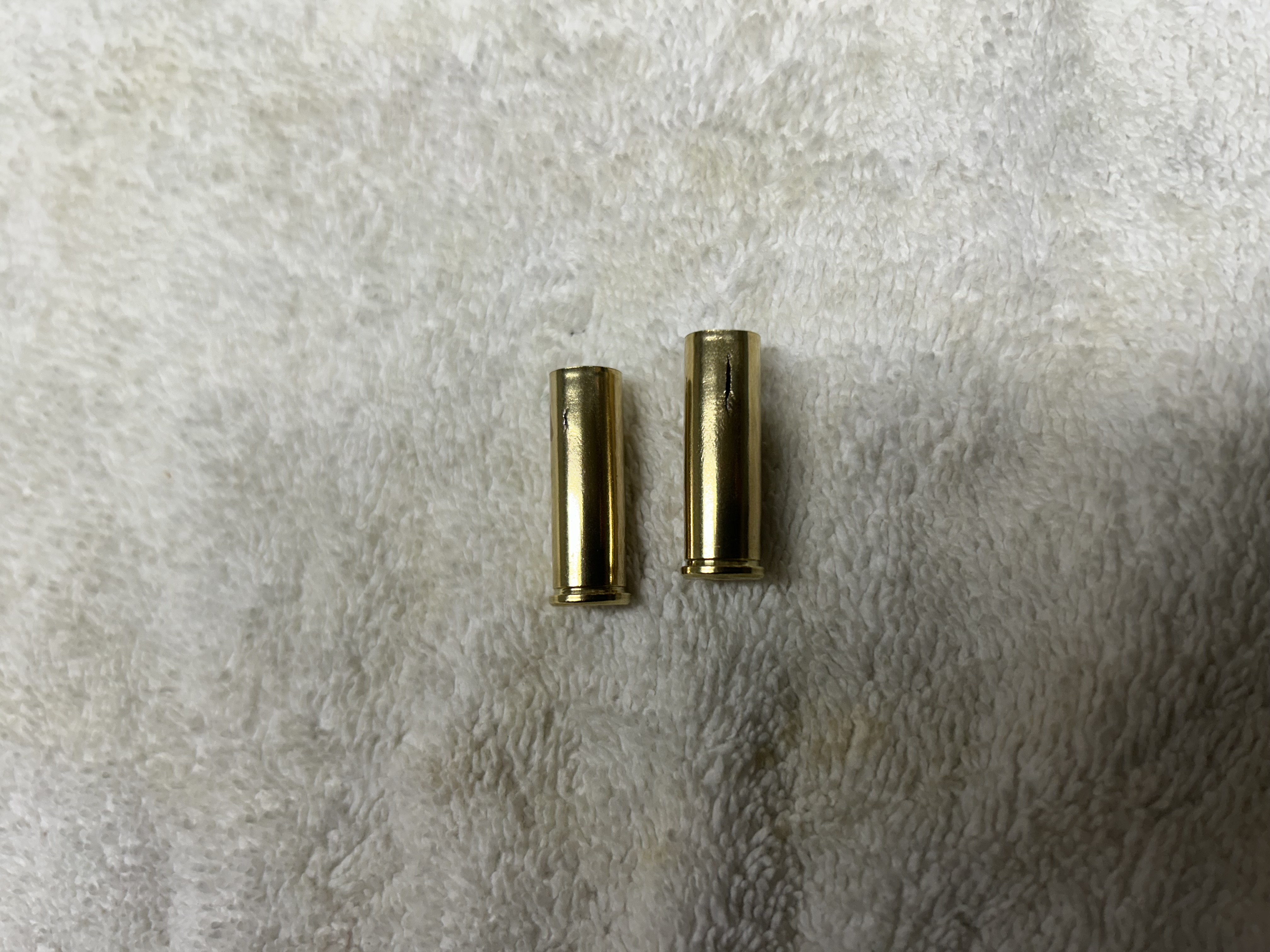

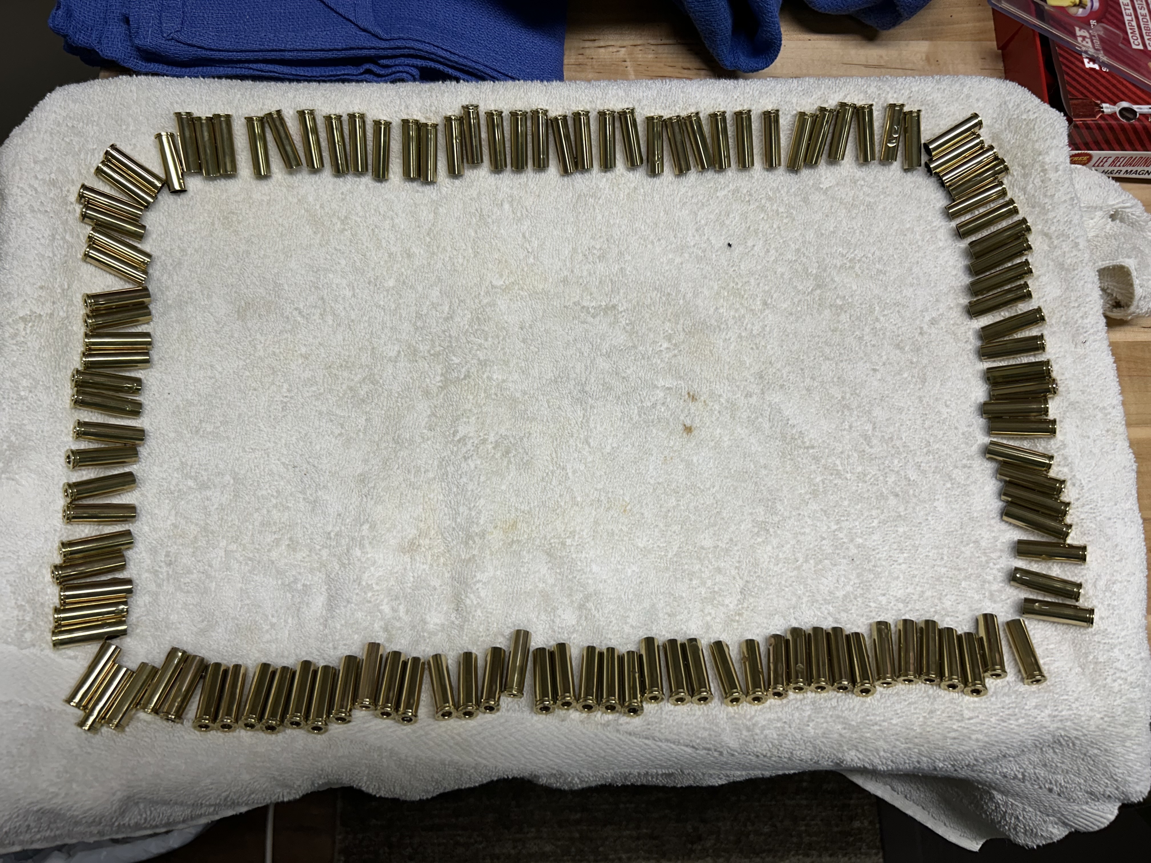

Well, yesterday before the son and grandson came by I had deprimed some 35 Rem., 38-55, and some 357 brass and had those in the tumbler.
After the son left I pulled the brass and rinsed it off and played it out to dry.
Loaded the 66 pieces of Win. nickel brass 357's with the 180gr PN over the usual 11.5 grs. of 2400.
I then got some other 38-55 brass out and ran them through the sizing and expanding dies.
Inspected for splits, found 3, then primed the other 72 pieces.
