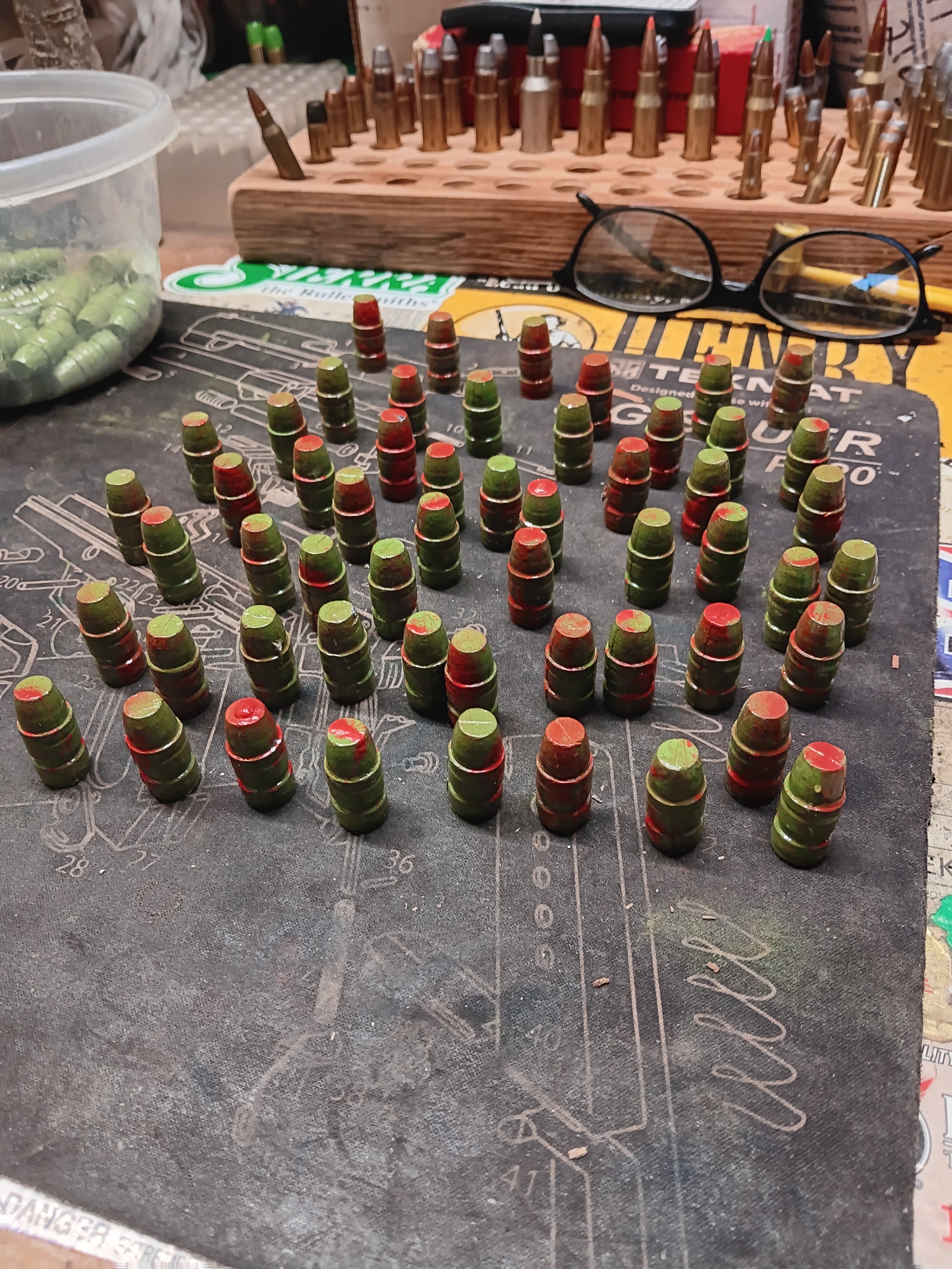

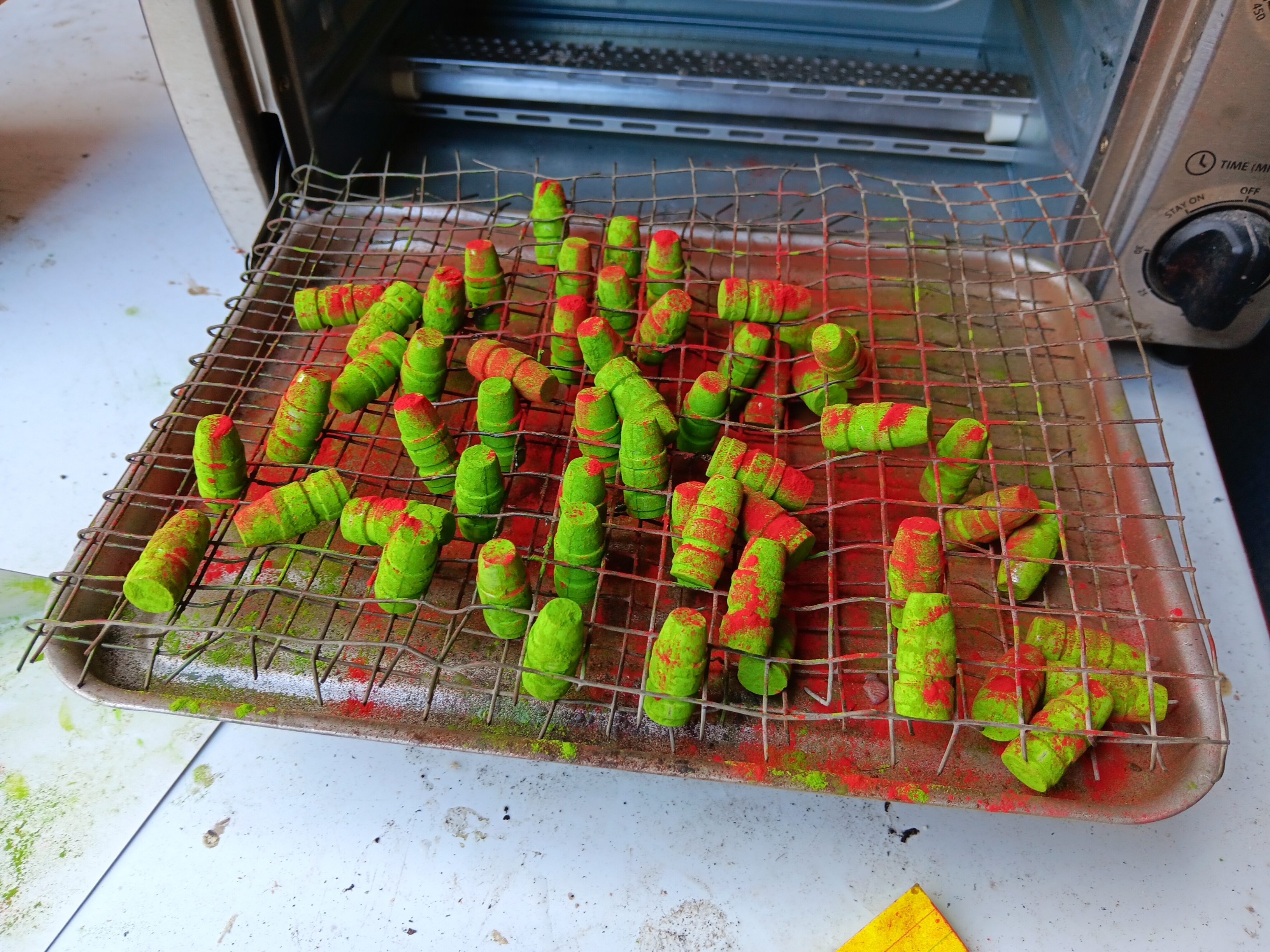

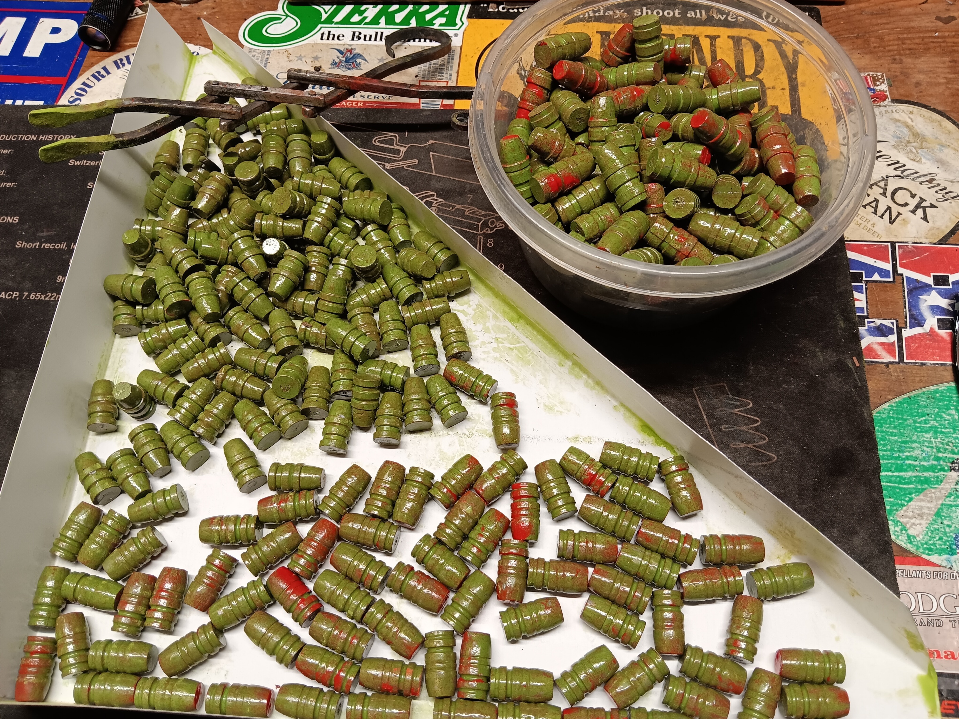

I did some powder coating this afternoon, I do the tumble method, I have a plastic one gallon container. Drop a 100 or so air-soft pellets in with a small amount of paint. I shake/swirl for a couple minutes to get the friction going then drop in a handful or so of bullets and do the same for another minute or so. Pour them on a pan and pick them up with some of hemostats, or as today these little tweezer things. Place them on the wire fence and place in oven for 20 minutes on 400°. Then pour out and do another batch.
Going in.
After they cool.
And the whole bunch.
