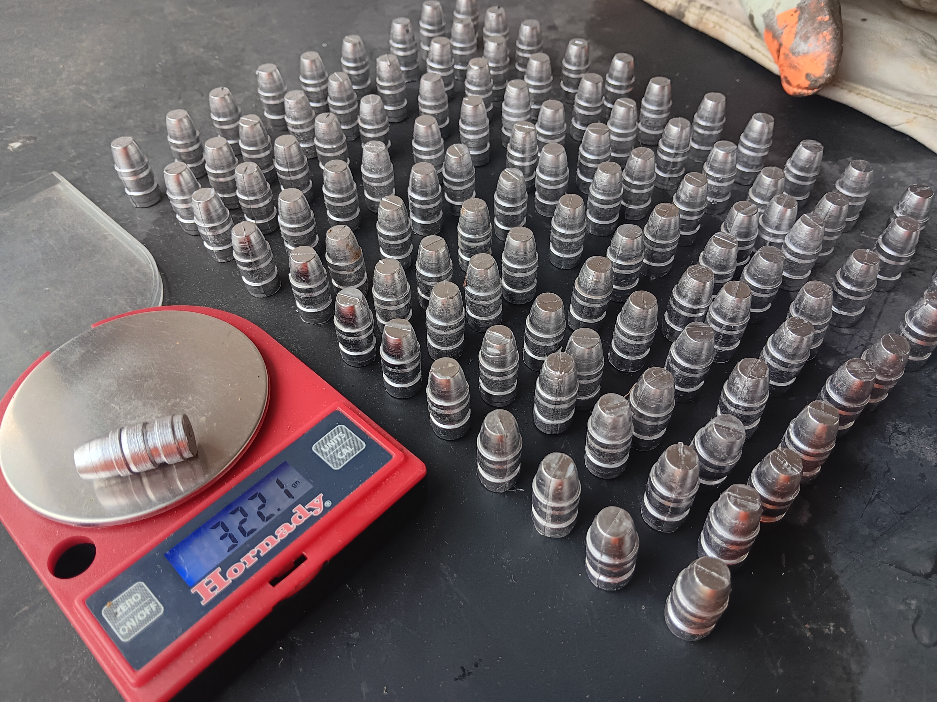

Then warmed up the pot and went looking for the handles to the mold, it was on the Accurate 41 mag mold and I hadn't put it properly so it took a bit for I got started. Between the delay looking around and then a neighbor stopping by, I did manage to get a 180 cast up before calling it quits.
This was about half way through the session, the lowest I found was 321.6 up to 325.1.
Posts: 12085
Post by Vaquero » Wed Feb 05, 2025 7:15 pm
I meant to say, this is the lead I got from the sil's grandfather back around Thanksgiving.
I bought 400 lbs. for $200, so say 322.5 as an average I get 21 per pound, or .024 cents a piece. :o :D :lol: 8-)
I can live with that.
