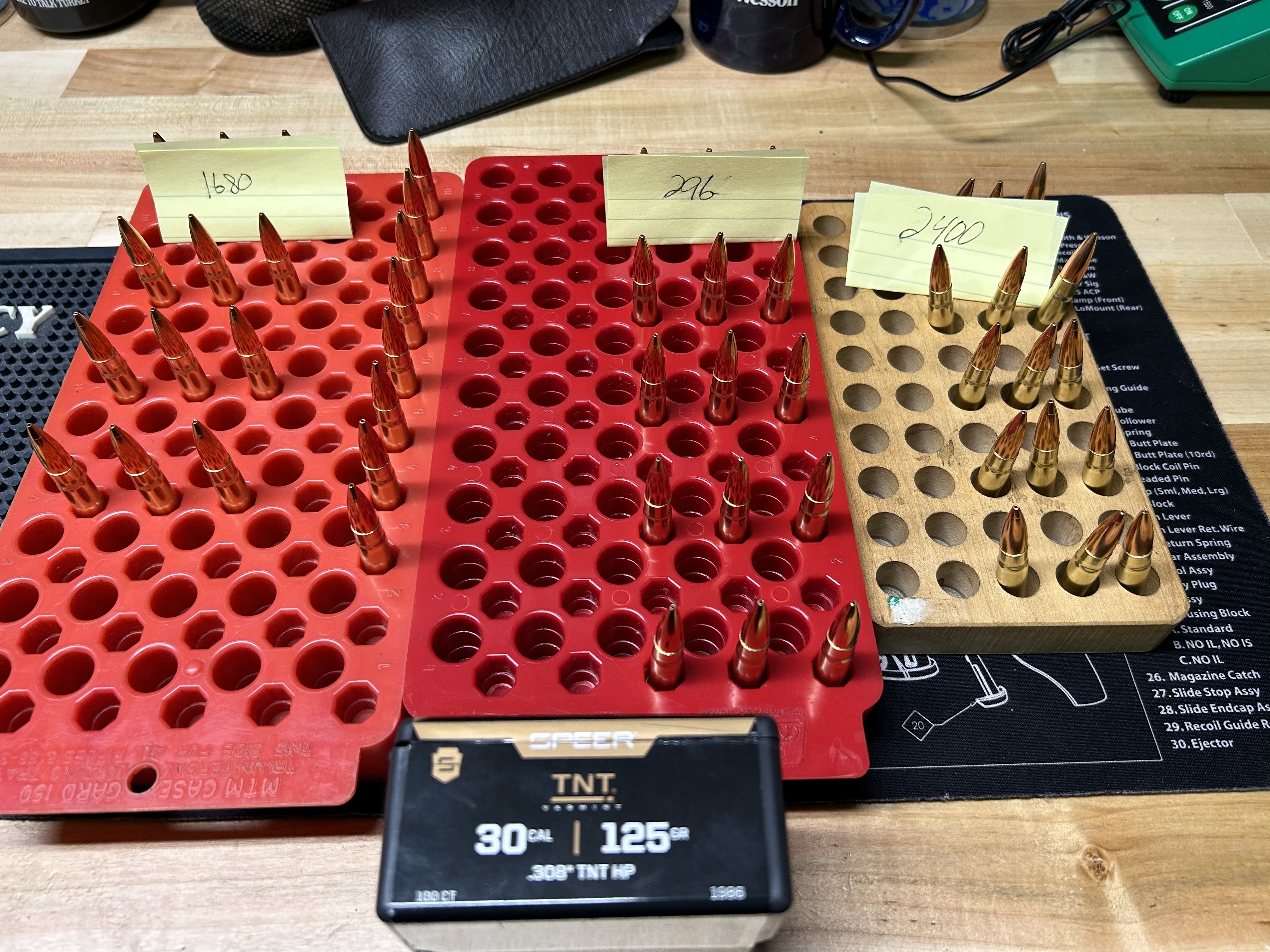

I found a box of the Speer .308 125 TNT-HP that BigAl suggested I try in my 300 Blackout. So yesterday I assembled quite a few using three different powders loading 3-4 loads of each. I’ll be grouping these Speer’s along with some Hornady’s I loaded earlier. Way overkill for what I plan with this rifle but hey, that’s part of the fun! :D
Post by BigAl52 » Wed Mar 15, 2023 12:12 pm
Looks good Hatch. I will be anxiously awaiting the results of those TNT bullets. How much 296?
Posts: 8056
Post by Hatchdog » Thu Mar 16, 2023 10:30 am
I started at 14.5 and went as far as 17.0. My Hornady manual shows 17.5 as max so I stayed just under that. Interesting that Sierra shows 19.0 as max and 16.2 as min. Big difference between the two. I’m using CCI 0041 primers which are considered a magnum primer and my COAL is 2.10 which seems to be the sweet spot according to many who have posted online. Plan is to hit the range tomorrow and give all a try.
Post by BigAl52 » Thu Mar 16, 2023 10:36 am
I found the same info with 296 as it was all over the board. I had better luck with no issues pushing it over the 17gr. I also read on line with several guys doing the same thing that running it over 17 was better accuracy. Im not sure where I was at as I am away as you know.
