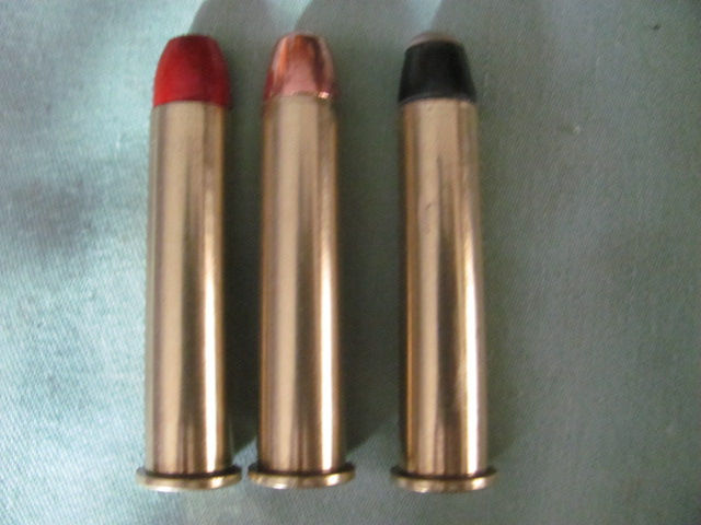

the time has come to get serious about developing hunting and practice loads for our 45-70 .... shown below are a total of 110 rounds that will be tested for grouping and run through a chronograph ....
the first picture shows the second generation of what I anticipate being our hunting ammo .... 20 rounds each of (left to right) 300, 400, and 500 gr ....
the 300 gr Nosler CT Ballistic Silvertips are loaded with 51.5 gr IMR4198
the 400 gr Barnes Busters are loaded with 42 gr of IMR4198
the 500 gr ACME are loaded with 30 gr of IMR4198 ... our original load for this bullet caused it to tumble .... I'm told that reducing the load may help .... we will see

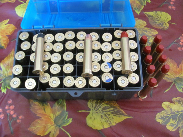

the second picture shows 10 rounds each of 5 different bullets .... left to right :
10 rounds HSM factory Cowboy Action loads
10 rounds HSM factor Bear/dangerous game loads
10 rounds Oregon Trail 350 gr loaded with 39.5 gr IMR4198
10 rounds Oregon Trail 350 gr loaded with 42 gr of IMR4198
10 rounds Oregon Trail 350 gr loaded with 44.0 gr of IMR4198
based on past experience, HSM factory ammo is the standard we have set for our handloads .... we will be delighted if we can develop loads that equal the HSM's in performance

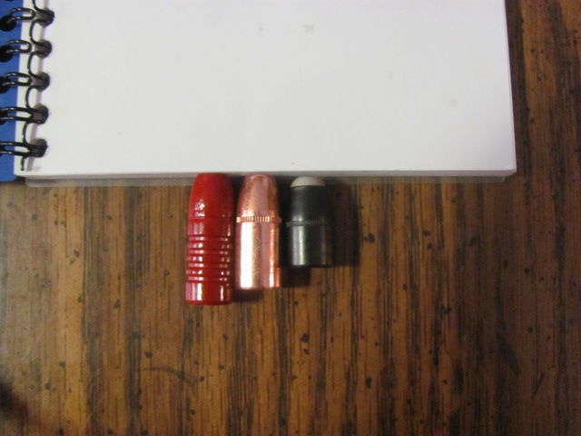

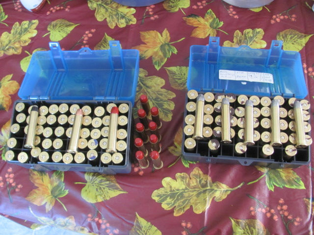

the third picture shows all 110 rounds

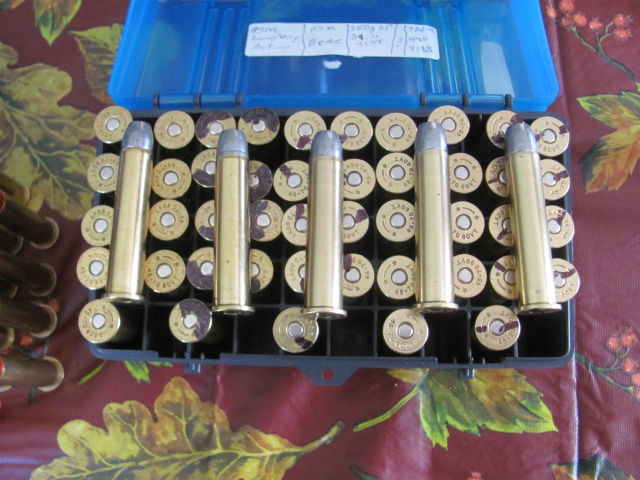

while the process continues, the goal for the project has changed .... as one who firmly believes you ought to practice with the ammo you will hunt with, changing come hard .... when it comes to using our 45-70, several realities have risen to the top of my list :
1. the chance that I will ever hunt any of Africa's Big 6 is nonexistent
2. the chance of me hunting any of North America's big bears is only slightly higher
3. the chance of me hunting any animal with our 45-70 is slim at best
additional nonhunting realities :
1. for me our 45-70 is a keeper .... my plan is to eventually pass it on down the line
2. my plan is to fire it at various ranges as often as possible ... mostly from a bench rest
3. the harsh recoil from dangerous game/full power hunting loads makes it unsuitable for spending a fun day firing a hundred or more rounds
4. the development of a low recoil, reasonably flat shooting 100 to 150 yard range load has become a necessity
decisions made :
1. my bullet will be a Nosler/Winchester Combined Technology 300 gr Ballistic Silvertip .... all other 400 & 500 gr bullets mentioned earlier in this thread will be put in storage .... who knows, one of our sons may one day need them
2. we will use IMR 4198 powder .... as background info, for 45-70 Government loads, Nosler recommends 47.5 gr (84% shell capacity) to 51.5 gr (91% shell capacity) for use with our Henry rifle
effort to date :
1. based on the theory that trapdoor loads should have low recoil, I loaded 6 rounds with 31.1 gr .... an instant observation showed an awfully lot of empty space in the casing .... major reduction in recoil, a bit more than our Henry 357 Mag and a bit less than our Henry 44 Mag .... Chrony readings were all over the place 1358, 979, 975, 1274, 930, 942 .... I believe the problem to be too much empty space in the casing .... load to inconsistent to to know how to adjust the scope
2. second trial .... still within trapdoor load range, loaded 7 rounds with 39 gr which still left a good bit of open space in the casing .... recoil on par with Henry 44 Mag full power loads .... Chrony readings were better but still too inconsistent 1575,1641, 1419, 1271,1568, 1367, 1343
3. third trial .... moved toward the top of trapdoor range since there was an improvement from first trial and second, I loaded 15 rounds with 44 gr .... I hope to be able to test them within a week or so
