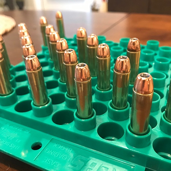

Post by Kissmybrass » Mon Aug 23, 2021 10:58 pm
Loaded up my very first .357 magnums for my brassie rifle :-)
158 grain Hornady XTP and Hodgdon HS-6 powder

Post by Vaquero » Tue Aug 24, 2021 8:53 am
KMB, those look more like an XTP's than FTX's.

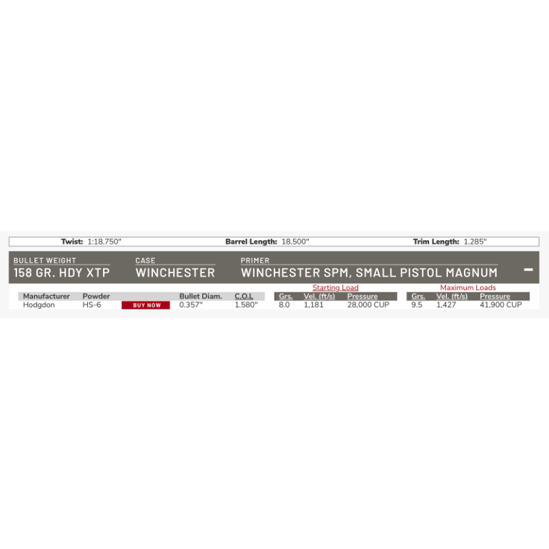

Post by Kissmybrass » Tue Aug 24, 2021 10:41 am
Tue Aug 24, 2021 10:33 am
158 grain Hornady FTX and Hodgdon HS-6 powder
How much HS-6 are you using under those?
I went on the high end of this since it's for the rifle. So 9.5

Post by Kissmybrass » Tue Aug 24, 2021 11:00 am
Your'e right, I edited. Mixed up with my 45-70 bulls
I will be interested to see how it shoots for you. I have a 7 or 8 lbs of HS-6 and have been using it in 40 S&W and 357. I came up with 9.2 grains for my loads under a Roze Dist. Zero bullet 158 gr HP.
