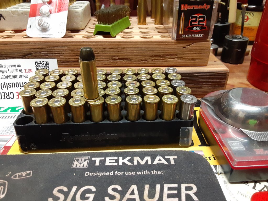

Post by Kissmybrass » Fri Jul 30, 2021 3:18 pm
Cleaning Hornady 45-70 brass for no particular reason since they are shorties.
I'm gonna have a ton of questions when attempting to reload with the rubber pointed FTX bullets (if even possible).

Post by Kissmybrass » Sun Aug 08, 2021 12:41 pm
Sat Aug 07, 2021 7:36 am
using 9.0 grs. of Unique with the 240 gr. MB Smasher
I hear and read a lot about Unique in a lot of different calibers, rifle and pistol. Seems you need 1/3 or even 1/4 of what you would usually use in other powders. So is that OK to have all of that air space in the cartridge? Do they ever misfire?

Posts: 3974
Post by Rifletom » Sun Aug 08, 2021 2:44 pm
D
I use Unique in .45 Colt, .45 auto and .38 spl. Works real well in those. But, in a .45-70 case, I'll let the guys here who load those give you the complete answer. That'a a good size case.

Posts: 14978
Post by BigAl52 » Sun Aug 08, 2021 4:46 pm
Unique will work in 45-70. I think I tried in the 13 to 14 range. The Lyman cast boolit handbook should have some info in it. I also used 16gr of Universal clays with some 300gr pills and had good luck with that load. Unique isnt position sensitive. You will find guys who use a sheet of tp in the case but its not necessary. I used nothing. Also you might check out https://www.shootersproshop.com/. These guys have the nosler 300gr on sale a factory seconds at times. https://www.shootersproshop.com/loading ... jax/1.html. JeBar uses the ballistic silver tip and I tried some also. They shoot real well.

Post by Kissmybrass » Sun Aug 08, 2021 5:09 pm
Thanks! and good to know — don't know if I'll find any any time soon but I'll grab some. Probably gonna reload my .357 brass one day. Sticking to one caliber for now :-)
