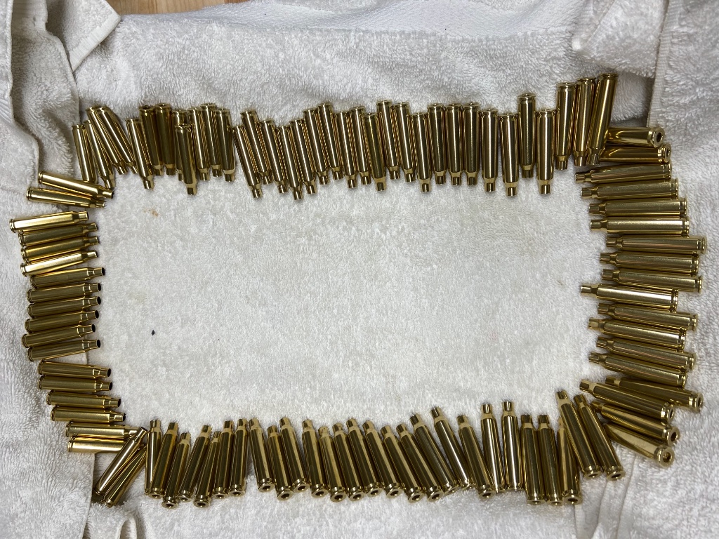

I found a RCBS Universal decapper for 22-25 calibers today, I have one for the larger calibers.
Brought home and set it up and deprimed somewhere between 500-600 223's.
I will start the cleaning tomorrow.

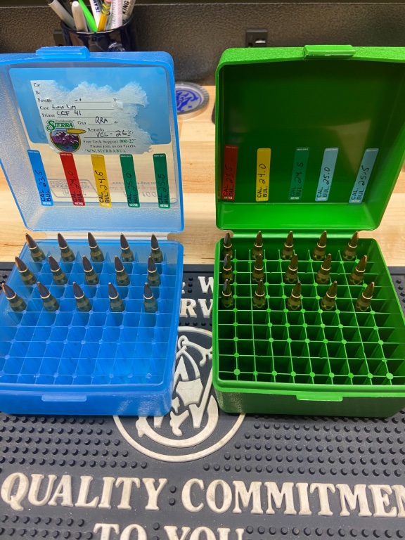

Well, cloudy a gloomy day here.
I loaded 50 of the 223's, do a little test.
25 were 25.5 grs of CFE223 and the other 25 were 25.0 grs of LVR with a 62 gr sp.
Will try in the AR first chance I get.

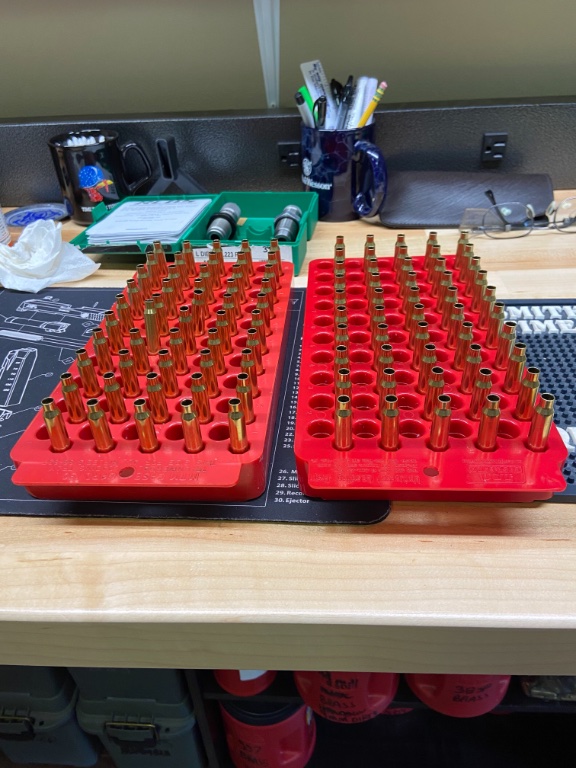

De-capped, polished, sized and trimmed 100 pieces of .223 brass. Tomorrow I’ll prime them all and load some to do some ladder testing using Varget and the Sierra .224 69gr Matchking bullet. This is for the Ruger Gunsite I picked up a few days ago. Also I have another 100 pieces sized and primed that I will be using the same components for a load in my Mini 14.
Got my laddered loads for the Mini and the Ruger Gunsite (both 5.56/223) done this morning. I’m heading to the range on Wed to shoot them for group then I’m ready to load up 100 of each. I usually like to shoot five shot groups but I’m conserving bullets. :(
