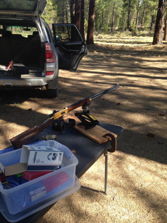

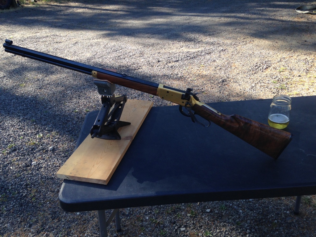

'Bench testing' a contraption I threw together today. A small car scissor jack, a hard rubber 'V' block for a boat trailer and all mounted to a board which I can clamp to the table and I have a 'prototype' adjustable rifle rest! It actually works quite well - at least just testing it for sighting and positioning anyway.
I cut a piece of thick leather and glued it in the 'V' block and slathered it with neatsfoot oil to soften it to protect stocks.

Yea the hardest part was figuring out how to secure the V block to the jack.
Well since it has a 1/2" hole for a bolt I cut a short section of 1/2" aluminum round stock the width of the block, drilled a 1/4" hole through the center of it and pressed it into the hole.
I then cut a hole in the block at the bottom of 'V' and pressed a 1/4" bolt through it and the hole in the rod.
With a flat washer on the underside and a nut on the bolt I tightened it and the aluminum rod was pulled down and secured the block.
The bolt head was pulled down below the V groove and out of sight so no interference!

nice use of a stabilizer .... well designed and built .... I can't see the other end of the adjustment screw but as I'm sure you know, depending on its design, a small variable speed drill with a 3/4" socket or heavy Allen wrench could provide you with quick height adjustment
Mistered
Re: Project Rifle Rest
Post by Mistered » Mon Sep 02, 2019 11:05 am
Its a large tab actually with a hole in it for the original crank handle.
Easy to spin up or down by hand but if this all works and I continue to use it I may bend a piece if 1/4' round stock into a small crank handle and weld it on.
I might replace the rubber V block with a shaped hardwood block - again that is if this works out which I should know today!

10-4 on the "hole in it for the original crank handle" .... I've found that an Allen wrench (about a 1/4") with the long end inserted in a drill chuck works well .... having something like that could sure collapse jack when packing it for travl

I'm kinda interested in what's in that jar! Hmmm....
Ojaileveraction
Post by Ojaileveraction » Mon Sep 02, 2019 2:40 pm
I bet neatsfoot oil.
Nothing special - just Miller beer!
However I'll have to call my rest a success!
