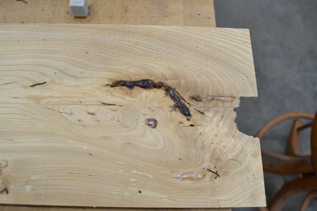

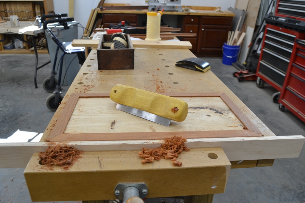

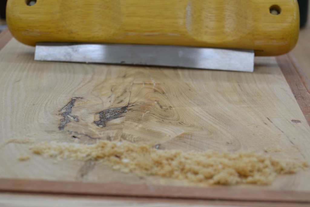

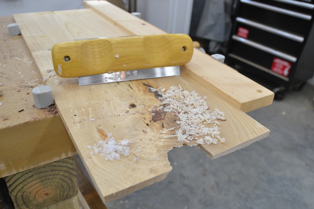

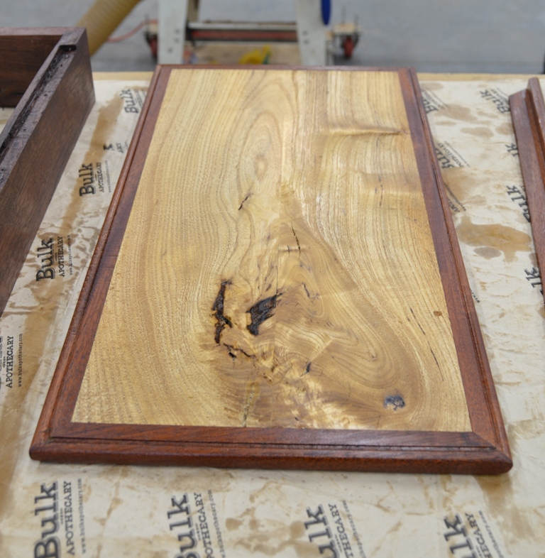

Here are the repairs around the Figured area... and the knot. Note they are very Proud right now. (sticking well above the surface.) I could use the sander to level them, but that would / could damage the surrounding surfaces. A card scraper is much easier to control, and MUCH cheaper than sandpaper. :lol:

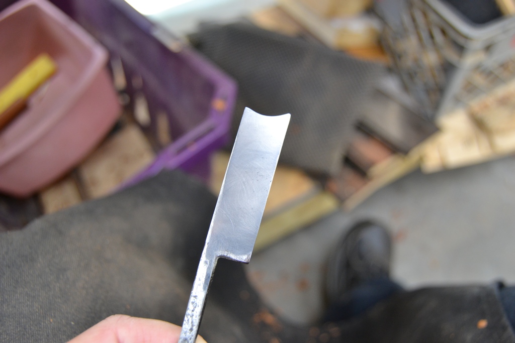

Working with the card scraper I took all the repairs down flush, then carefully inspected, trimmed a couple areas with the exacto-knife and retreated, then smoothed again with the scraper. It literally shaves away the glue layer by layer until we are flush.

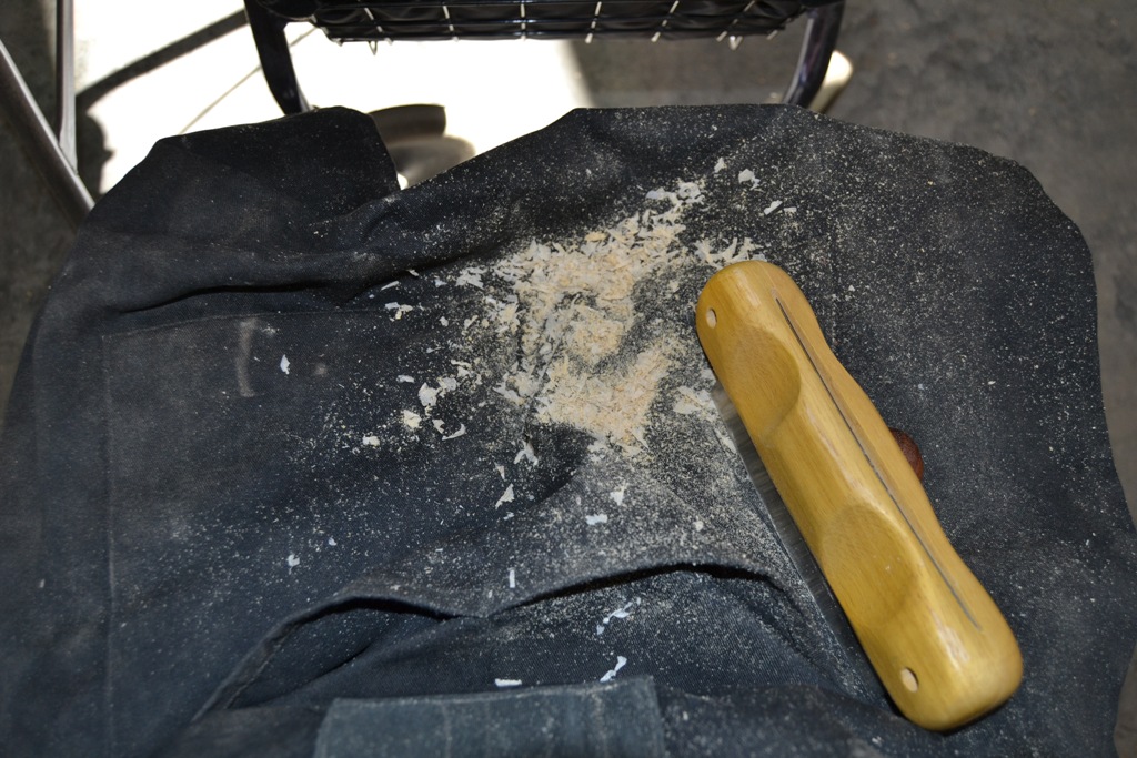

When using the scrapers, you can pull toward you, or push away. Looking at the lap of my apron, want to guess if I prefer the push or pull method for best control in MY case?

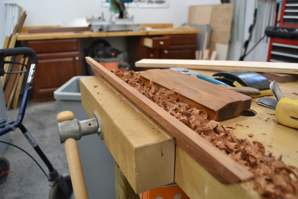

Now that the Tumbler project is behind me, I can concentrate on the box. :) I got in two sessions today, and really made a bit of progress. First, I went out to the woodshed and brought back some Mahogany that used to be table trim at a Florida Golf Course, a gift from dad. I had pre-processed this somewhat, removing it from the MDF felt covered centers and throwing away the centers. :P

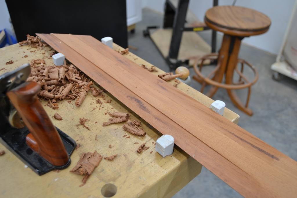

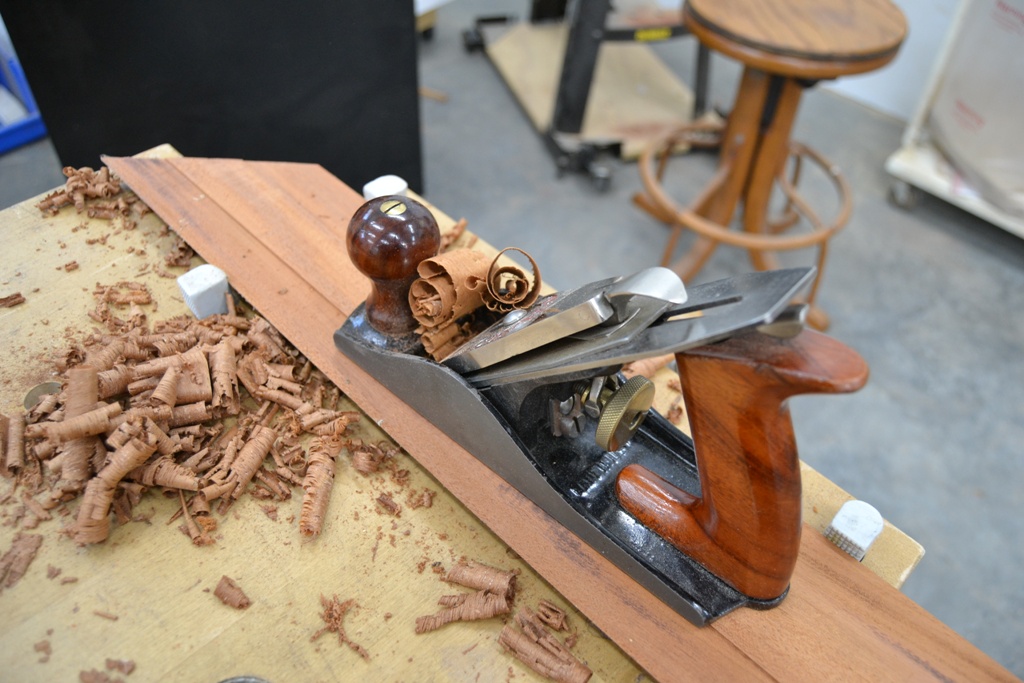

I had bookmatched these on the tablesaw, and there were some flaws on the bottom side, so I needed to address those.

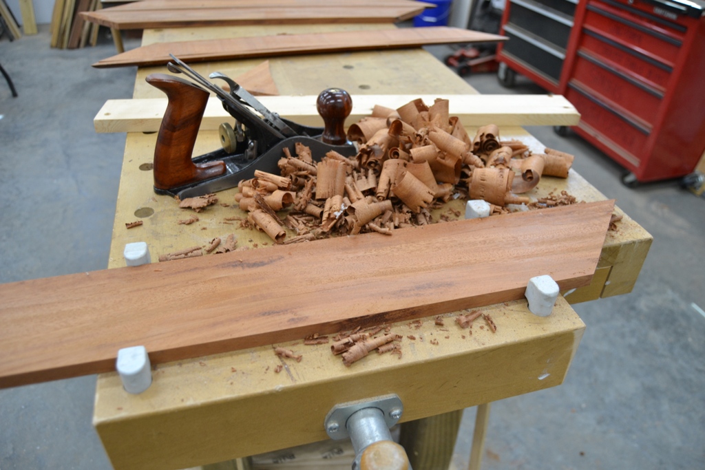

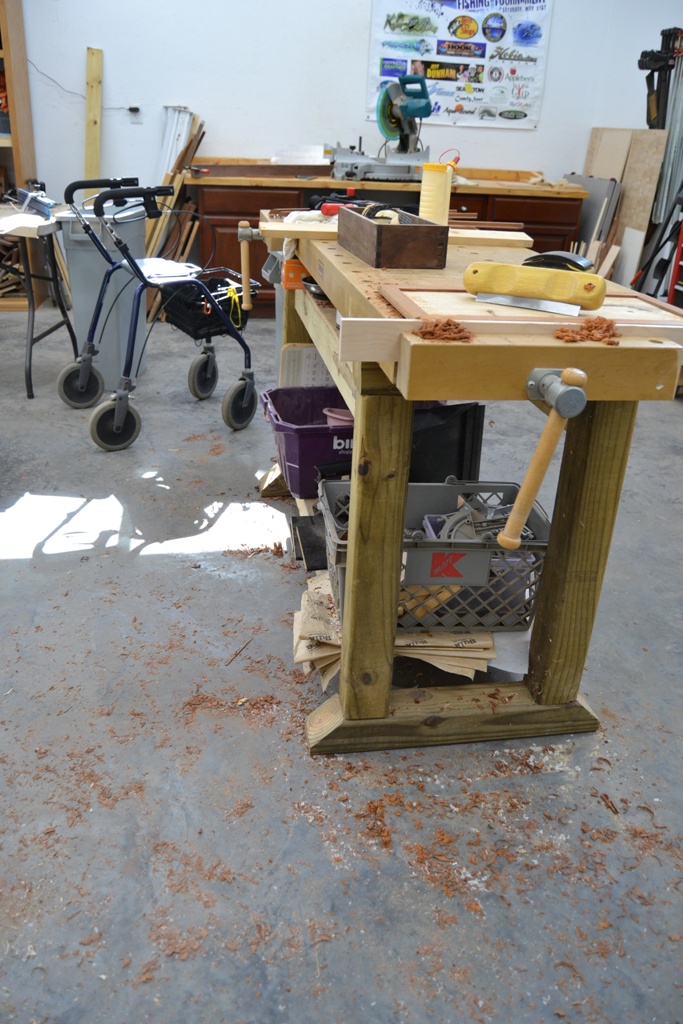

I clamped each of the sections to the benchtop and worked them with one of my planes. The plane did a great job of taking care of the issues, but it was a job... ;) Not that I minded. Beats the noise of the power planer, and lots less dust. Just the whisk of the plane and the shavings...

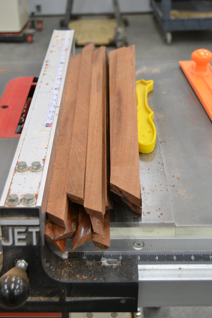

Next came a few setups on the table saw for the mahogany. Each piece was run over the first time to cut the bottom trim for the box. Then a new setup, and another pass to cut a piece to make the frame for the top. Once that was done, I had stacks of mahogany that I'll set aside until I am ready to address it again.

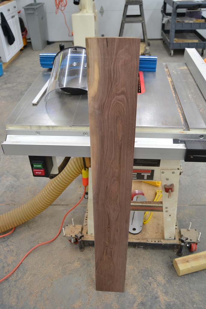

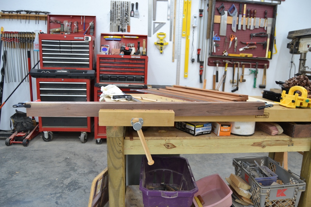

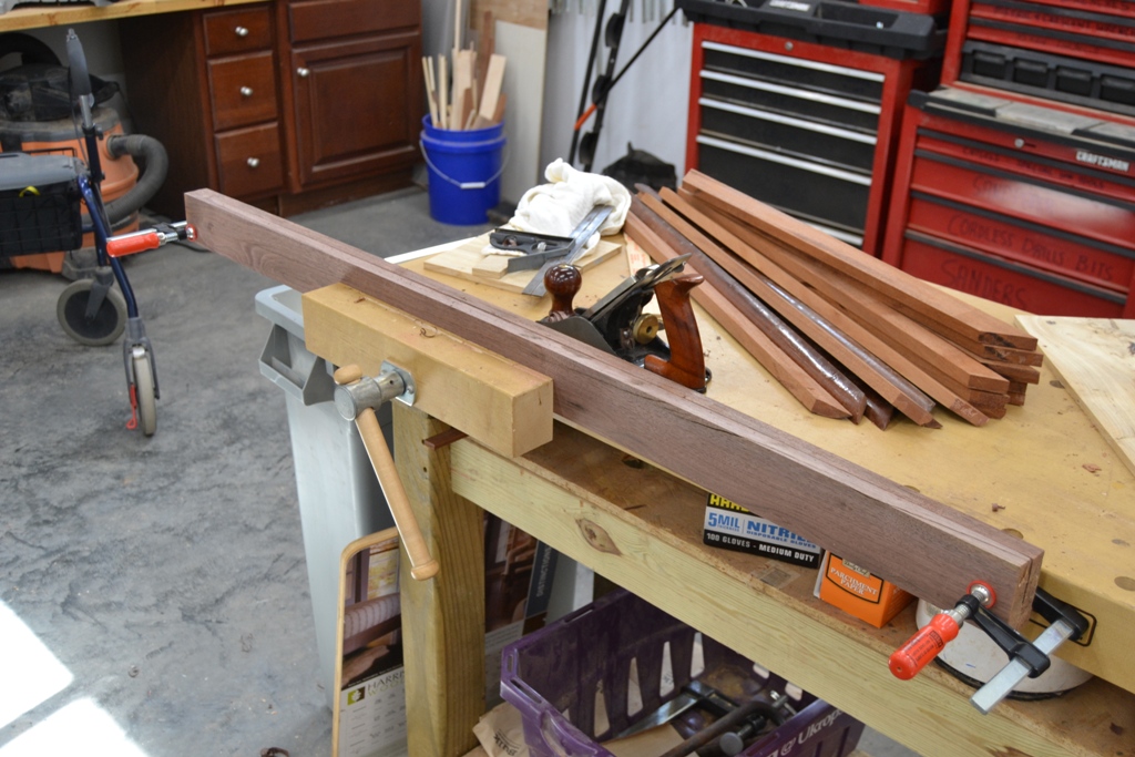

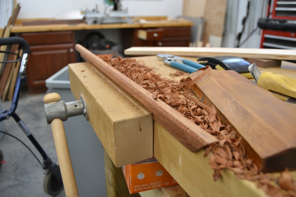

Next I turned to the walnut board for the sides. This I had prepped earlier in the process, planing and truing the edges, but now came time to cut it into two pieces so I could later cut it into the four sides.
I made two passes, cutting two equal pieces. Still some flaws since this started as walnut with BARK on the edges. :roll: I matched the two pieces together and clamped them tight so they couldn't move, then clamped them in the long bench vise... more plane work to true the edges. If I start the actual build with a quality base, the results turn out much better. Lessons learned the hard way. :oops:

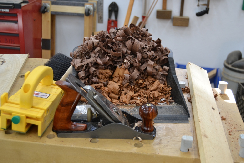

After planing both sides, I ended up with a nice collection of both mahogany and walnut shavings for the wife. She uses them in her wicker gift baskets as fill in the bottoms, then puts her wrapped soaps and lotions on top. Makes a nice display. :)
The walnut turned out nice and smooth in the end.....
This is where I stopped for the day.

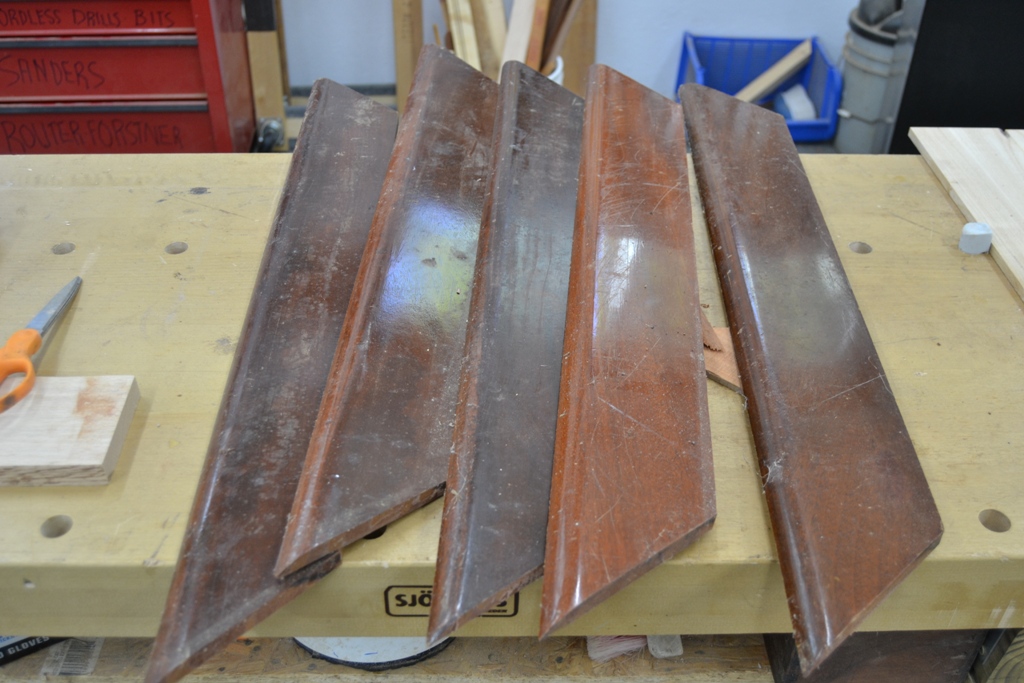

That reclaimed mahogany is really some nice-looking wood. Over the years whenever driving through residential streets, I thought it was a shame how often I saw good wood put out on trash-collection days. My Dad was an ardent wood cutter and shaper of wood. He loved wood and everything carpentry. He intensely disliked seeing wood thrown away. He was always stopping and helping the trash collectors and relieving their pickup loads along his neighborhood streets! :lol: One of our last projects together was building over-the-head wood storage shelves in my garage out of those "collections." All of that wood served a good purpose.
Great work on finally using the former mahogany table trim, Marine!
And your "shavings stack" looks really cool. Wonderful and colorful use for your wife's gift baskets. :)

Post by BrokenolMarine » Fri Oct 06, 2017 9:20 pm
Thanks PT,
I have used several pieces of the mahogany already as trim...
I try and use it for special boxes.

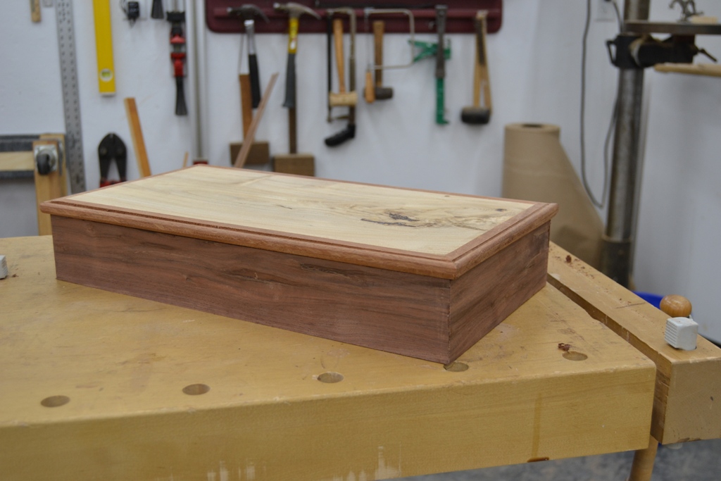

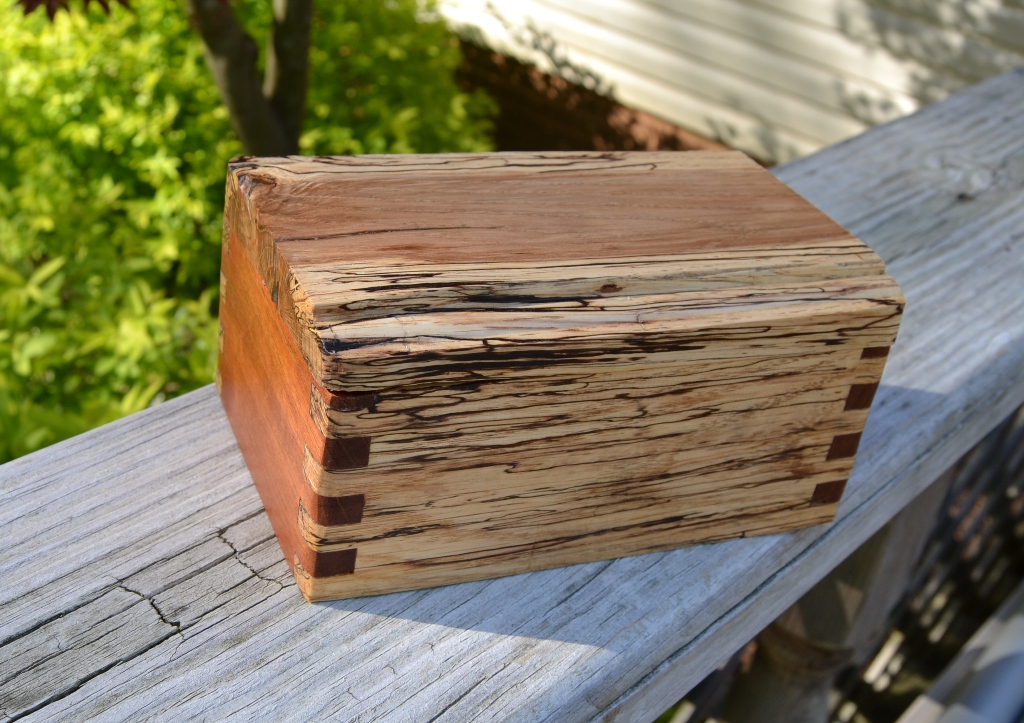

For example, in this first box, I finger jointed spalted maple and mahogany and came up with this little box.
This next example involves a spalted maple box with the burled maple top, and the mahogany used as trim for the top and bottom. I used a plow plane and antique forming planes to shape the details on the top trim. It was a learning experience. :)
THE box is done.jpg (282.86 KiB) Viewed 1673 times

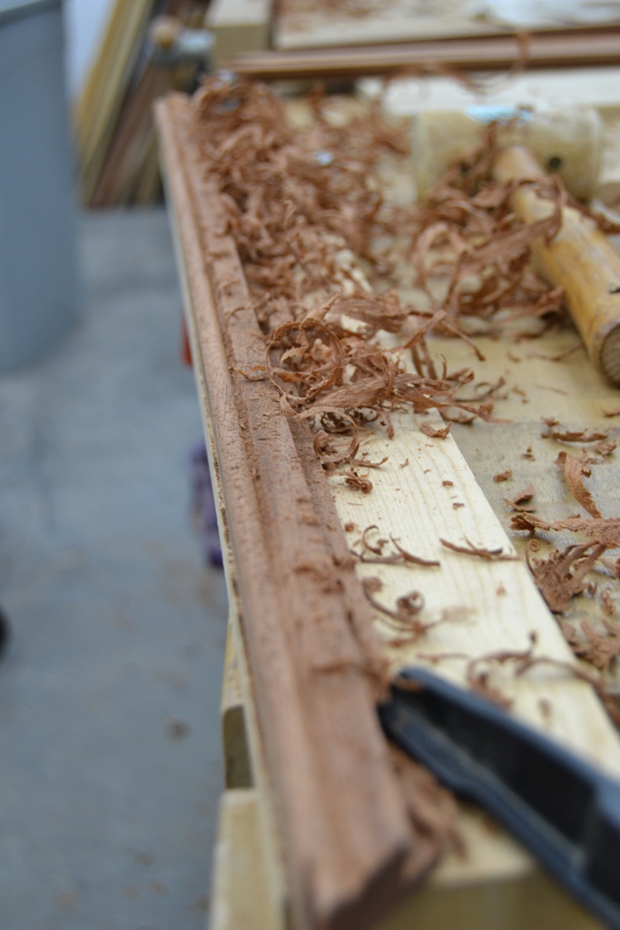

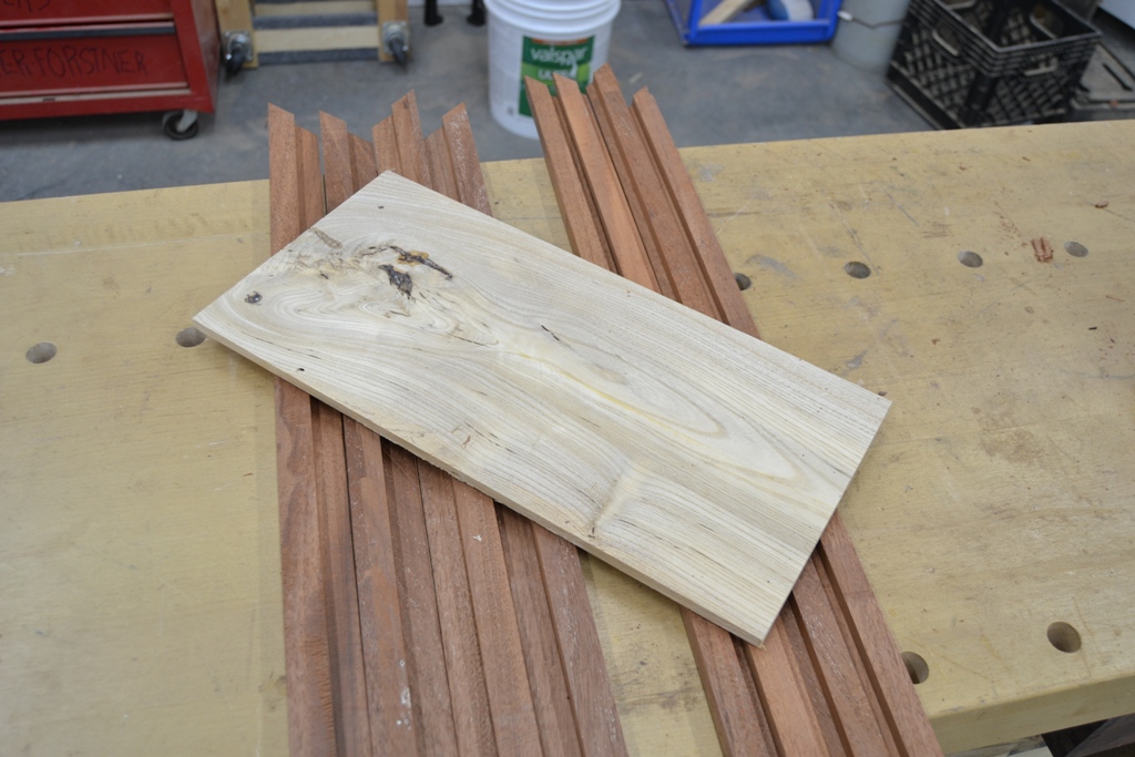

Got out in the shop twice today, working with the mahogany. I had cut the dadoes yesterday, narrow ones in the top for the inlay of the panel, (on the right) and wider ones in the bottom mahogany for the sides and bottom to nest in. (on your left)
Here is a peek at the top panel cut to size and with the holes filled and worked over with a card file. It's nearly ready for finish, just a bit of final sanding with 220 and 400 grit paper when it's been fitted to the frame and ready.

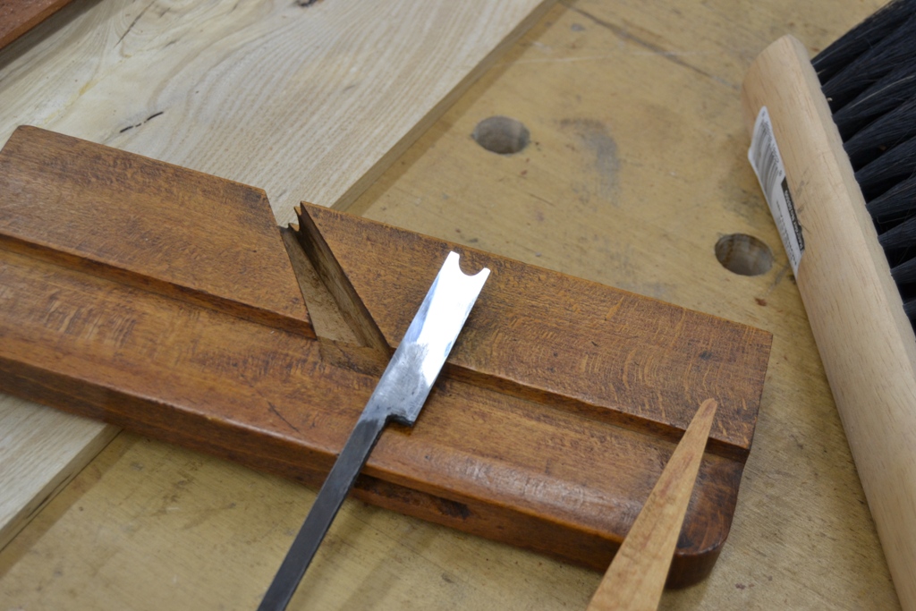

This morning and afternoon, I worked on the layout plans. First step in using molding planes is to decide which one. I have about a dozen old planes, and after deciding, I had to sharpen the antique irons. The safest way to do that, is to just flatten and true the back of the iron. Get that flat and true and you end up with a sharp edge.
Once the plane is ready, you make multiple passes, engaging the plane more and more on each pass. With this plane, you turn the beading edge just enough to engage on the first few passes, then dig it in more as the beading edge digs in. You "can" reverse direction and come from the other edge making a double beaded edge, however I choose NOT to do so on this top panel, preferring instead to roll the edge smoothly and blend.
I have also sharpened another plane for use on the bottom framing pieces. That is for a later post... I am done for the day. Well, unless I get excited and rush out after dinner and work in the shop for another couple hours. Hey, it's been known to happen. :P

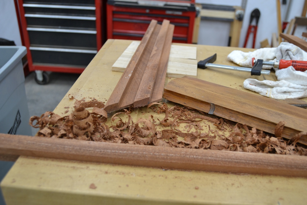

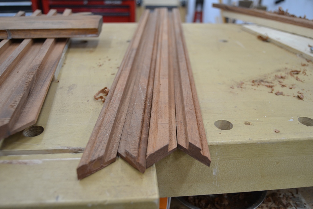

Got out this morning and worked on the box top, as well as the bottom trim.

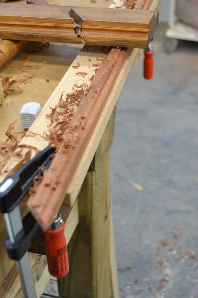

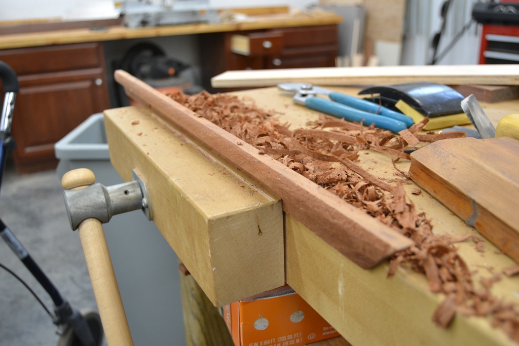

First up, used the second molding plane I had sharpened to shape the bottom trim, rolling the edge over to leave a graceful shape. You start by breaking the sharp corner with a light pressure, making increasing passes then rolling the plane more and more toward the lower edge until you have completed the profile. You'll finished off the molding with some sanding on Mahogany, as it has a tendency to pock.
Take another peek at the beaded profile cut by the other molding plane, quite a difference. :lol:

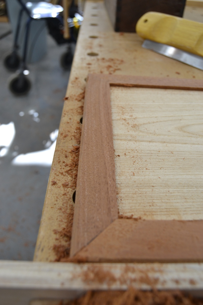

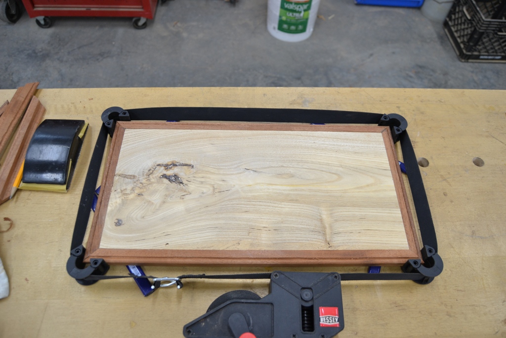

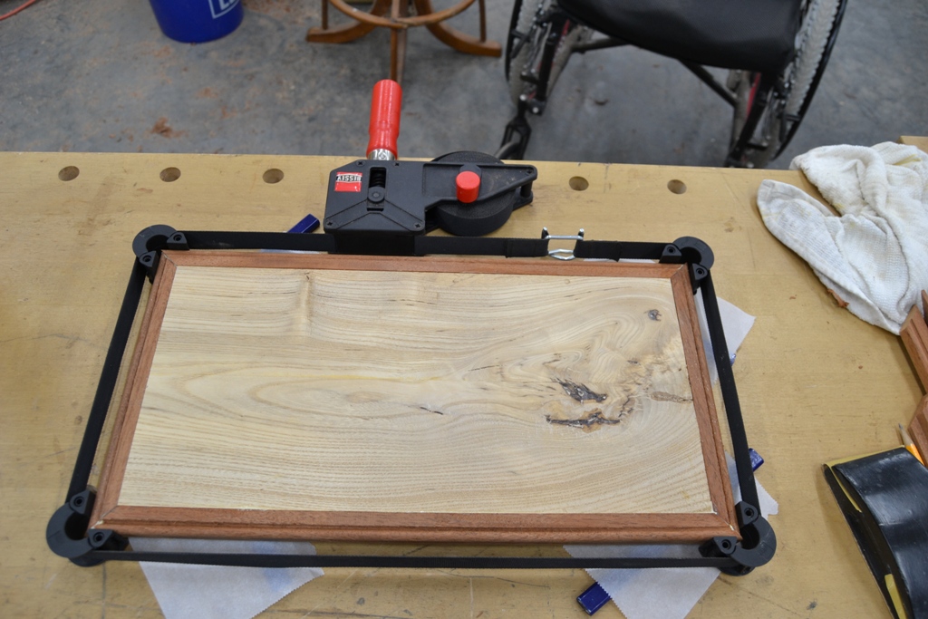

Back at it afterwards, I carefully measured and cut the frame for the top. Trim, and test fit, trim and test fit, finally adding some pressure. You only turn the crank handle to apply enough pressure to test fit.
Using the band clamp the first time revealed slight gaps caused by the two long sides and required a minute trim of both, the last pressure test was a perfect fit.
At that point you take apart the pieces, apply the glue and make sure each part is properly covered, apply the glue and then reapply the pressure to the band clamp, only this time, you turn the red screw crank as well, cranking until you get squeeze out. This will sit overnight to assure a good bond, and I can work on the sides and bottom. All will require sanding anyway. :lol:

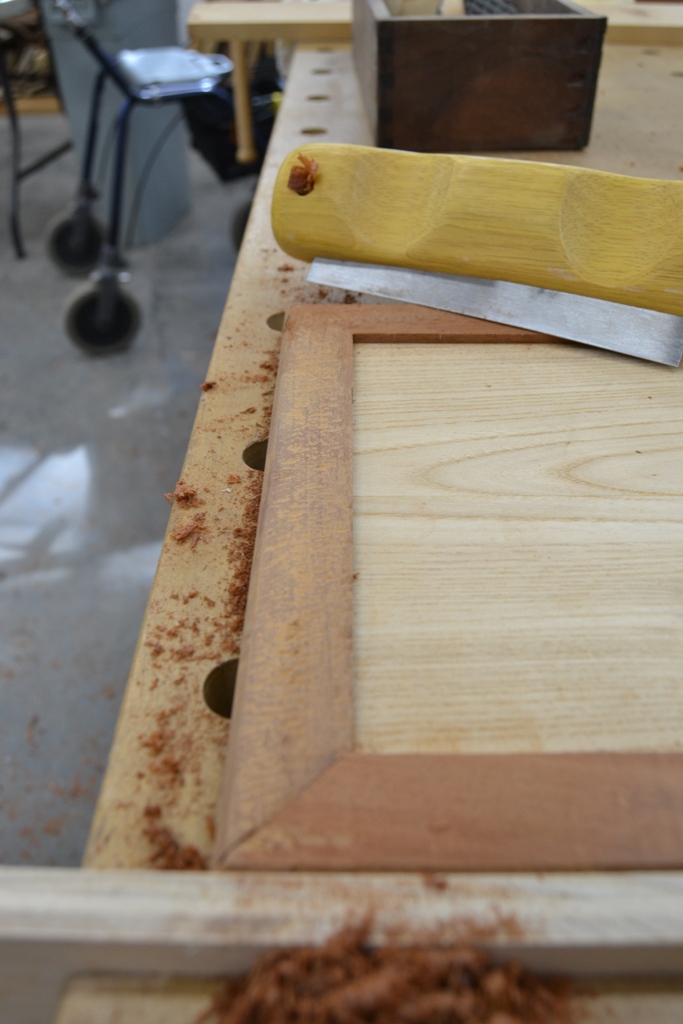

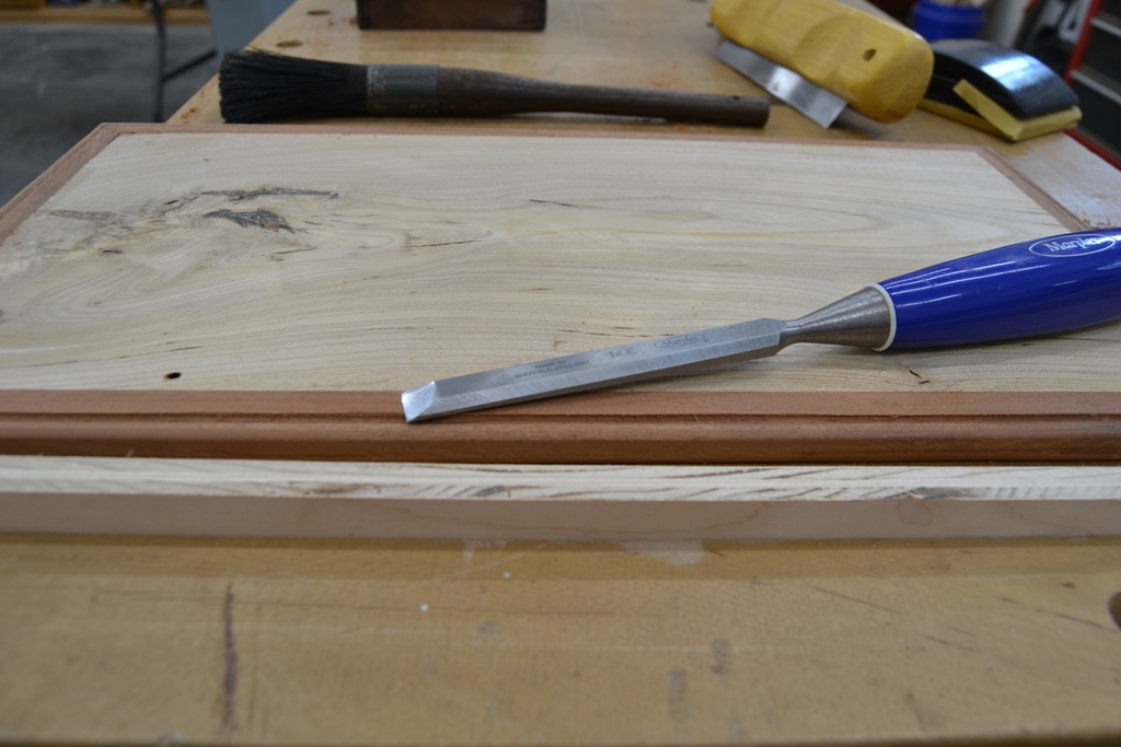

Back out to the shop and got back to work on the top. The underside was rather rough, after removing the shellac finish that was on the wood from it's time as a table top trim. Chemical strippers would have done a fine job, but ... I used a block plane, and stripped it in a couple passes. Time to smooth 'er out. :)
The old card scraper to the rescue. It will get quite a workout on this project, as will all my various planes. After a few minutes with the card scraper you can see the difference. Long way from complete, but....
You can see the nice shavings the scraper cuts in this view... faster and cleaner than sandpaper and leaves a pretty good finish behind for the time involved.

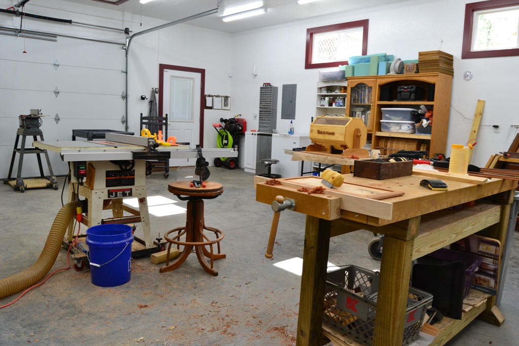

A long view shows I have been hard at work, the floor testifies to that. :lol:
Next up was fine adjustments to the beading, with a very sharp chisel. Fine work takes a fine hand and careful use... NO rushing here. Also, take a look about two inches to the left of the chisel blade. You see the hole in the oak insert? It goes all the way through... :? I took the time to gather dust and pack it, soak it in CT Hot Stuff Glue and spray it with accelerator to speed the curing process... and then sand and repack... until the hole was, fixed.
After that work was complete, I worked on the top of the top for a good while, bringing all four edges down to the level of the insert, and smoothing as much as I could. I'll save the 400 grit sanding until the entire box is complete and ready for final sanding. The repaired hole that went all the way through? It's at three o'clock in the picture below, slightly below and to the right of the scraper blade. :)

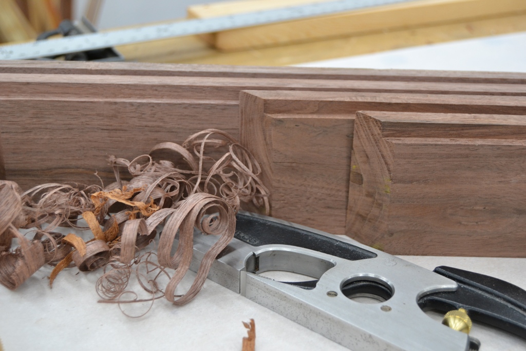

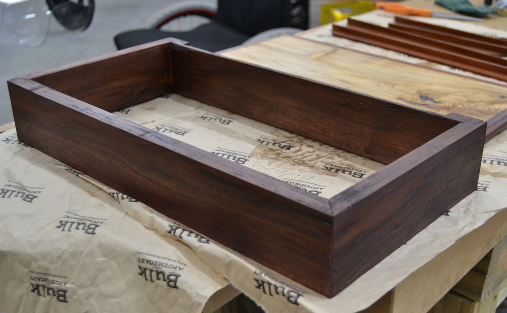

I measured out and cut the four sides, then a groove in the bottom of all four for the bottom panel. Both the side panels and the bottom will sit in the trim, unless I decide to just toss that. ;)

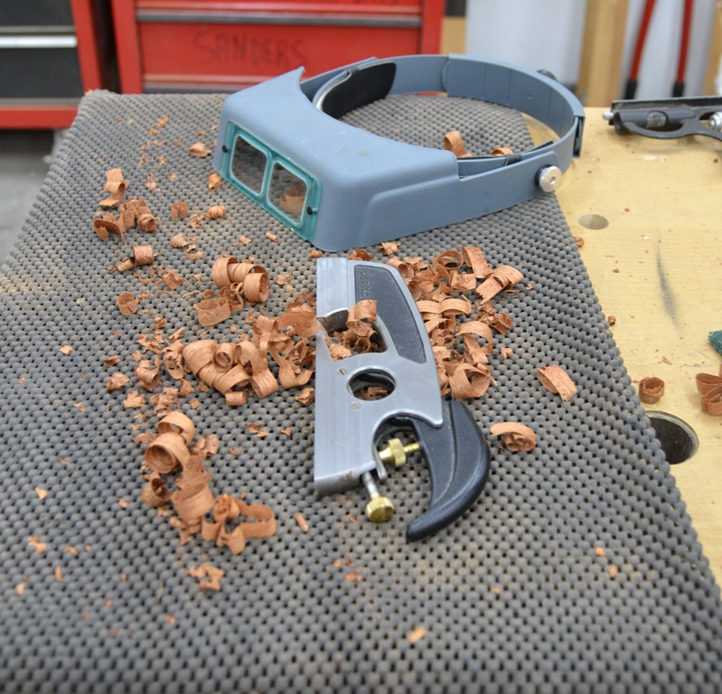

After I cut the groove with three passes on the table saw, I used a Veritas Shoulder Plane to flatten the bottom of the notch. My memory is terrible these days, but I think that type of notch is called a rabbit. :? The shoulder plane is a joy to use, especially after sharpening the iron. :P Every tool with an edge works better with the edge is sharp. :roll:

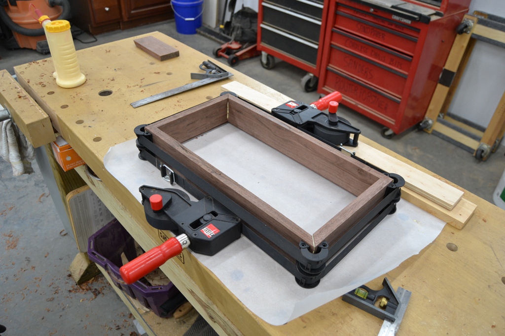

After checking the cuts, making sure I was ready, I applied the glue and attached the band clamps... two due to the width. I let the piece set up over night.

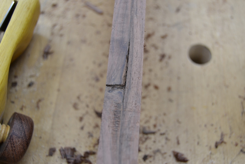

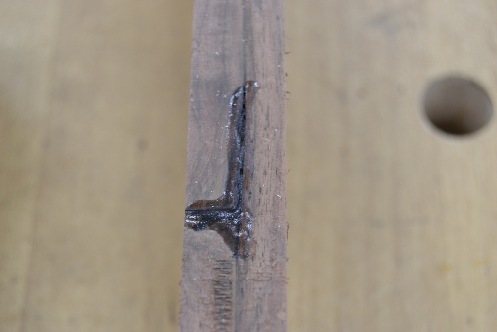

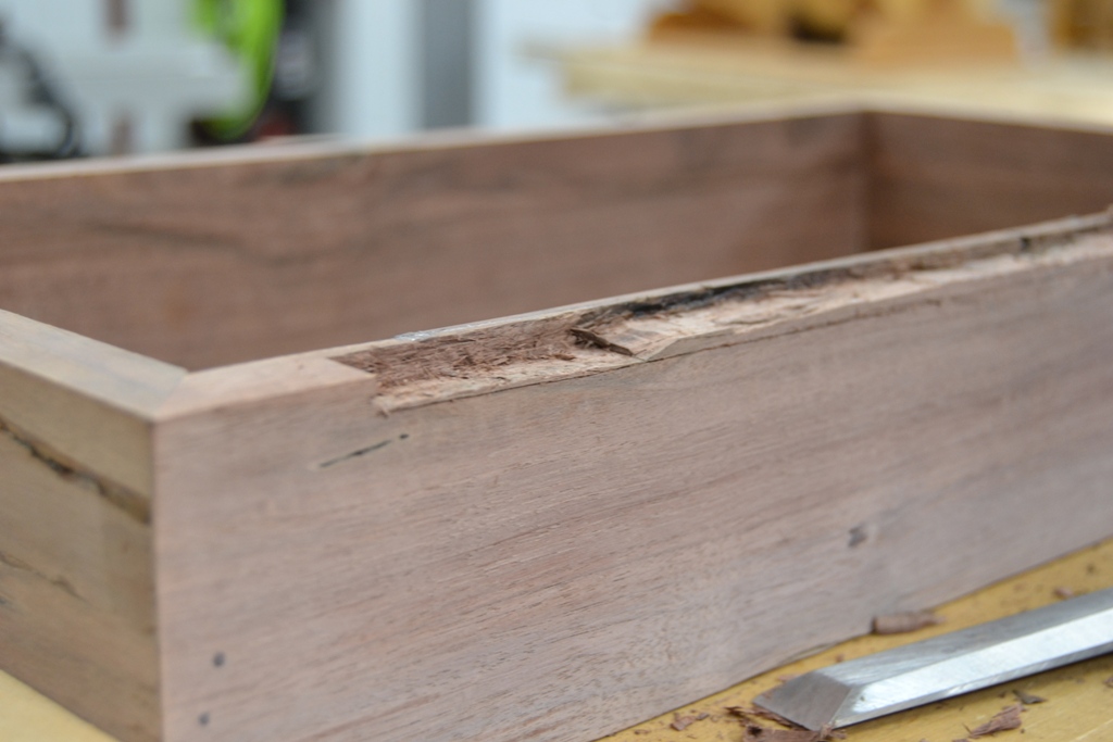

This morning, I removed the clamps and put them away. Time for cleanup. I used several tools to remove excess glue squeezeout, and used my plane to true up the top edges. Then on to the scraper on the edges and the sides. There was ONE defect in the top edge I wanted to address, it was a long deep crack.

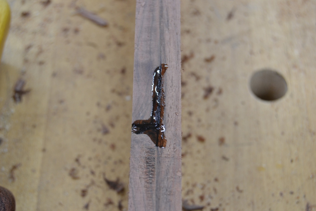

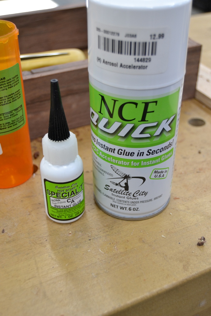

This calls once again for Hot Stuff CT to the rescue.
Apply a layer of CT
and then a spritz of the accelerator... and
I run the scraper over the area a couple times and check my progress, and then repeat the two steps until the area is flush and smooth. You can sometimes use fine sawdust mixed in to fill larger gaps. Not needed here, as the glue is clear and the black walnut makes the hole appear filled when the repair is completed.

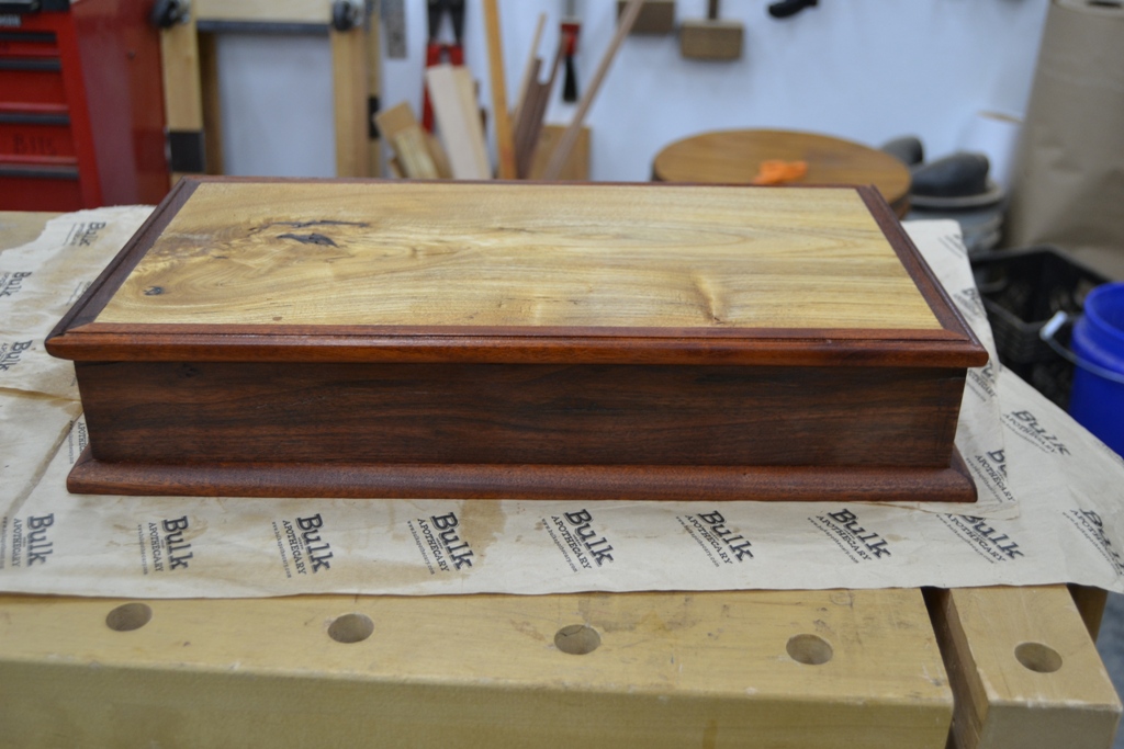

Placing the top of the "box" gives me a peek at the contrast... I think it will look pretty good when finished. I am thinking this will be a Man's Box, with a removable tray for rings and such that slides from side to side. Under the tray will be storage. we'll see how it goes.

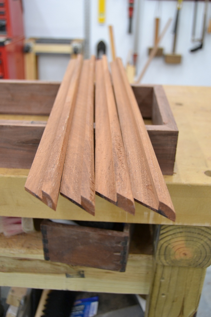

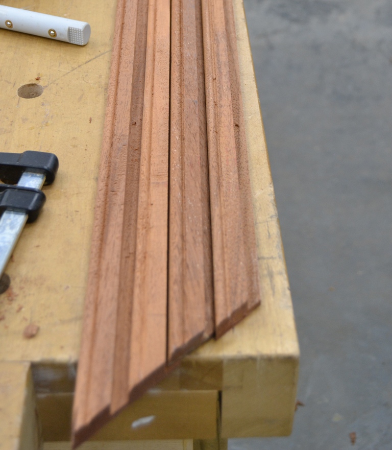

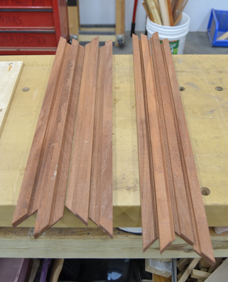

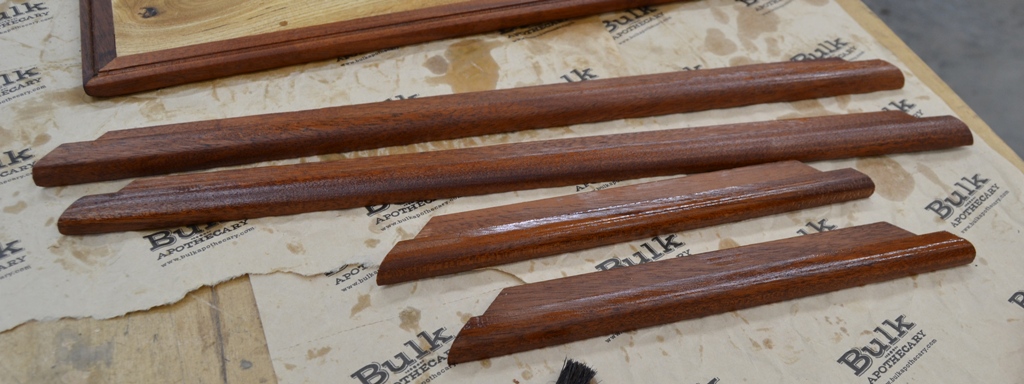

I decided to start on the bottom trim today, and I had been looking at it in comparison to the rest of the box, and had a feeling it would be too wide. I put it against the box and took a look and.. :cry: ... yup, I felt aesthetically, it was not in balance with the rest of the box.

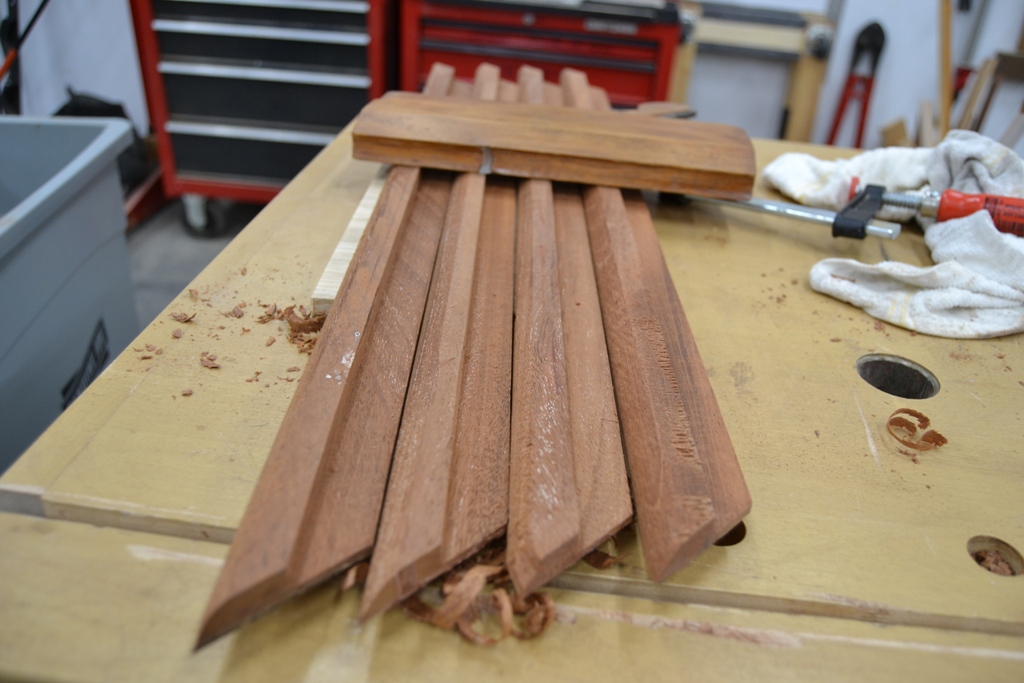

So, I took a few measurements and decided where I wanted to end up, set up the tablesaw and ripped down the length, trimming off the rolled edge.
I then re-rolled the edge with the same molding plane.
As I was rolling the edge, I felt the plane start to drag and the iron started to dig, time to resharpen the iron. A few passes on the medium diamond stone, the 1000 grit and 4000 grit water stone, and the leather strop, and we were back in business.
A good morning's work produced four new pieces of bottom trim
And a quick check showed they would be more in balance with the rest of the project.

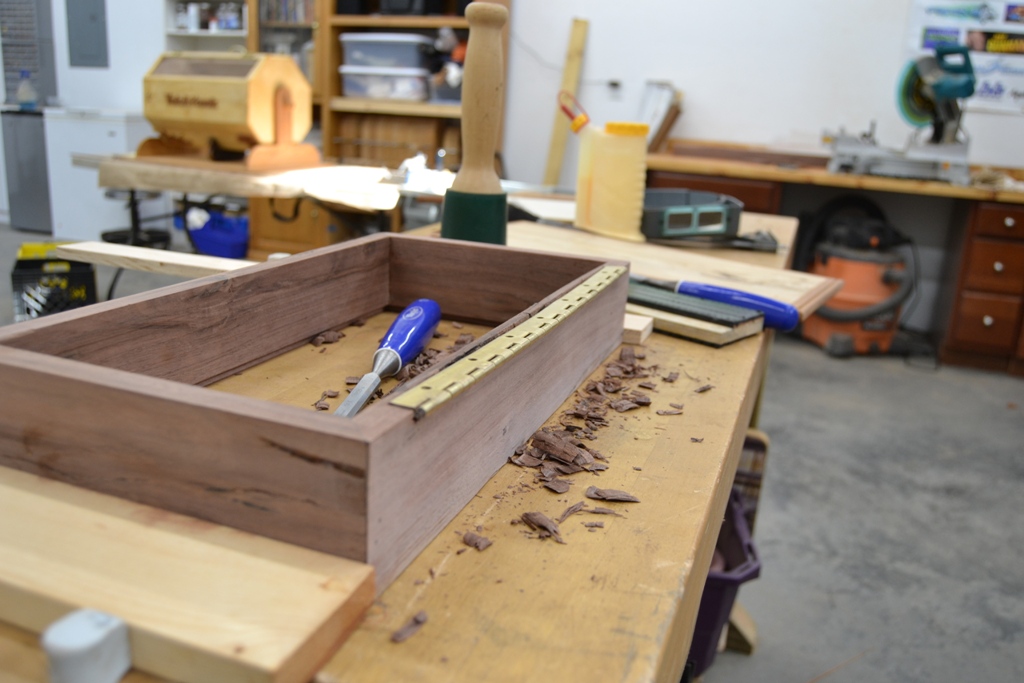

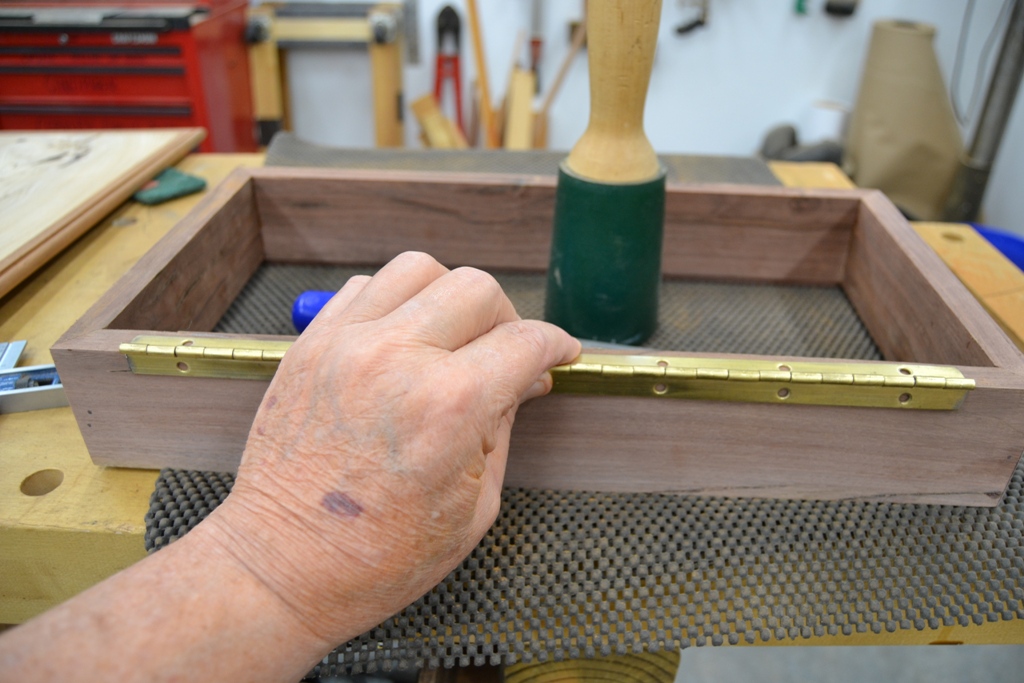

This morning? I figured it was about time to add the hinge, getting close to time for the finishes... so may as well. I could pull out one of the routers, but... :roll: Noisey, messy, and one slip and with all those RPMs they do a lot of damage in a fraction of a second. :o
More importantly, I had promised myself I would do as MUCH as I can with handtools and I enjoy the challenges. Out came the chisels and stones, just a touch up, they were sharp. Fitted the hinge and made my marks, got started.
It was a slow process, but I actually had a pretty good time and was happy with the results. I'll put the initial finish on all the parts, then do the glue up. I'll attach the hinge last.

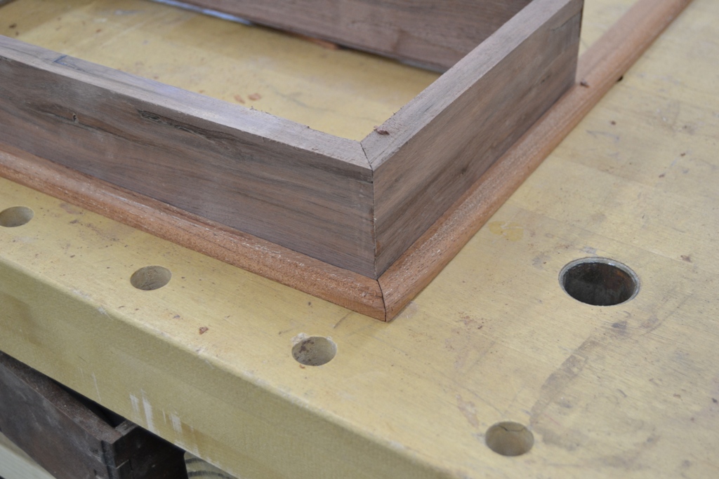

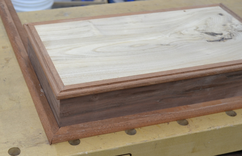

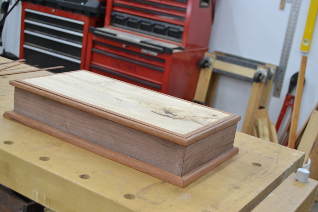

I started assembly this afternoon. The first step was fitting the trim around the bottom of the box. To get the trim to match up, I used the shoulder plane to trim the inside shoulder to mate the trim. I inverted the box frame and inserted the bottom, the bottom is free floating and the trim holds it in place.
After fitting each piece of trim, I coated the inside edges of the trim with glue, spread it evenly and then shot a few pins with the pneumatic pinner to hold it in place until the glue dried, then moved to the next piece. I would trim and try, trim and try until the shoulder plane did it's work. Once all the bottom trim was in place, I coated the entire project with an additional coat of the Golden Oak Watco Oil as planned. This included the top, which has yet to be attached with the hinge. I will do this on Wednesday, after waxing both components with the first coat of wax and buffing them out.

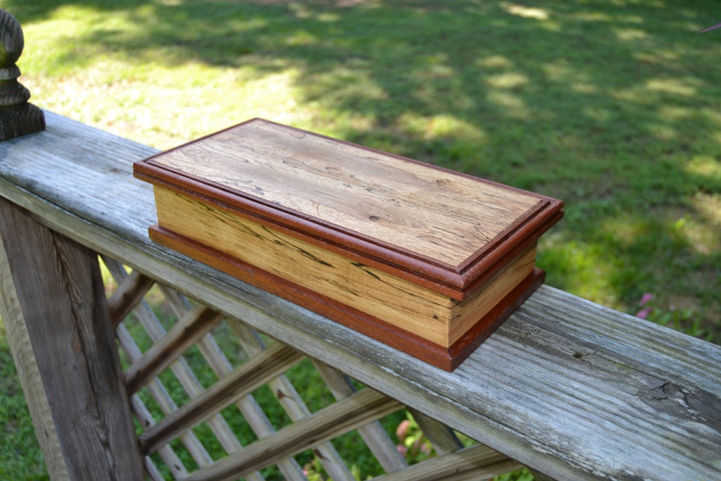

Here is what she'll look like when she is done. (Pretty much.... ) :roll:
