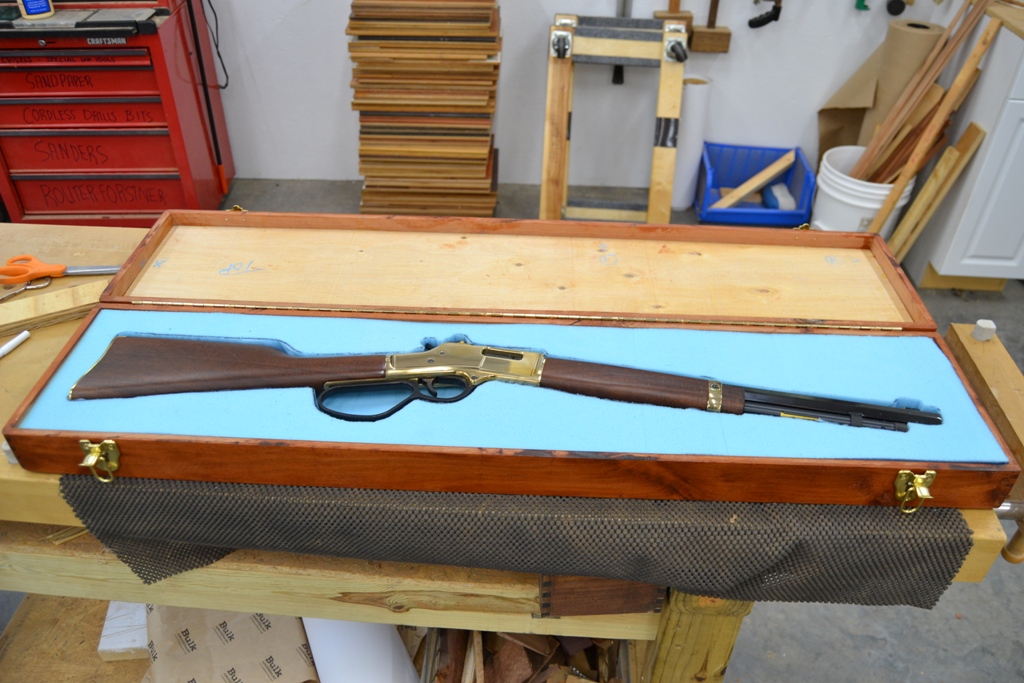

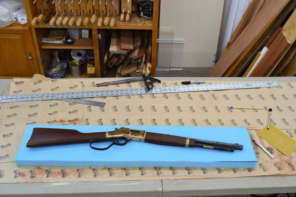

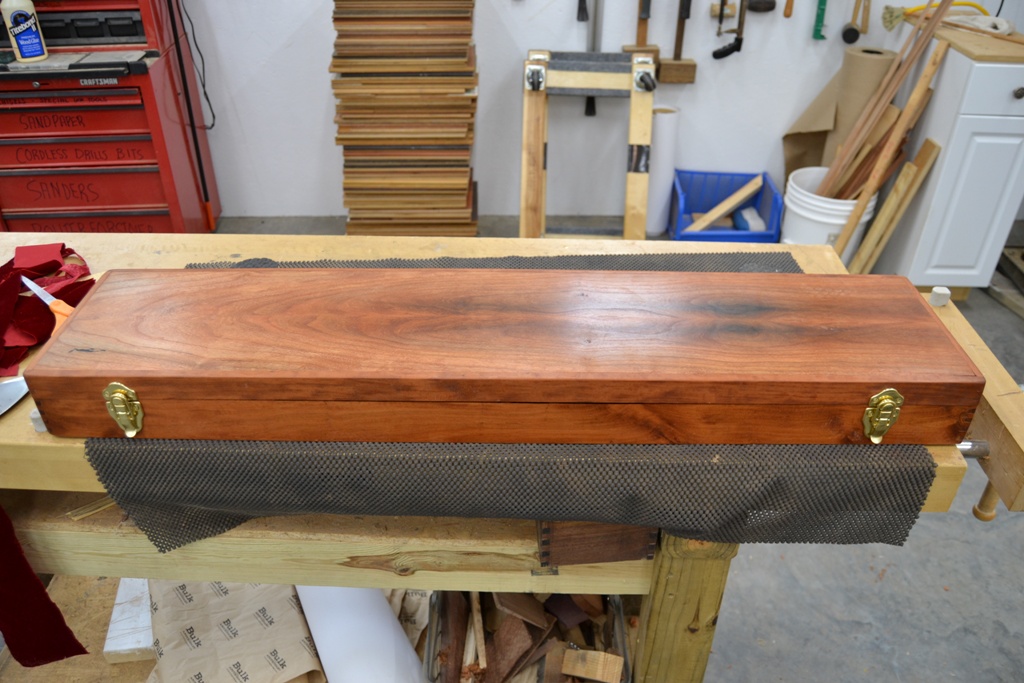

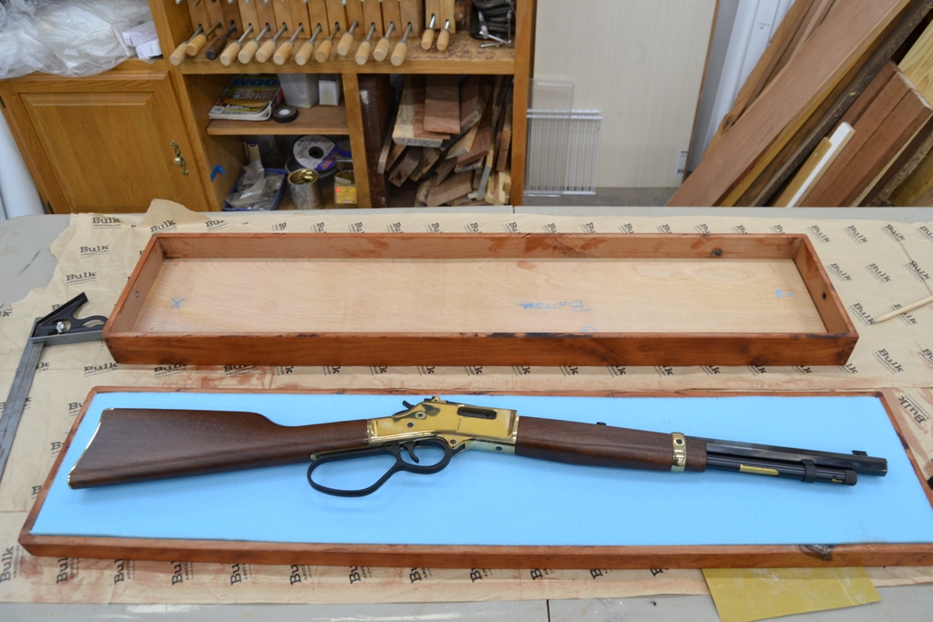

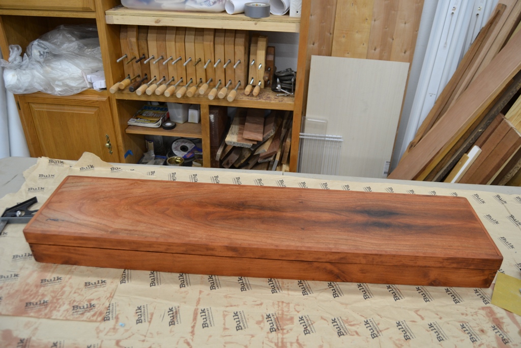

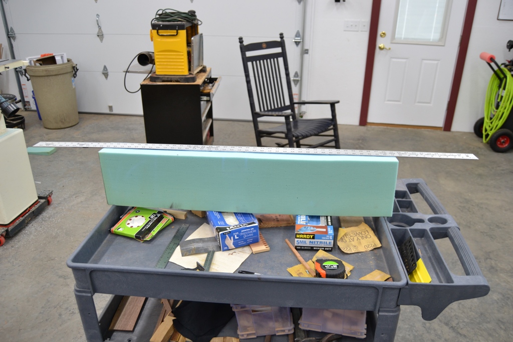

Went out this morning and waxed the case. :P She is looking good. Then I went out to the wood shed and found the hard foam that the boss told me she stuck out there. Measured and marked the foam and ran it thru the bandsaw to get the width correct, than a pass across to get the length right. I ended up with a 5" thick piece that fit. :lol:
The next step was to measure the depth of the top. Meh... 3/4" or so. I marked that on the side of the block of foam and ran 'er through the bandsaw... she fit the top very well.
I laid the Big Boy Carbine on top of the top, so I could measure the thickness of the rifle, and see how much of a base I would be allowed in the bottom, and how thick the secondary foam would be. :? :roll: ;) Calculations... Bottom needed to be 1/4" and the rest of the thickness would be for the insert for the rifle. The top will come down and secure the Carbine in it's slot when the case is on it's side in "carry" mode. 8-)
(Like I'll actually carry it around that much.... :) )
Made the appropriate cuts, then checked the fit. Yup, they fit. Outlined the Carbine once I decided where I wanted it. I cut out the slot for the rifle VERY carefully with a razor sharp exacto knife. Miss Tina says she will help cover the foam with the Burgandy Velvet. If I screwed it up, I have plenty of Foam, and can start over. NOTHING will be glued in place until it all fits just so.

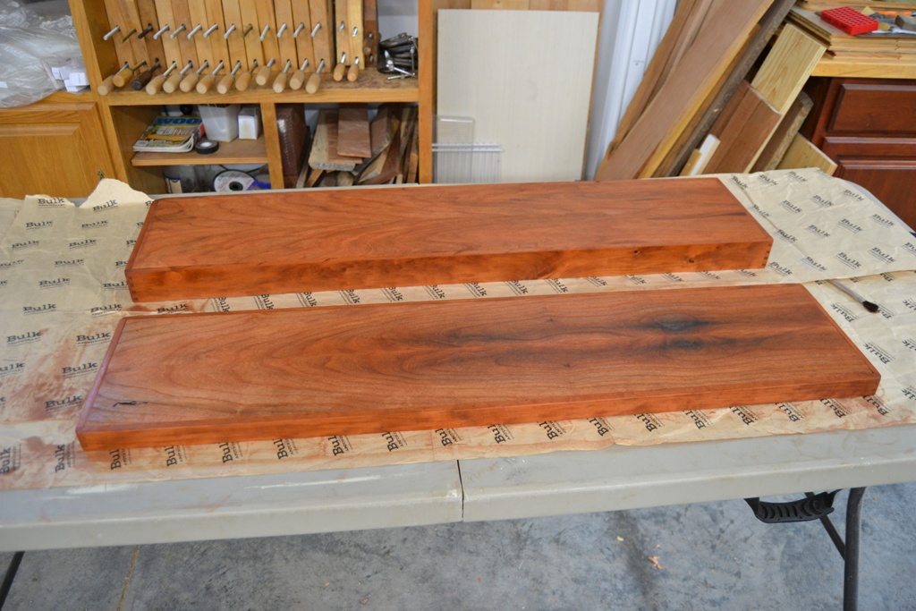

By the way, here is a peek at the waxed box, another couple coats of wax will make 'er glow. I'll have time while Miss Tina works on the velvet

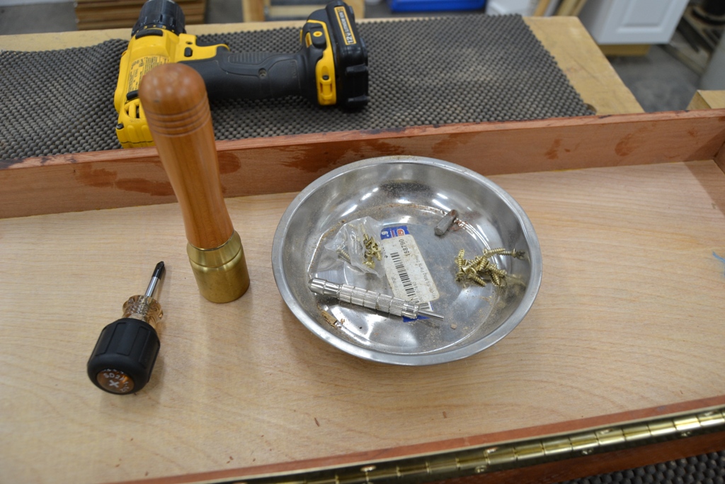

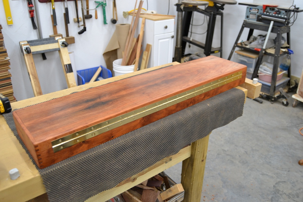

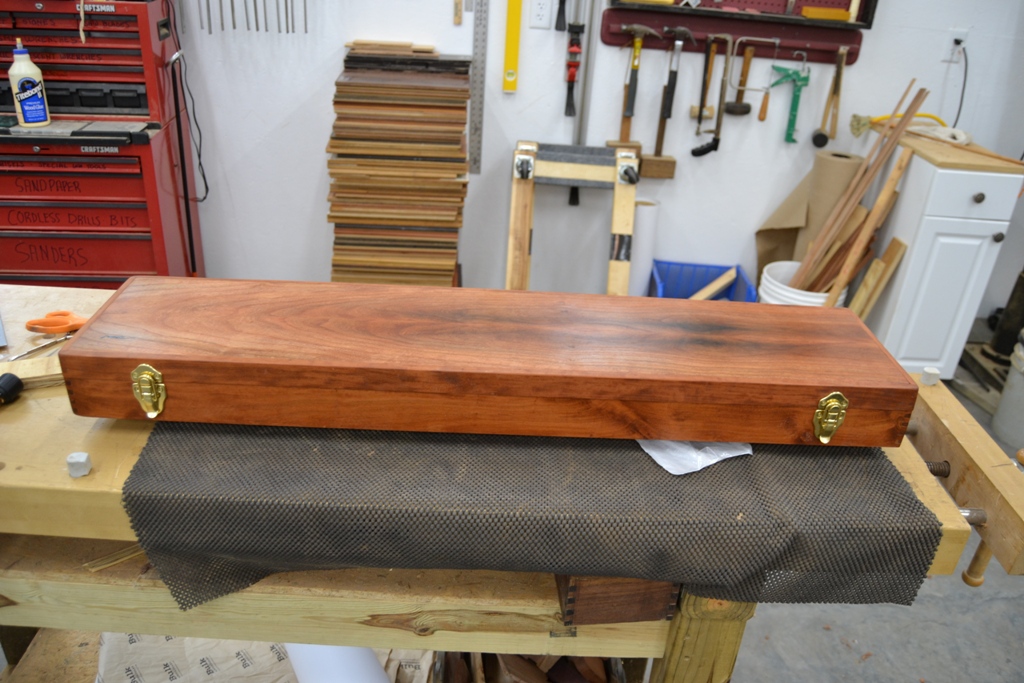

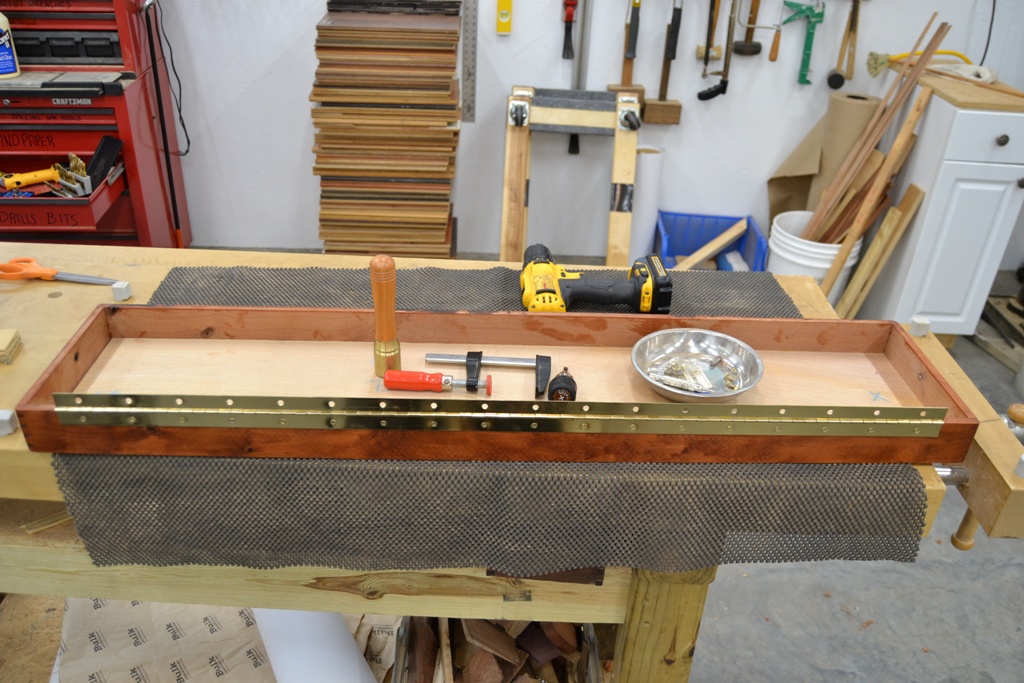

While Tina worked on the inserts I was working on the hardware installation. First up was the Piano Hinge for the rear of the case. Gather the tools. :) The right tools can make the job so much easier. I used a centering punch, a small brass mallet, cordless drill and pilot bit and a proper screwdriver. Note the magnetic tool tray. It works with the brass "plated" screws.
I held the hinge in place with a light clamp pressure until it was screwed in place. Careful measurements don't matter if the clamp shifts after the first few screws go in and the hinge ends up crooked. :evil:
Once the hinge was in place on the bottom half of the case, I aligned the top half, clamped that in place, and worked my way from left to right, insuring the hinge stayed aligned from one end to the other. Each screw was snugged. Never want to overtighten the small screws. Shear off a head and you have a tough error to correct.
Now that the hinge is installed, time to lay out the front.

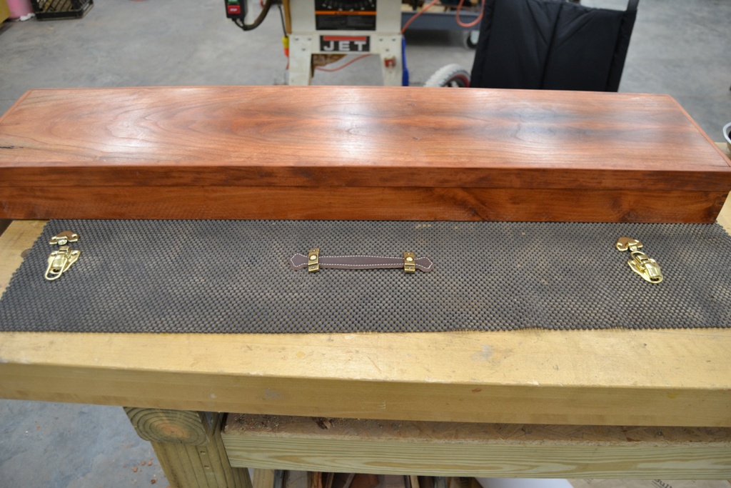

Have the latches and the nice leather handle to install. Carefully position each one, then try them for function. Ah... latches will work. Install them.
Hmmm, testing the nice leather handle... :roll: ... it's not going to work. It's too short in length to open up enough. It looks great, but function wise, it's too small for larger hands, and with the weight the case will contain... :evil: It's just not going to get the job done. I'll save it and use it has a handle for a nice custom box. I will order a larger more appropriate handle. Should just take a day or three. Give me time to redo the bottom foam. Testing of the foam pads has proven that the lower foam is just a tad too thick. I'll redo that one and leave a little room for the box to close.
:lol: Closing is always a good thing.

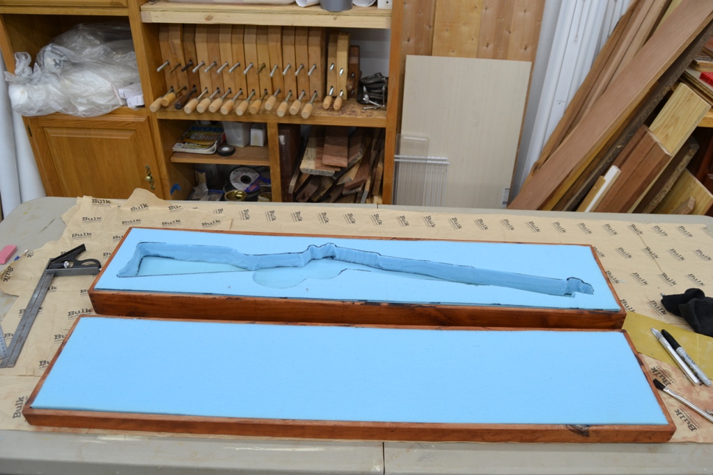

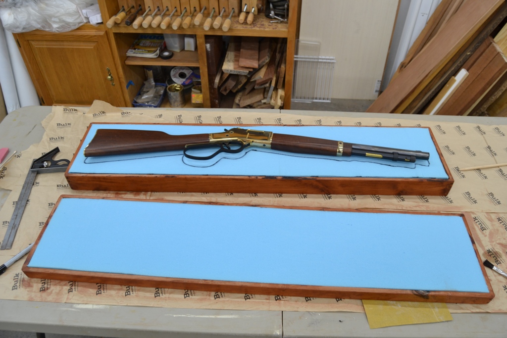

I got out this morning and worked on a second try at the bottom of the gun case, and it's foam insert. This time I made sure the foam was JUST a hair below the edge of the rim of the lower half of the case, and rather than try and trim a piece off the bottom of the foam, I cut out the whole outline, then cut a portion of the removed section to pad the back half of the rifle and fitted it back in, then a thicker portion of the barrel section of the rifle and fitted it back. Excellent.
new bottom layer.jpg (277.63 KiB) Viewed 1694 times
I cut another section of blue foam, then cut it to width and length and fit it in the bottom, drew around the edge of the rim, and then cut JUST below the line to make it the right height. Rather than use the old piece as a template for cutting out the form for the rifle, I redrew the form after deciding just the right placement. (again... :roll: )
I took my time, and tried to make the cuts as smooth as possible. This will make the velvet fit better than if I had just hacked away the foam and hoped for the velvet to cover my half hearted attempts. :? As you can see, the Big Boy lays in the slot pretty well. Now it's just a matter of getting the Deep Burgandy Velvet to look good laying over the foam insert, to look like someone who had a clue put the package together. :lol:

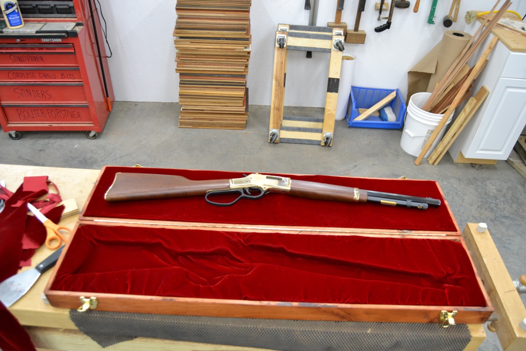

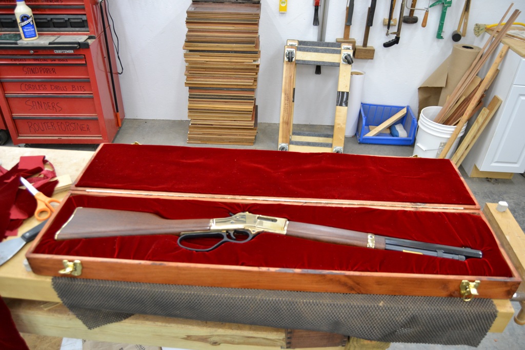

Worked again this afternoon with the Burgundy Velvet the wife found for me... and the case is lined.
It's done.jpg (256.36 KiB) Viewed 1681 times
The Big Boy Carbine 357 fits nicely in it's slot but is flush with the top of the bottom half of the case.
lined with burgandy.jpg (272.37 KiB) Viewed 1681 times
It's nest is padded underneath to protect the Carbine, and the lid closing down pinches it just enough so it doesn't move. No movement means the Skinner Sights won't get banged up. Yes, it does close right up, and you can "feel" the pressure in the last little bit.
and it closes.jpg (271.47 KiB) Viewed 1681 times
