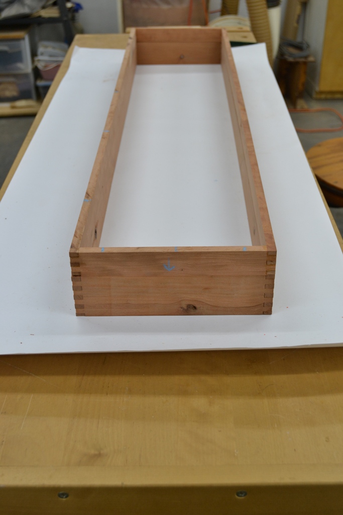

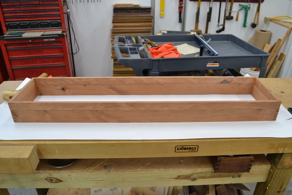

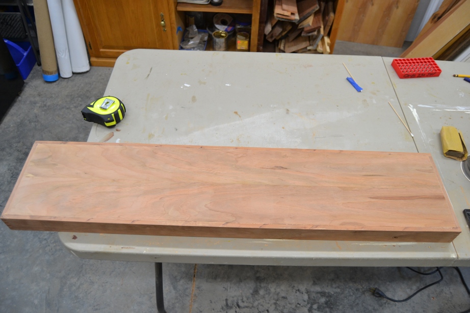

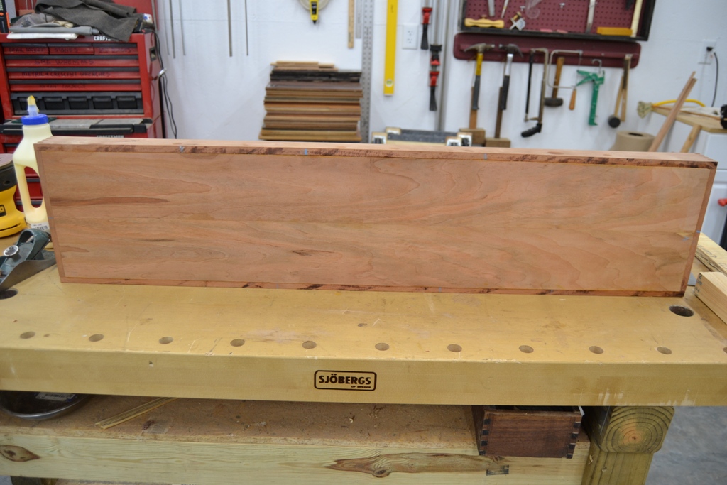

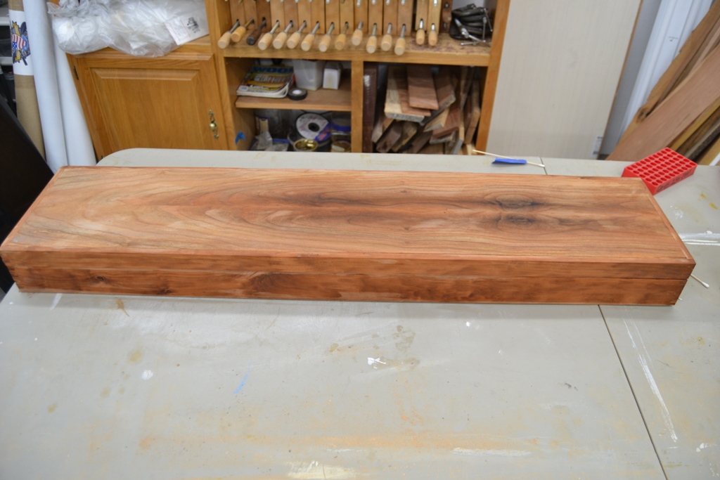

I unweighted the dry frames and took off the tape and waxed paper, and as promised, took a pic or three to give us a feel what the case will look like, at least from the sides. :P Well, at least before more sanding, polishing, finish, polishing, hardware... you get the drift. 8-)
frames 1.jpg (297.87 KiB) Viewed 1753 times
frames 2.jpg (206.54 KiB) Viewed 1753 times
frames 3.jpg (281.45 KiB) Viewed 1753 times

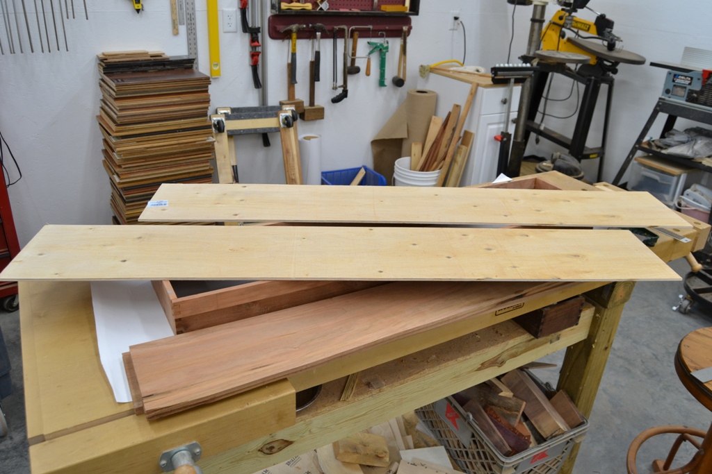

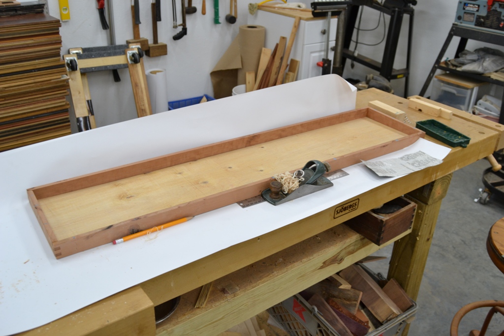

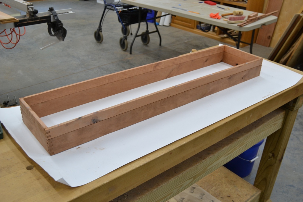

Once I got those pictures taken and had a look at the frames themselves, I took additional measurements, and wrote down the figures, and then before beginning to cut the backing, I checked the tablesaw blade and fence for true and found that the fence was OUT about a 1/16th inch and needed adjustment. This would have caused a problem with the LONG cut for insert for the frame, so I took the time to readjust the rip guide so that I had a better chance NOT to screw up those cuts. :roll:
Checked a few other things, connected the dust collector, took a deep breath and made the cuts, slightly oversize so that I could FIT them... and got busy. As you can see by the pics, I used the block plane to slowly fit the backers to the top and bottom frame, taking my time to get the best fit possible.
backers 1.jpg (318.09 KiB) Viewed 1753 times
backers bottom.jpg (247.84 KiB) Viewed 1753 times
backers top.jpg (290.9 KiB) Viewed 1753 times
The next step has the real pucker factor, so I will take a break and get fully rested. The next step will have me cutting the Cherry Side pieces to glue to the backers, then gluing those into the frames. :? I have to decide whether or not to glue the TOP a bit proud and roll the edges or glue it flush. :)
The Bottom I know I'll glue flush to protect the edges. ;)

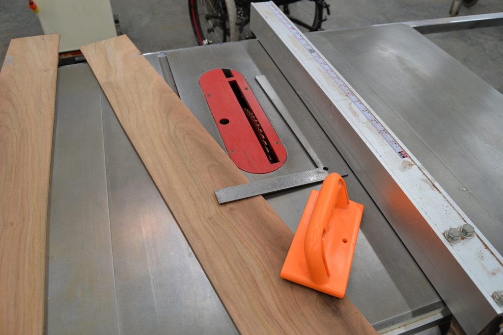

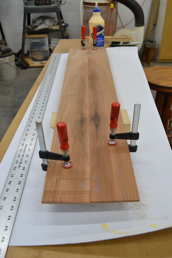

Started the top insert... and the pucker factor was high as I made the first pass on the table saw.
I set the rip fence so the cut would be just a hair over four inches, and made both cuts. Both boards are still well over length, to be trimmed at the time they are fitted into the frames to insure a nice tight fit.
just a hair over 4 inches.jpg (276.28 KiB) Viewed 1738 times

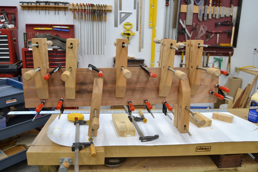

I had drawn a reference line down the center of the backer board, and then rolled the board with glue to insure a solid bond.
glue up one side.jpg (276.37 KiB) Viewed 1738 times
Carefully aligning the one board, I held the position with a few small clamps, then added the second board, after rolling the glue on the second side and painting the joint edge with a hair brush to insure another good bond. Held that position with a few small clamps as well. Note the chalk alignment marks on the panels. They help in initial alignment of the grain, and insure I am putting the best face UP on the backer board. :lol:
both sides.jpg (257.58 KiB) Viewed 1738 times

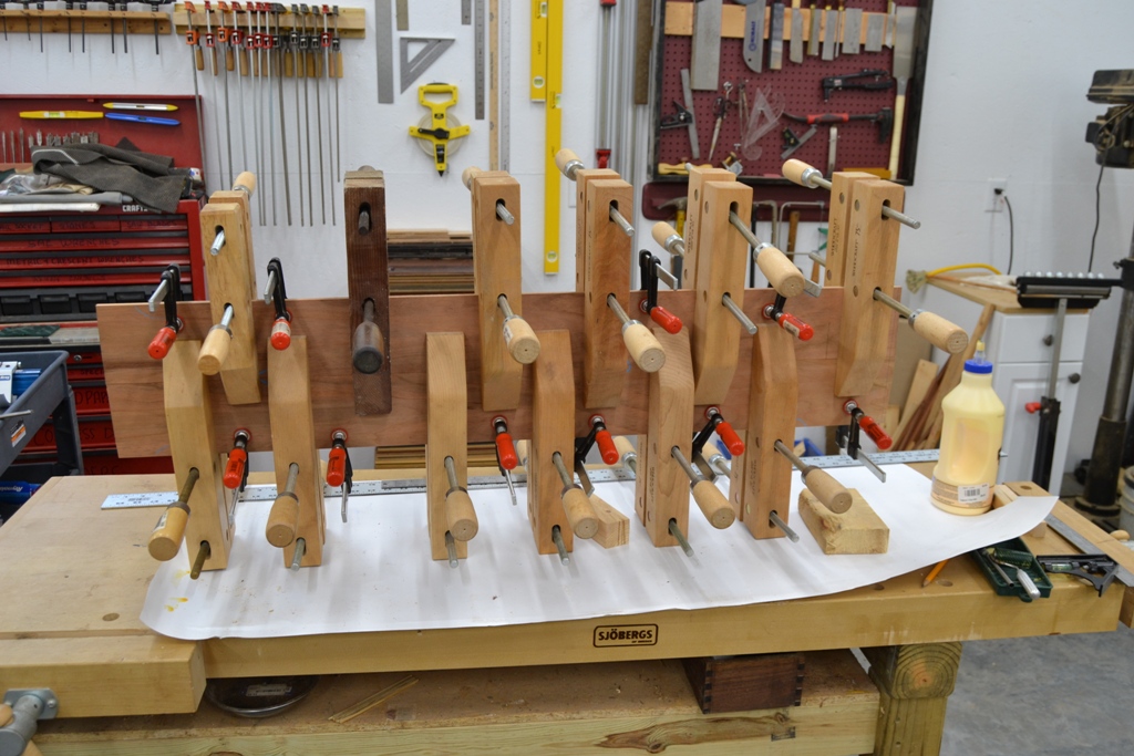

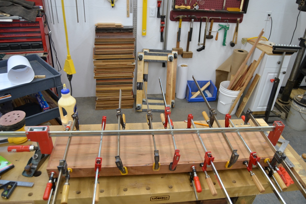

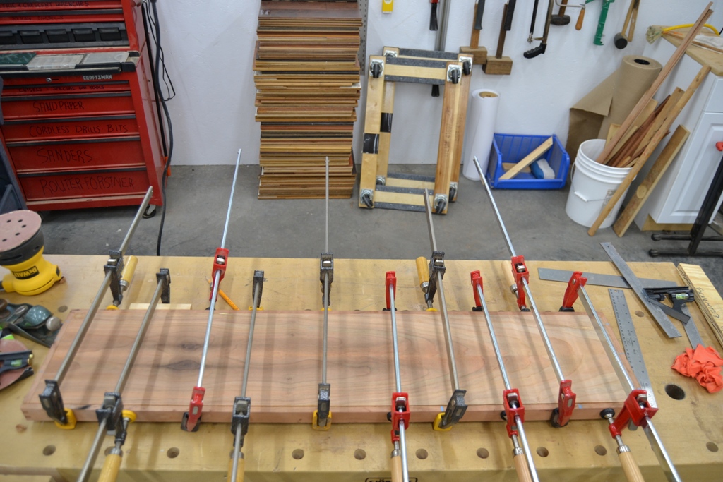

Once I was satisfied with the position of both the boards, I started to add cabinet maker's clamps. These put good pressure across the surface of the boards. I added one or two of these, and then left them overnight.
clamp or two.jpg (334.49 KiB) Viewed 1738 times
Once this panel has dried overnight, I'll glue up the second panel and allow it to dry overnight, while I use the plane and sanding block to carefully fit the dry panel to the appropriate frame. I will then glue IT into the frame and allow it to dry. After which, the second panel can be fitted and glued in the following day. Once both are fitted and dry, I can order the appropriate hardware and fit that. Then remove the hardware and start the final sanding of the outside.
There will still be the INSIDE layout and fitting, and the velvet lining.. (A last step to avoid all the dust and chance of glue damage.) ;)

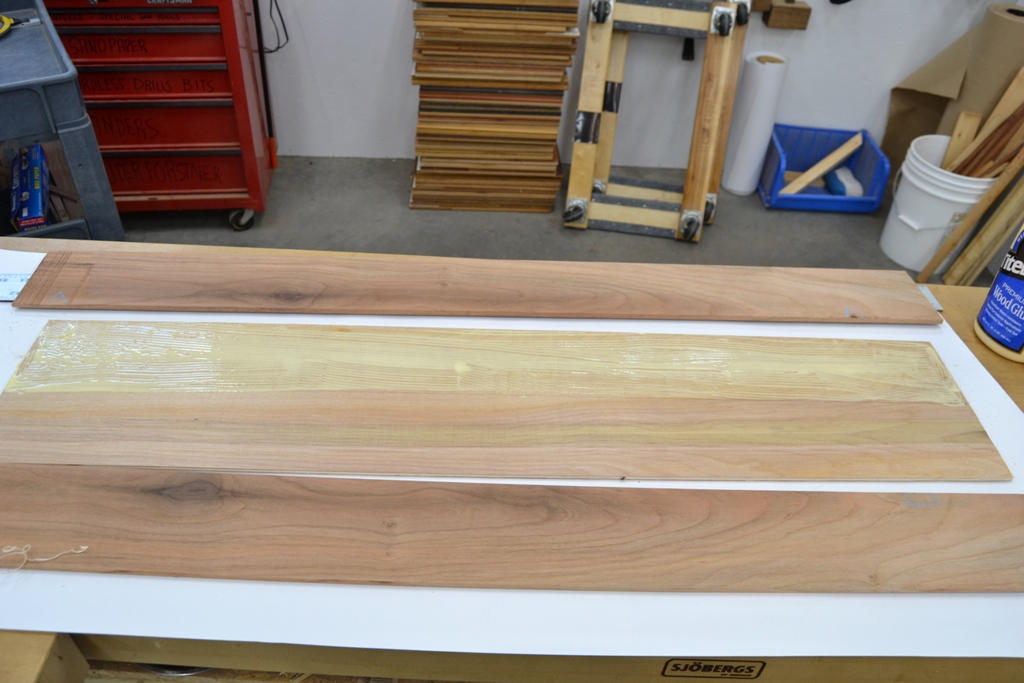

Back at it today. Not a mistake as long as you learn from it? I took the TOP panel out of the clamps and there was a short portion of one edge that didn't glue down tight. :evil: I injected some glue into the area, and applied a couple clamps and set the panel aside to dry overnight. Sheesh. You'll note that there were a couple spots where the clamps left blemishes. This is why I didn't worry about having the panels perfectly sanded prior to gluing them to the backing. The final sanding will deal with all the issues, including a couple spots that are still rough. Those really rough spots on the end will MOSTLY be trimmed away when fitting the panel to the frame.
learn from mistakes.jpg (284.04 KiB) Viewed 1722 times
LEARNING from the previous day's error, you'll note if you scroll up to compare; I used a couple more clamps on the bottom panel glue up. ;) Yeah, a couple more. :D :lol: :P This "should" eliminate any chance of a loose edge. But, you never know.
a few more clamps for the bottom.jpg (342.08 KiB) Viewed 1722 times
Same process here as the last time. Trimmed both pieces to just over four inches wide, used a centering reference line and glued them on the backing panel and then applied the clamps. I'll let the panel assembly dry overnight. Tomorrow I'll remove the clamps and put them away where they all belong to get them out of the way, as well as the rest of the tools I won't need right away. Then start the first steps of the fitting process. No rush, all the time in the world. Don't want to screw this up this late in the game. :roll:

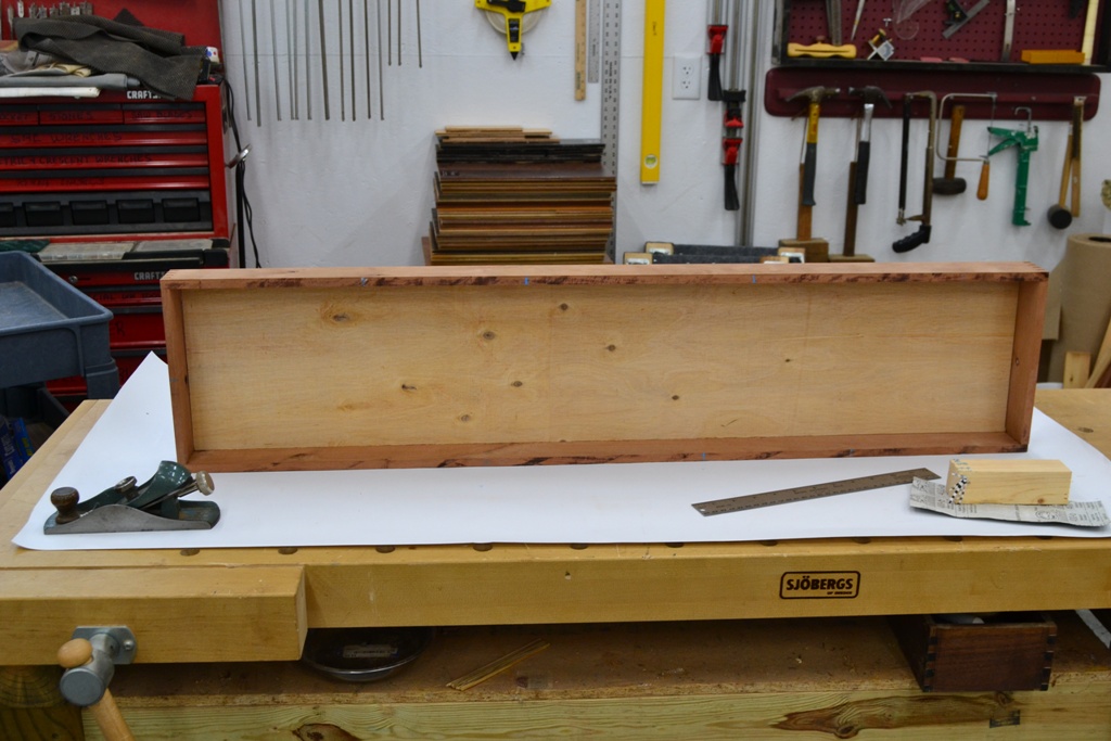

Getting the panels glued in. :D This entails planing the edges to the proper size then trimming the ends until they fit. ;) Have to trim them to fit nicely, but don't want to over trim. :? Once they fit, apply glue to all four edges, slip them into place, and then clamp everything. I used the small clamps to set the depth when I dry fit the panels. I wanted the panels about a 32nd proud and when I roll the case edges in final sanding, I'll blend that edge. Much rather have that panel edge a bit high, than below the edge of the frame. :)
Did the bottom panel first, then left it overnight to dry.
Bottom panel glued into frame.jpg (361.66 KiB) Viewed 1709 times
Bottom panel looks okay.jpg (294.92 KiB) Viewed 1709 times
It came out of the clamps this morning, and looks okay. Of course, sanding and finishing will make it look MUCH better.

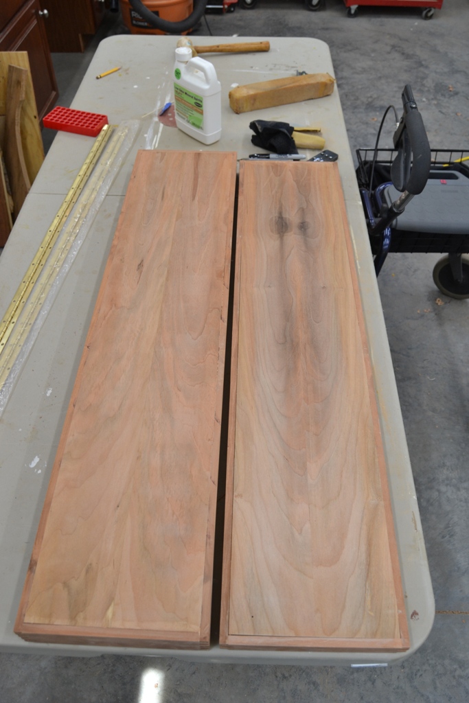

Post by BrokenolMarine » Wed Jul 19, 2017 5:46 pm
Got the top assembly out of the clamps and put them away, got some sanding done. A trick to the work is to wipe down the piece with odorless mineral spirits. It lets you see if you missed scratches or dings, removes sanding dust, but most important of all: it shows you what the grain will look like with a stain applied. :P Then, it quickly evaporates without a trace. As you can see in the picture, It looks uneven because it's evaporating and it's already leaving ... But .. where the box is still wet, you get a taste of the grain with a medium cherry stain. ;)
a peek.jpg (266.32 KiB) Viewed 1632 times
There's more sanding, and I have dug around and found the piano hinges. I'll need to order the latches for the front and the handle. Unless... unless I decide to just make it a display case.. :roll: Sheesh... decisions, Decisions. What say you? Travel Case, or Display Case? :? :roll: ;)

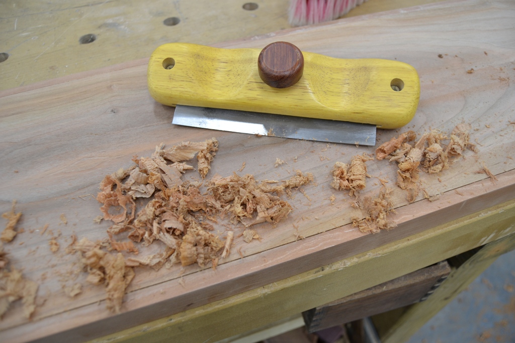

Sometimes, I hate that memory loss thing from all the anesthesia from these last four (or was it five? :roll: :oops: ) Surgeries. There are things I knew how to do, or techniques I should use that I just plain forgot. :evil: I was sitting in the recliner last night, reading one of the John Sandford novels for the seventh or eighth time... (Okay, one of the benefits of memory loss... ;) ) and out of the blue, CARD SCRAPER popped into my head. :shock:

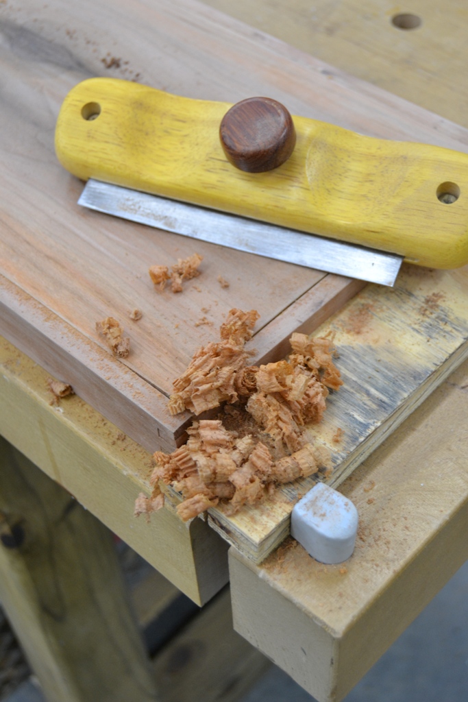

I have a dozen in the shop and a couple favorites are hanging right above the work bench. Exactly what I normally used to take down that high edge and smooth out that transition on the bottom and top of the case. :? Couldn't wait to get out there this morning and give 'er a try. A couple passes with the scraper gave me this:
scraper 1.jpg (286.56 KiB) Viewed 1622 times
Another twenty minutes or so work gave me a much improved transition.
scraper 2.jpg (298.55 KiB) Viewed 1622 times
The scraper takes a nice thin shaving, but you'd be surprised at how quickly the properly sharpened card scraper can remove wood. Beats the heck out of sandpaper, and cheaper too.
scraper 3.jpg (310.53 KiB) Viewed 1622 times

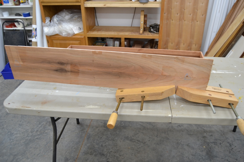

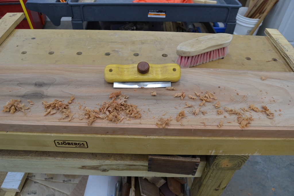

After working on the top and bottom assemblies with the card scraper, I went over both with the sander, fitted with 120 grit paper. Later I'll go over the assemblies with 220, and perhaps 400. For now, I'll wait. I won't round the edges and shape the corners until the hardware arrives. I ordered it this morning, including the leather handle, since I decided to go with the "Travel Case" idea. Didn't want to waste that beautiful grain in the bottom assembly. :P
Can ya'll tell the difference after the hour or so work blending the edges this morning? Or is it just me? Wish you could feel how smooth they are. :)
scraper 6.jpg (272.92 KiB) Viewed 1622 times

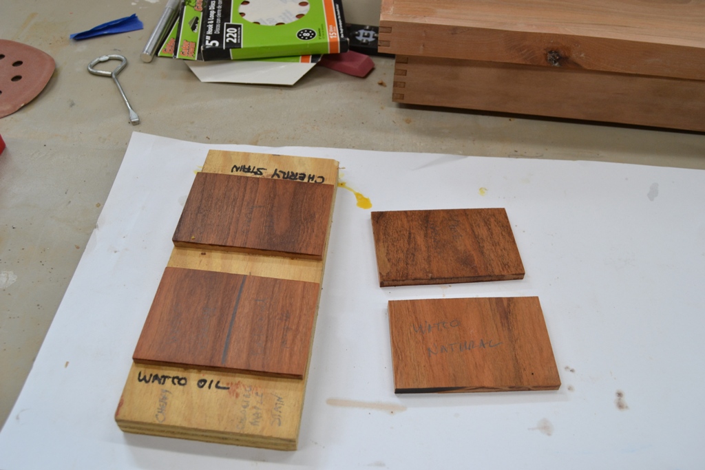

As we draw closer to the end of the project, the smaller things become more important. I start to think about "What Finish?" :roll: One way to decide is to take all those cut offs you save.. (Knew I saved them for a reason...) .. and make finish samples.
test samples for finishes.jpg (251.86 KiB) Viewed 1609 times
Some of the pieces have test stains on the back as well. After talking with the boss, Miss T and I agreed that the Watco Oil Cherry, the stain in the lower left corner, is the stain I'll most likely go with. Watco Oil is my most used finish. It soaks in and "treats" the wood, gives a nice even coat, and if it's not dark enough, you can reapply and darken 'er up. (in most applications.) In addition, if you want a soft gloss or high gloss, you apply a quality wax and then buff er out. Later, if it needs more shine, hit it with more wax, and boom, buff it and you are good. Ding it, hit the ding with watco, and then wax it, and it will match.
