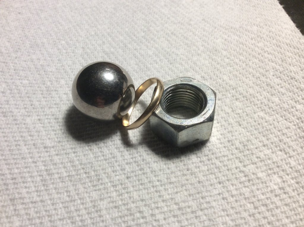

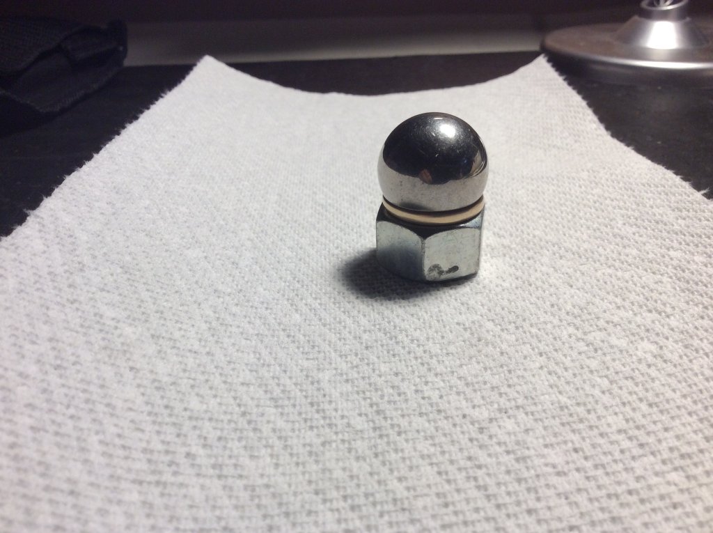

Yep my wedding band was getting too tight so came up with this idea to resize it a bit. Just put it in my hyd. press and with a bit of pressure on both sides fits perfect now. Just took a nut with some balls to do it! :lol:

Sweet. Did you heat it slightly first?

A slight adjustment is made with a tapered tool and a hide mallet turning the ring so you don't taper the band. Sometimes the band is brittle after years of being worn but can usually be increased a size without a problem. If it is too brittle and cracks it can be repaired and then it needs to be annealed.
I had a jewelry store for a while. 8-) You did well Forty!

Post by fortyshooter » Fri Sep 09, 2022 7:19 pm
BrokenolMarine wrote:
Fri Sep 09, 2022 8:46 am
No I did it at shop temp. and it worked well.

Ernie wrote:
Fri Sep 09, 2022 5:29 pm
Yeah I had thought of making a short tapered shaft but wanted to try this brainstorm first being much quicker to do.
