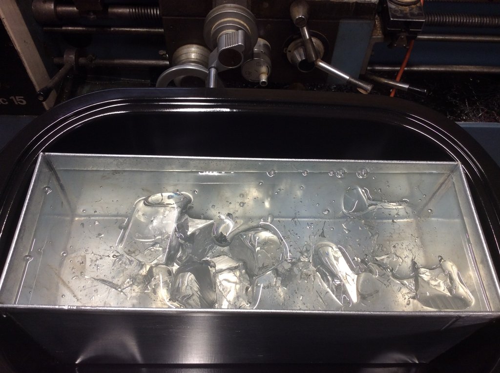

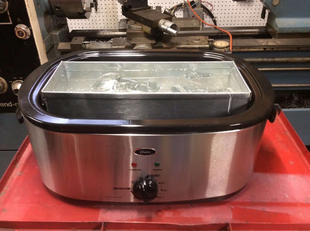

Slow cooking the Ballistic gel ! You break it up in small chunks...set the Temp to 250F and let it simmer most of the afternoon.
Then let it cool for 12+ hours and pull it out the mold.
Hope wifey don't need to cook nothin'! :lol:
Not to worry though I bought this just for the job!

Well getting any debris out was simple as in just break the stuff apart and any bullet frags would come right out.
I took a serrated knife and cut block into 2 inch slices and then just tear that into chunks.
Re: What's in the roaster today?
Post by fortyshooter » Sat Jan 16, 2021 9:11 pm
A very slight odor but not bad. I was doing the operation in the garage and it all worked out very nice.

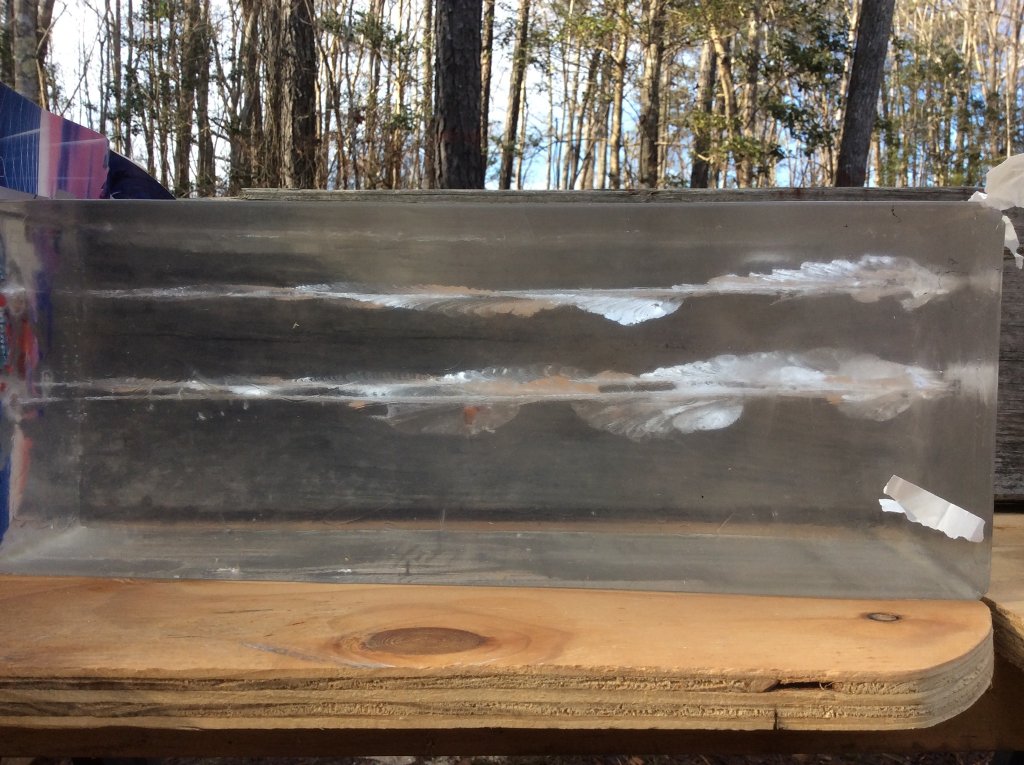

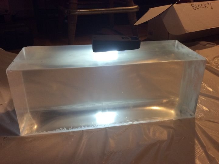

One nice remolded block of ballistic gel ready for the range! Worked out really well and came out nice and clear. Takes some tugging to get it out the mold box though! Before and After remolding pictures

side view of gel block from 45 colt 200 gr ftx test.jpg (161.5 KiB) Viewed 1014 times

After
one remolded block of ballistic gel.jpg (36.65 KiB) Viewed 1014 times

No release agent applied unless using a high temp plastic mold so they say in instructions. I take a knife and run it down and around the sides to break the seal/suction and then you work your hand in at one end with the mold standing up on end. Push in and pull out and it flops out.
Oh and make sure to have some clean plastic sheet on the floor so it doesn't pick up any dirt/dust as anything will stick to it!
