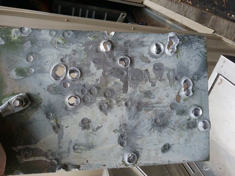

If it's 1/4" steel you should be okay. This is an aluminum plate I use for my 100yd range plate. .22 will knock the paint off, 9mm will leave a pock mark. The holes are from a .308. It's 1/2" thick. I have tons of scrap metal that I make targets out of. I also have 1/4" steel that works pretty good for 9mm. I think the Crosman targets are 1/4"

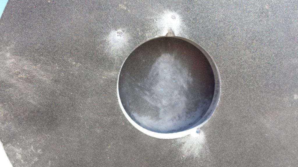

I have been shooting steel for 35 years. After the first of the year I am going to post some info/ideas for portable ranges and targets including steel. Since I always transport my range to a shooting area, I have streamlined the process down to make it easy.
As far as steel, you need to know a couple of things:
Type of Steel
Thickness of steel
Caliber of weapon and type of ammo.
So, in a nut shell, AR500 steel is bullet proof, literally. You can use a 1/4 inch AR500 target with any handgun caliber expect magnum. You also get a nice large GONG when struck. As we say, "Let Freedom Ring!"
As an example, you can get a 10 inch 1/4 inch steel target in AR500 for about $25.00
Another good steel, a step down form the AR500 is 46100 steel. It is the type of steel used in armored plating by the military. A 5/16 10 inch target in 46100 is $30.00. The difference is the 5/16 inch target will hold up to a 5.56 or .308 round with a velocity at target not exceeding 2,400 FPS without any pitting.
I buy my steel exclusively from Shooting Targets 7. (website: https://shootingtargets7.com/ ) It is Veteran owned and operated, 100% made in the USA, and in my opinion having shot a lot of steel, quality, low price, and great customer service. Mark, the owner, is absolutely approachable and will answer any question you have, so don't hesitate to contact him with any questions.
I know this is a long answer for a short question, but if you want to shoot steel, I strongly recommend you check out their site for steel, target hangers, etc. Shipping is free over $99.00, and they have a great downloadable file on shooting steel I suggest you download and put a read on.
5.56 @ 150 yards with AR500 10 inch target with a 3 inch bullseye hole.

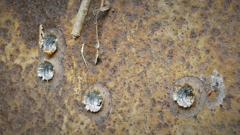

This what a 5.56mm fired from a Long Ranger at 75yds will do to the steel scraps I have. 1/2" thick steel and it is nearly penetrated.
