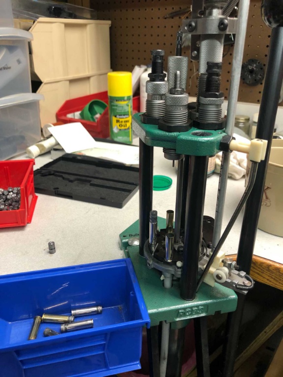

The first picture are these rounds coming off my RCBS progressive press.
Press setup
Press setup

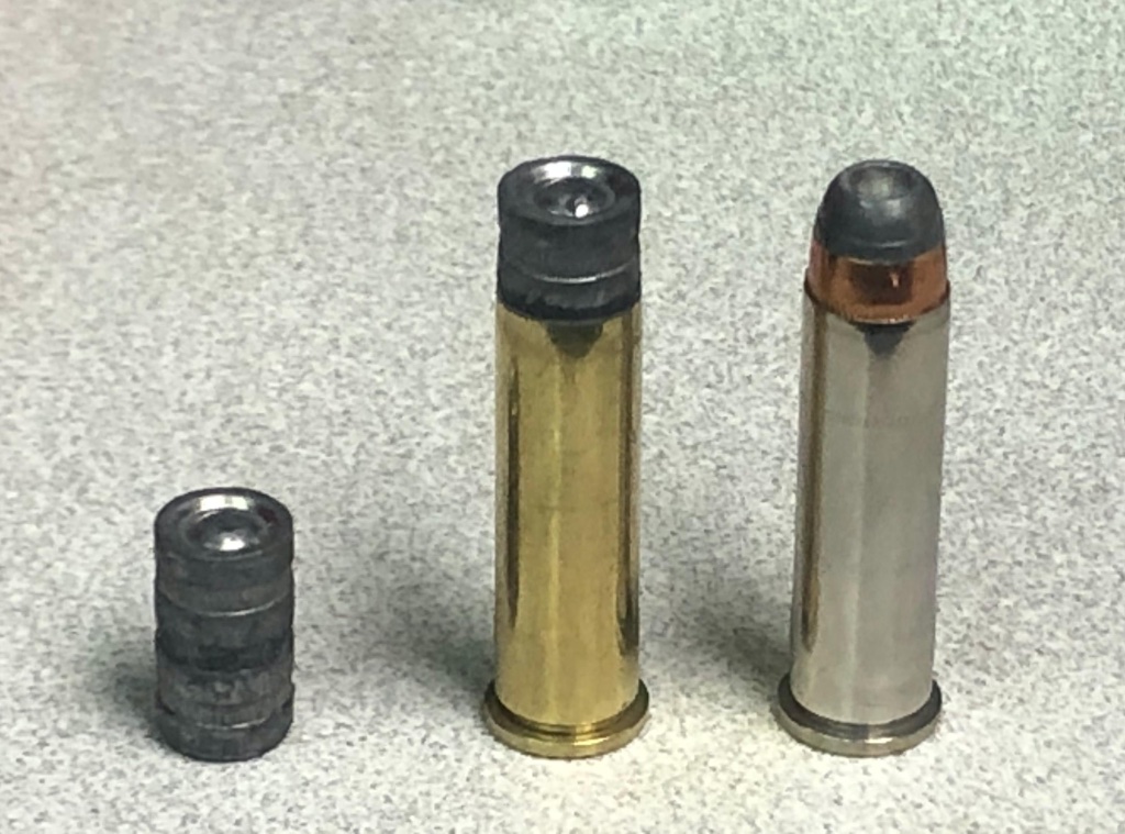

The second picture is for comparison. Left to right is the 148 gr. wadcutter I'm using for this load. Middle is a completed wadcutter load and right is a 158 gr. Nosler 357 Mag. load for comparison.
loads
loads

After loading 10 rounds in the mag tube getting the mag tube follower back is a little tricky. The tube seems to catch on some rounds as you slide it back down. Not a big deal just back it up a little and shake the rifle and continue on. After two or three tries you get the hang of it. Just a slight inconvenience.
I did run some over the chrono and the are running about 800 fps. I expected them to run over 900 fps but what the heck they are fun and easy to shoot. Just one last thought, because these loads are low pressure, the cases are very sooty from lack of expansion. Just like I would see on my 45ACP semi wadcutter Bullseye loads.

I'm curious, Paul. Why did you want the COL longer than Hodgdon recommends for that bullet in a .357 cartridge?
Posts: 1518
Re: Wadcutter Experiment - UPDATED
Post by Headhog » Mon Sep 28, 2020 6:04 pm
CT_Shooter wrote:
Mon Sep 28, 2020 5:31 pm
Headhog wrote:
Sun Sep 27, 2020 8:39 pm
My plan is to load these to a recommended 357 Mag. round using Universal powder. Hodgdon list this combination in their data using 3.5 - 4.0 gr of Universal and developing about 880-989 fps. The only difference from Hodgdon's data will be the overall length. Their data shows this wadcutter loaded almost flush with the case mouth.
I had a concern that loading the round flush (or just slightly protruding) might impact how the rounds fed from the magazine. I first experimented with some 38 spl wadcutter loads that I had and they wound not feed at all. I was getting 2 rounds at a time out of the magazine and it would jam up the action completely. I reasoned that for the magazine to feed properly a round has to be at least as long as a loaded 38 spl. with round nose bullet. So that lead me to load the wadcutters out.
