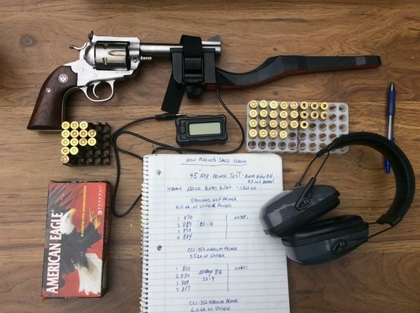

These days with primer shortages you may have to use what you can find. So this test was to see if there was any difference in bullet speed or accuracy using the CCI 350 Magnum primers vs my standard Winchester WLP primers. I was able to find a 1000 of the CCI 350 primers about a month ago since the LGS was out of the others.

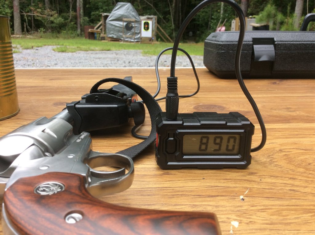

So the test was based on my 6.0 gr.Unique 45 ACP load using a plated 230 Xtreme bullet. Also it was test time for my new Magneto Speed Chrono.
Let me say I now highly recommend the basic Magneto Speed Sporter unit as it worked perfectly every time! First shot showed no reading and as the tech had told me to bump up the sensitivity one level it worked from then on. The unit has 3 levels of sensitivity for different type and speed of bullets. Very easy unit to scroll thru and review data and no worry of what the sky conditions are or to be precise with your aim across the old style optic sensors. https://youtu.be/YdPHtH7qtRs

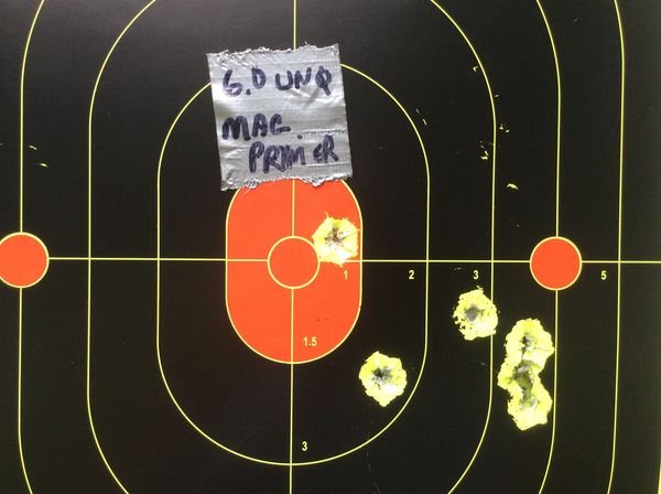

Now the Techs at Alliant Powder will tell you not to do so but the speeds and deviation were the same range as with the standard primers. No sticky case extraction or flattened primers. Accuracy was much the same with similar shot groups of of my Ruger Bisley.
Target distance was 18 yds, and shooting from sitting position off my table.
Average FPS with 6.0 gr of Unique and WLP primers was 874 and with CCI 350 Mag primers 866 FPS. Speed deviation was 16 with WLP and 17 with CCI 350 primers. The lighter 5.5 Unique load with CCI 350 primers was slower at an average 816 FPS as it should be.
