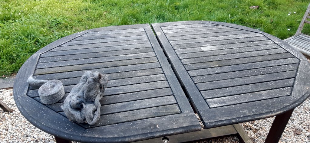

Having time available, more than usual, with the rules of confinement at home,
I undertook to restore a teak garden table, which had stayed too long in the winter rain.
A friend who leaves her house to live in an apartment in town sold it to me for a very nice price
Upon arrival at home:
Table jardin restauration - 00.jpg (178.62 KiB) Viewed 6588 times
I initially thought to trade with steel wool, then finer iron wool, but it clogged the wool too quickly.
So change of strategy:
Bleach + brush water
Let act for a while
Scratching jex pad
A little muscular vigor (not sure for translation :) )

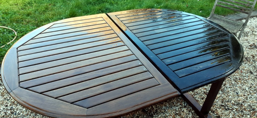

First day :
Table jardin restauration - 01.jpg (166.76 KiB) Viewed 6588 times
The left side is cleaned, the right side impregnated with bleach, until the next day.
the feet and the underside of the tray have already been cleaned, then passed with teak oil.
Second day :
Table jardin restauration - 02.jpg (124.06 KiB) Viewed 6588 times

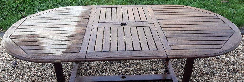

The left part has dried, and the right part is cleaned, but completely wet.
We let everything dry before going to the iron wool
Table jardin restauration - 03.jpg (202.48 KiB) Viewed 6585 times
The rest, tonight :-)

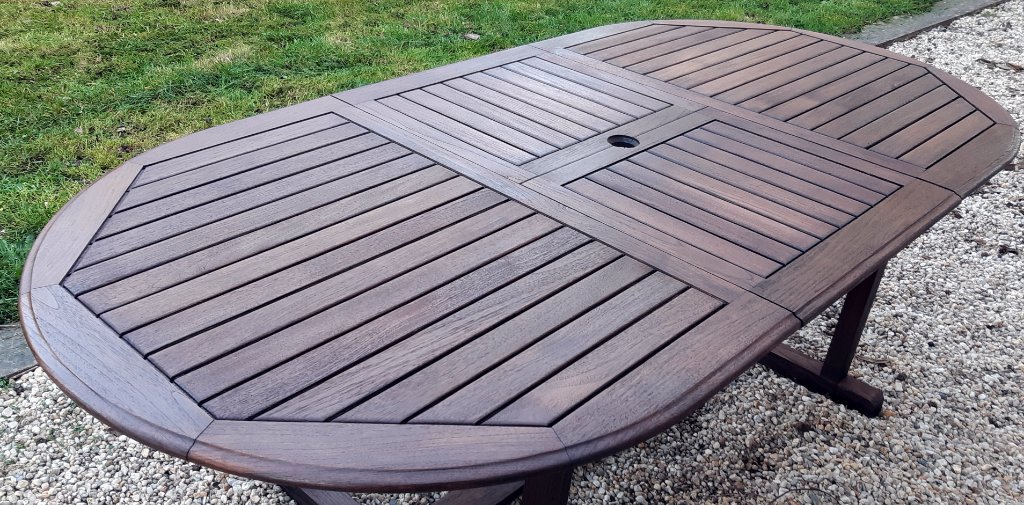

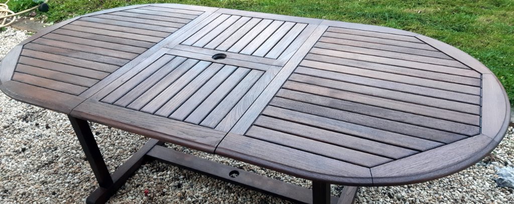

I brushed the teak oil, a first layer, but I think that for the moment, there will not be 36, because I have almost no more, and it will be very difficult to buy them and have them delivered to your home ...
Table jardin restauration - 04.jpg (209.08 KiB) Viewed 6547 times
Table jardin restauration - 05.jpg (149.86 KiB) Viewed 6547 times
It will wait a little ... or a lot ... depending on the situation.
