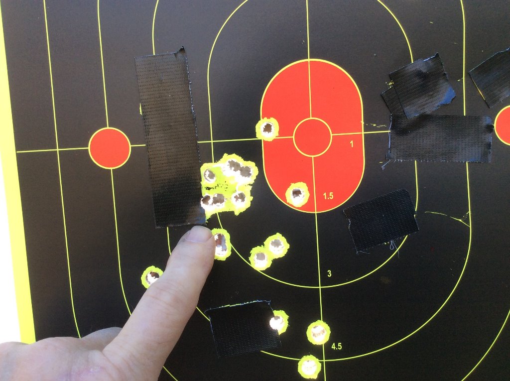

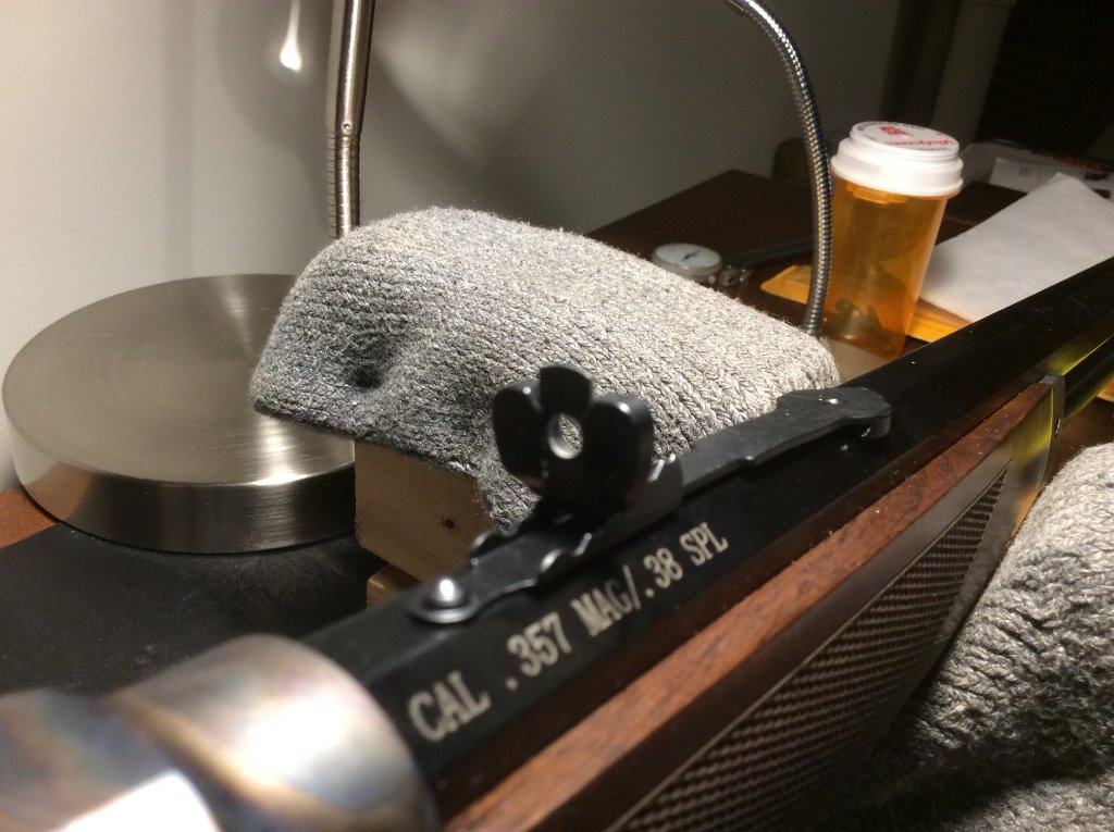

Made a run down to the range to test out this new .150 dia. hole insert for the rear sight on my .357 Henry BB.
After a couple of windage and elevation adjustments I got it where I wanted. Seems to work better than the stock V notch when
you want to easily see your front sight bead in relation to target.
Target shot from 25 yds. standing I wore a nice hole just off to left and then adjusted the windage a bit to help center it in the red.
Took a shot or two and called it good! Then moved on to just plinking cans and that 3 inch steel target from about 25-30 yds.
I like the results! https://youtu.be/jPYte2JoHdI Hope the video is clear enough!

Post by BigAl52 » Sat Feb 22, 2020 6:45 pm
Great idea I think. Kinda hard to see the targets. Any chance you could move the camera closer 40?

Guess I should have zoomed it in a bit! Is the video a bit blurry? Don't know whats up with youtube?
Seems like my Ipad is only good for 240p at best plus that sun is always playing with the images. Have to start using the GoPro again I guess.

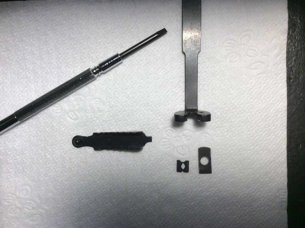

All my previous mods have been to the factory insert and the newest .150 dia. hole insert will slip right in locked in place with the screw on side.
I actually made that insert from a piece of hacksaw blade and ground to fit. Took about 10 minutes of work!
I like it!
I enjoy seeing hand-done repairs & modifications as opposed to always reading about a rifle being sent back.
