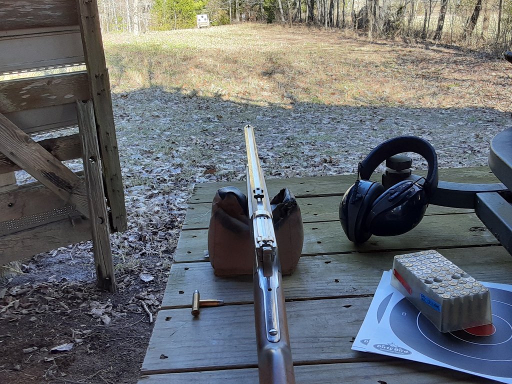

Well several of y'all have been playing with the 180 gr pills in your Henrys.
This morning I decided to try a couple different loads with some 180's i have.
Down behind the barn with the Rossi and it's 24" barrel.
I have shot a lot of Blue dot through this rifle.

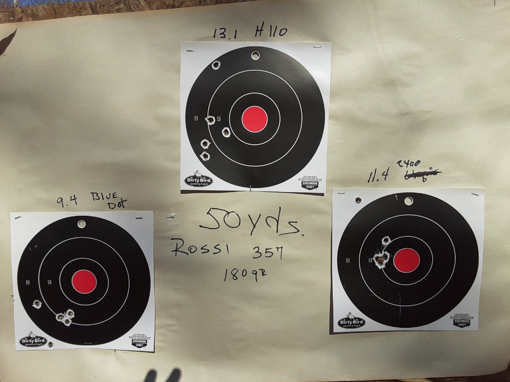

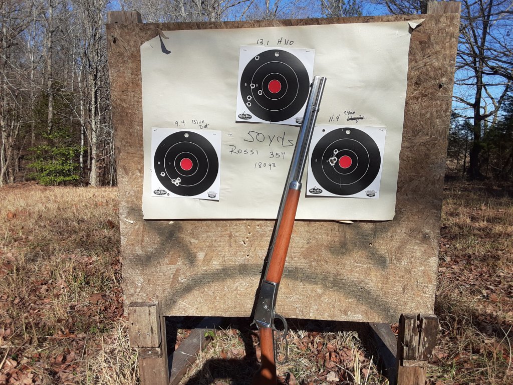

Looks like the 2400 had a slight edge over the BD. :lol:
Five shot groups from the bench at 50 yds.
9.4 grs Blue dot
11.4 grs 2400
31.1 grs H 110.

Hmm, wonder what you may be changing to? Good for you Randy. Some nice shooting and fine looking rifle there. What are the 180's you used? Thanks.

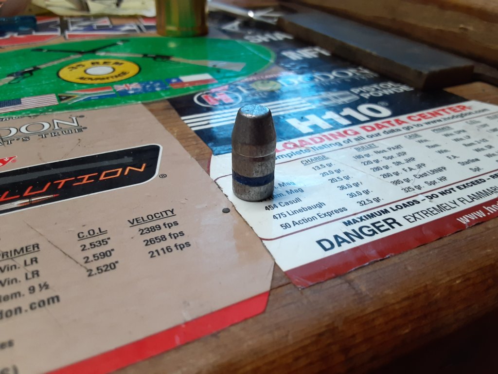

Must be nice to shoot behind the barn. Nice shooting Randy. Are those the same red head bullets Tom And I are usin

Oh by the way that rifle is way to shinny to be at Randys house

Al, I bought these a few years back, came from Texas.
Bought like 500, down to less than a hundred. Not sure what they are.
Guess I need to start looking for some replacements.
What are the ones y'all be using?
Re: Another 180 gr 357 test
Post by Rifletom » Sun Jan 05, 2020 3:04 pm
Randy, Missouri Bullets, 180gr "Striker" rnfp, coated. They work real good!

Great shootin' behind the barn! 2400 is a great powder for heavier bullets for caliber. Nice looking Rossi too!!
