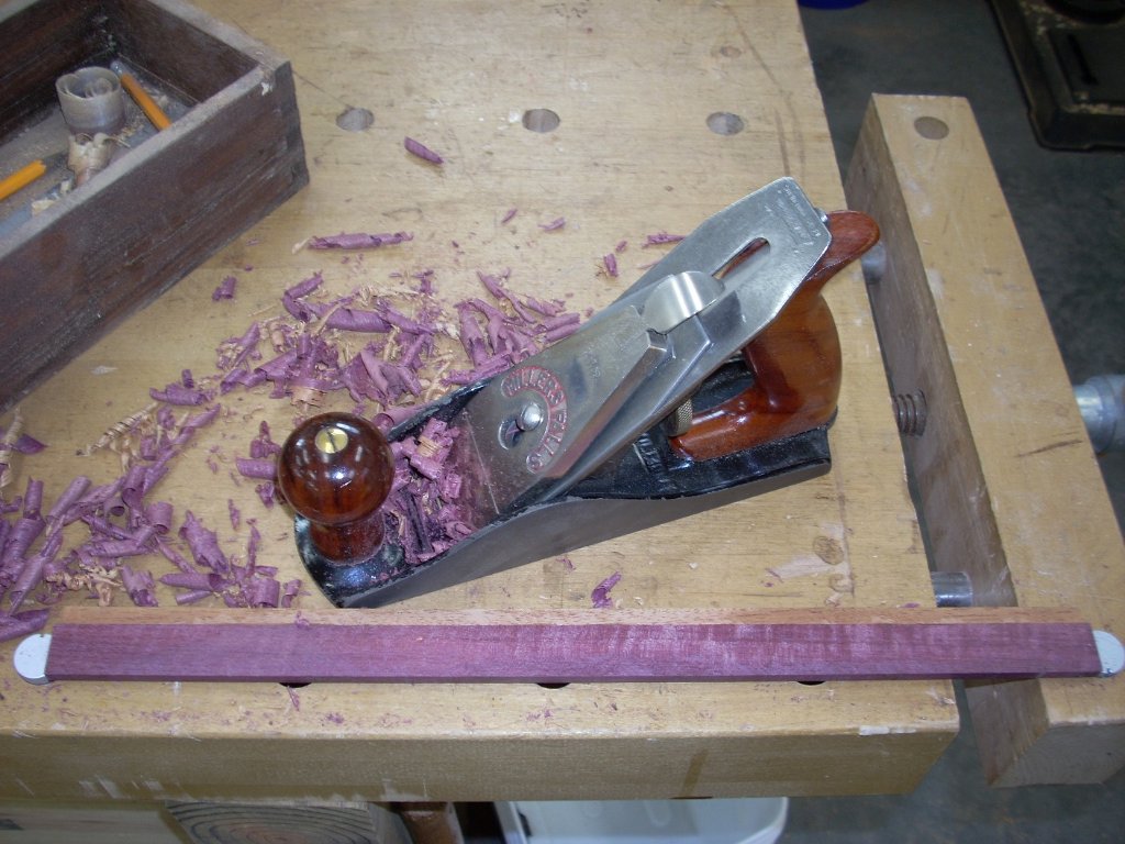

Came back out and took the strips out of the clamps and found that I needed to trim the sides. TOO thin for the jointer or the planer. Hand plane.
01 planing the purpleheart strip.jpg (182.56 KiB) Viewed 6995 times
Beautiful hand plane and sharp as a razor, but, it still reminded me that I had a boo boo shoulder. :twisted: I got all four sides done on the two strips and they were good to go. Test fitted the layouts and put them in the clamps and applied pressure.

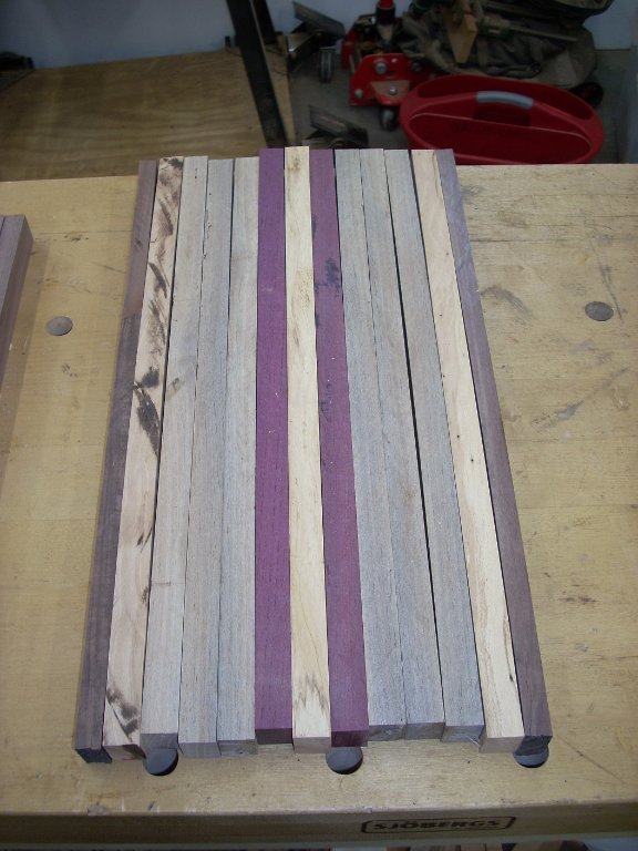

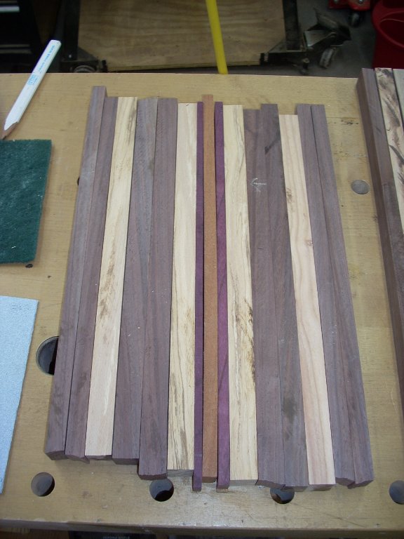

Layout one consists of Maple, walnut, and purpleheart with a mahogany strip for accent down the middle.
02 layout one.jpg (110.95 KiB) Viewed 6995 times
layout two is Walnut, maple and pecan with Purpleheart accents down the center.
03 layout two.jpg (114.43 KiB) Viewed 6995 times

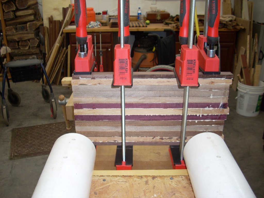

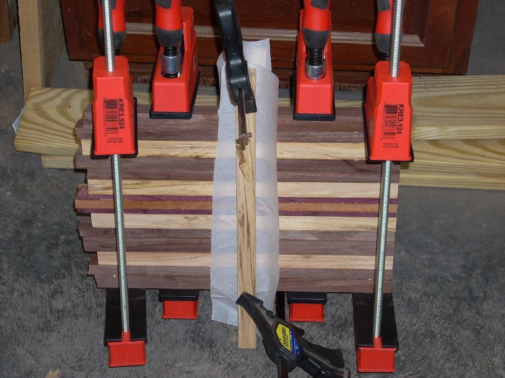

After clamping pressure was applied to test the fit again, they were laid out, glued up and clamped, and left overnight.
04 clamps one.jpg (197.28 KiB) Viewed 6995 times
05 clamps two.jpg (163.1 KiB) Viewed 6995 times

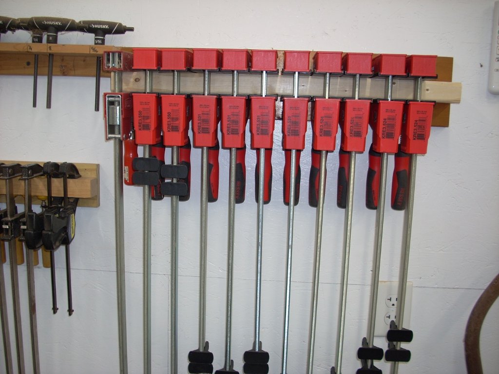

The clamps, are back in their places.
07 everything in its place.jpg (163.76 KiB) Viewed 6995 times

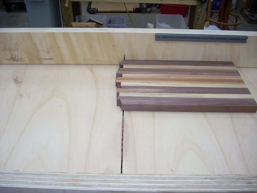

First up, I needed to trim up the ends of the "boards." To do this, I needed the Sled for the table saw. This thing is a little over the 5 pound weight the doc told me to try and stay under. So... I kept it low as I moved it from it's place at the end of the corner bench and then tilted it up and slid it onto the table saw and slid it over til it dropped into it's slots. Easy Peasy. 8-)
I aligned each edge and made a single pass to trim up the ends. On the one cutting board I had to cut off about an inch and a quarter due to a chunk missing from the bottom of one Slice of Maple. :twisted: These things happen. Luckily, it was at the end of the board and I didn't have to FILL it in. :? Here is a view of the SLED. I made this several months ago, after needing it over and over (and over) again all these years. Makes accurate cuts for those items too big for the miter bar SO easy. Yes, this one is big and heavy, but that makes it stable.

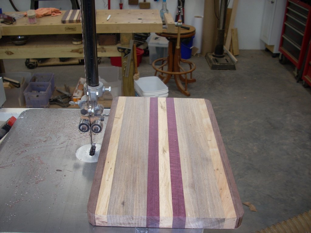

Next step was to mark curves on the four corners of each board for cosmetics. I used a lid from a pill bottle. I keep them in the shop to mix adhesives in, for small amounts of glue/paint, or whatever. So now, they are used as corner templates. You never know. Then, I set up the band saw, and cut close to the lines, but not too close. I didn't want to change to the 1/8" blade, and the 1/2 inch blade on the band saw wouldn't make the turn. No matter, I was going to finish the corners on the disc sander anyway.
09 bandsaw.jpg (148.7 KiB) Viewed 6922 times

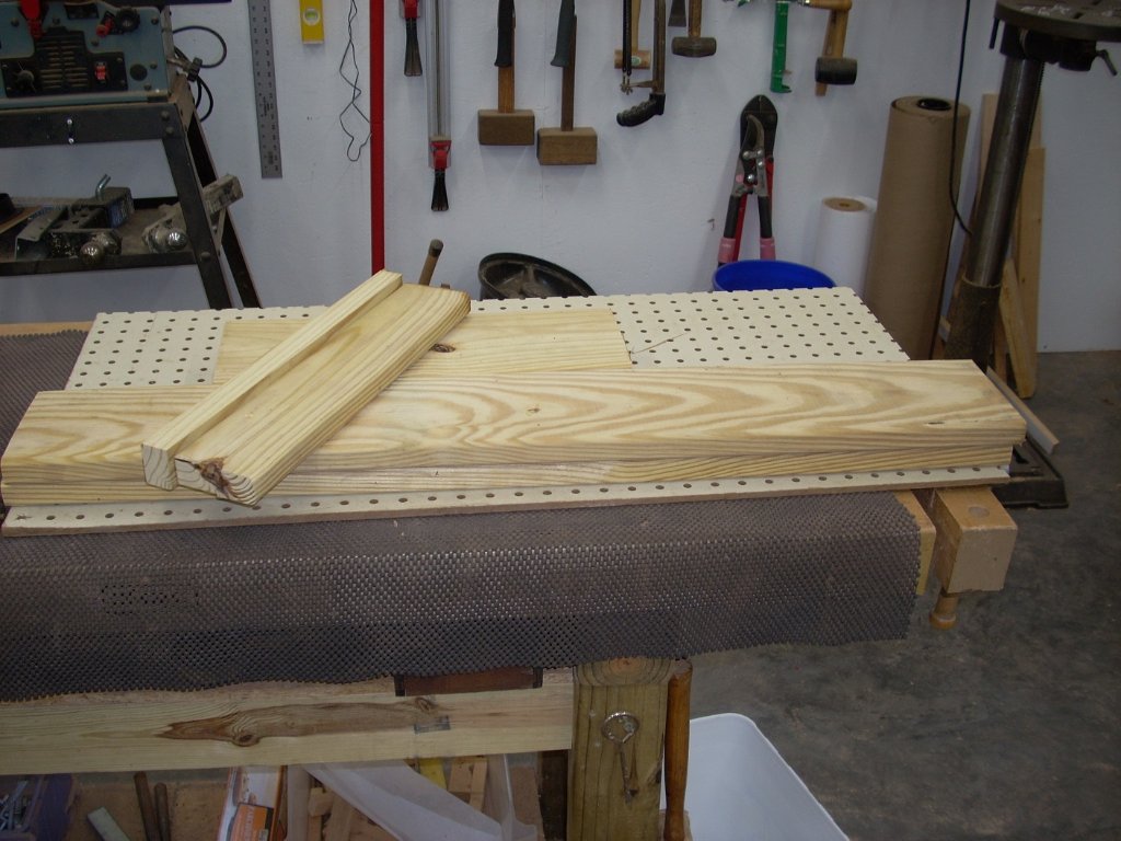

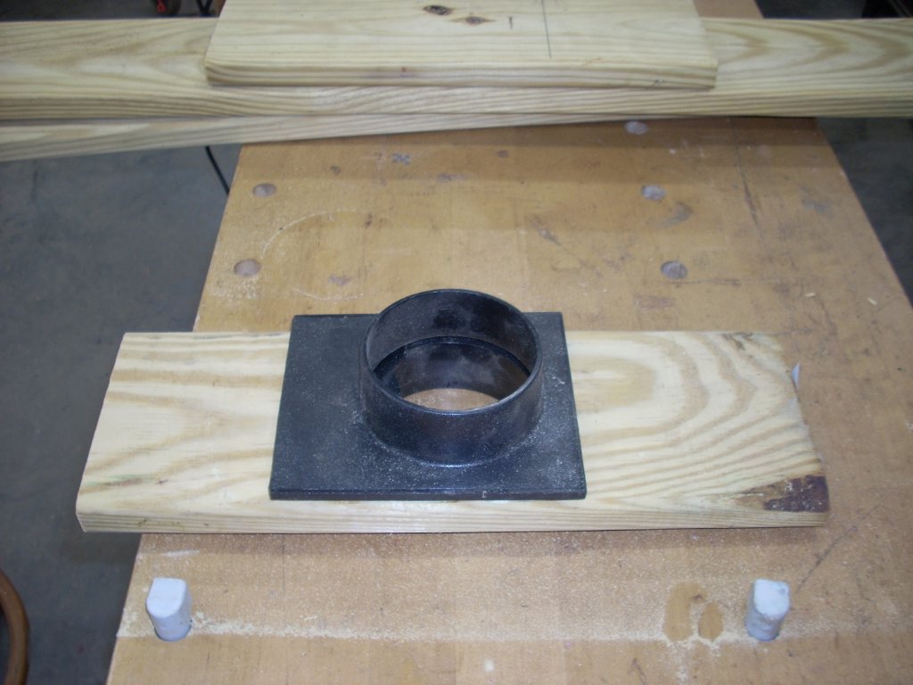

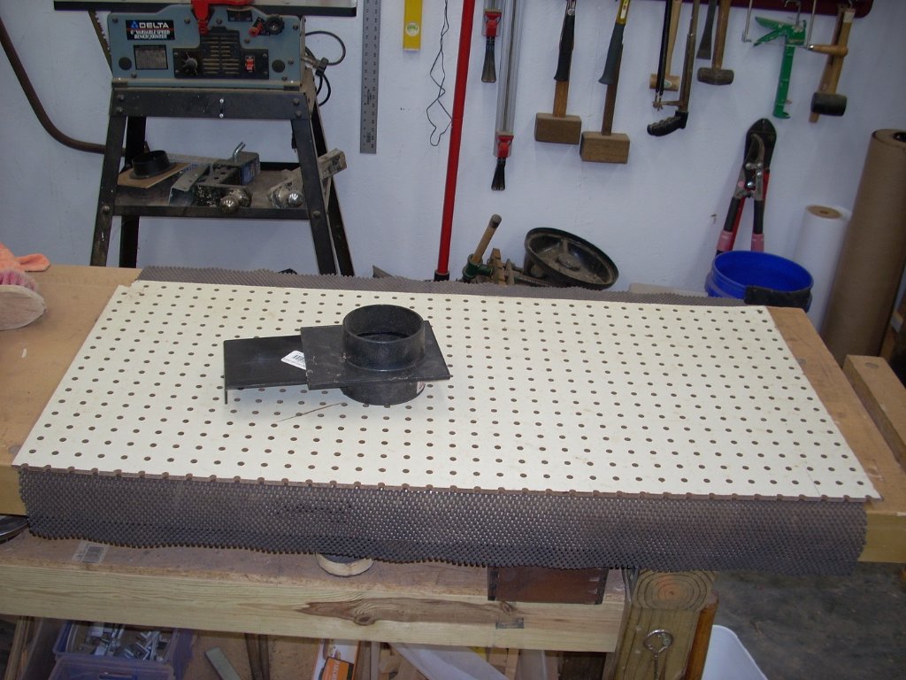

The first step was to pull the Peg Board for the top, the Flow Gate that will allow the dust collector to be hooked to the box, and cut the Decking Boards to length to form the box and internal braces.
Peg Board and Flow Gate:

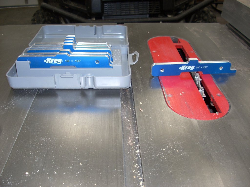

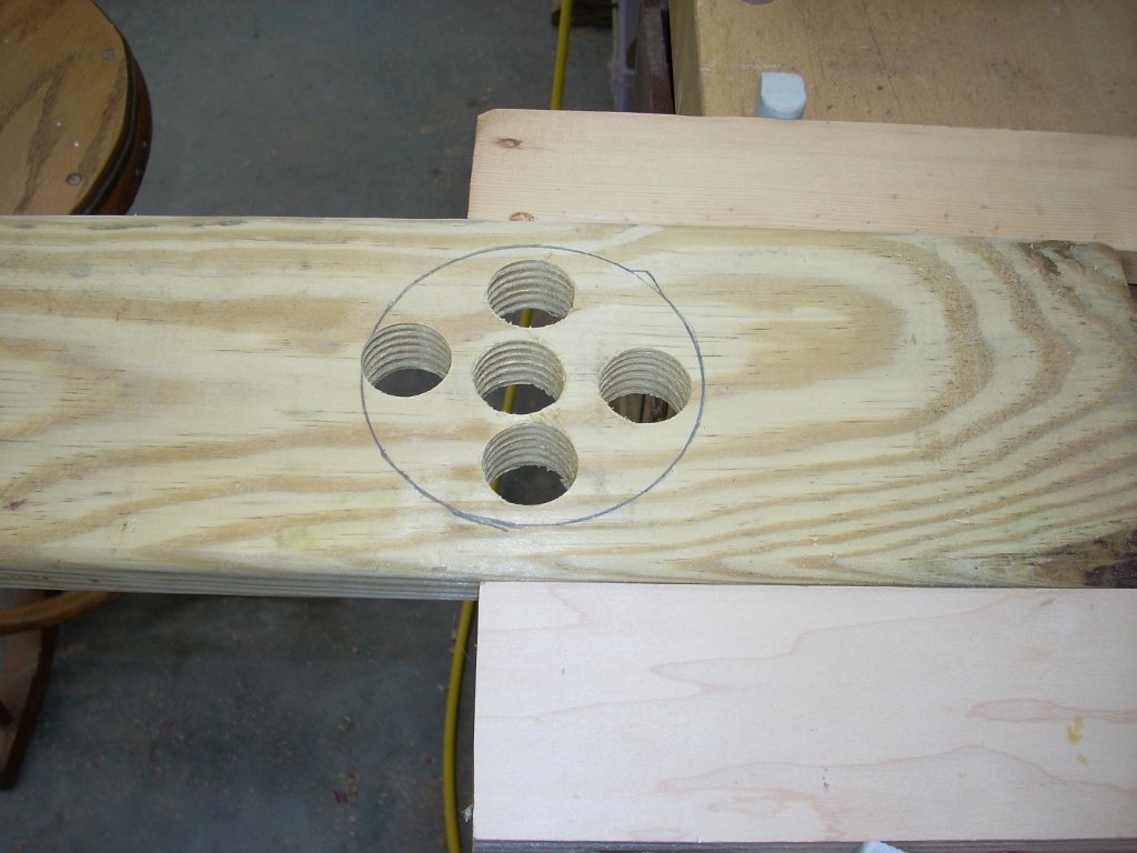

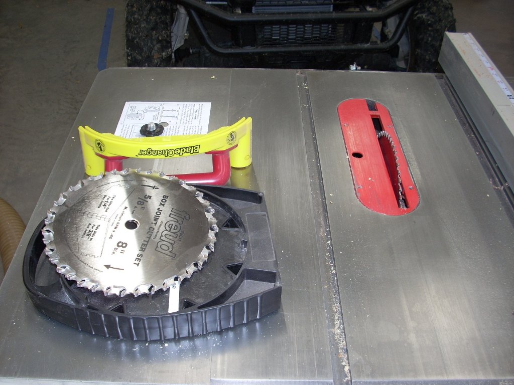

Next step was to set up the saw with the dado blade to cut the rabbits to allow the peg board to sit flush on the top of the box. I swapped in the dado blade set at 1/4 inch, then used the Kreg Setup Bar Kit to set the depth of cut at 1/4 inch. The Kreg Kit was one of the tools I recently added after seeing it in a youtube vid, I have used it a lot.
13 dado blade.jpg (174.09 KiB) Viewed 6895 times
14 set up bars.jpg (168.17 KiB) Viewed 6895 times

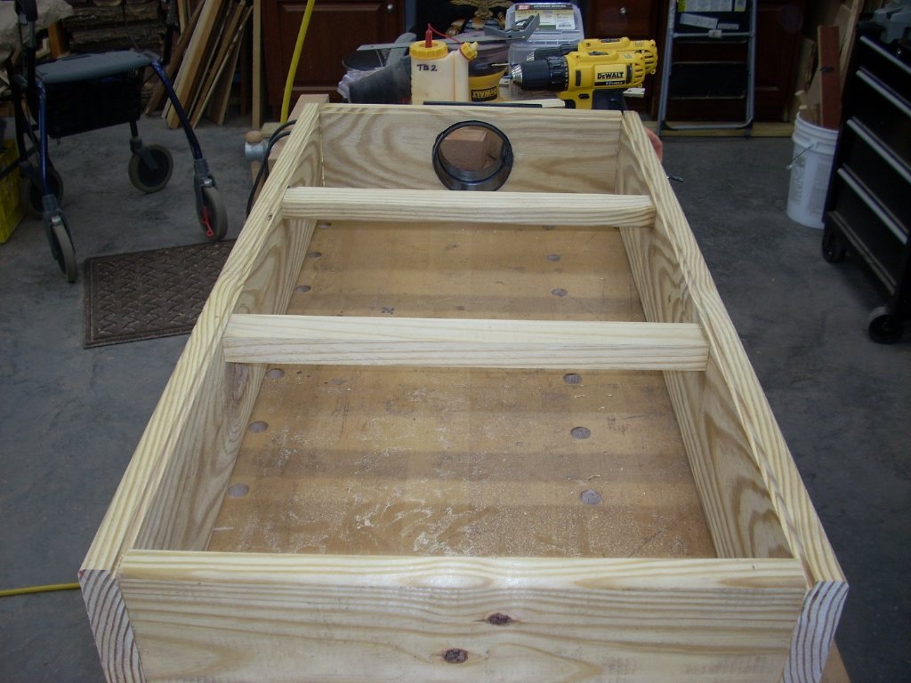

We were ready for assembly. The main thing to keep in mind is that the rabbits all had to be level and aligned. I used the clamps to hold things tight and a mini pry bar and mallet to bring each corner and top edge into alignment. Then screwed that top corner. Tapped the bottom into place then screwed that into place, then a center screw for strength. On to the next corner and repeat the process until the box was assembled. Then cross braces even / level with the rabbits for additional support for the vented top. The top will be supporting the weight of items being sanded. A brace across at every foot. I checked the box for square and left it for the glue to set up.
17 glued and screwed.jpg (164.39 KiB) Viewed 6895 times

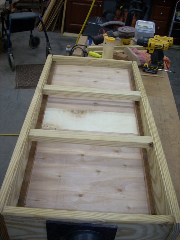

Last shop visit, on Monday, I got the angled bottom done as planned. This reduces the volume of the interior of the box and increases the power of the suction of the dust collector, improving the performance of the collection. (In theory.) We shall see.
The bottom:
19 angled bottom.jpg (107.46 KiB) Viewed 6851 times
Comes out a bit under the intake for the collector, then angles up so that at the final point it's about 1-1/2 inches below the top.

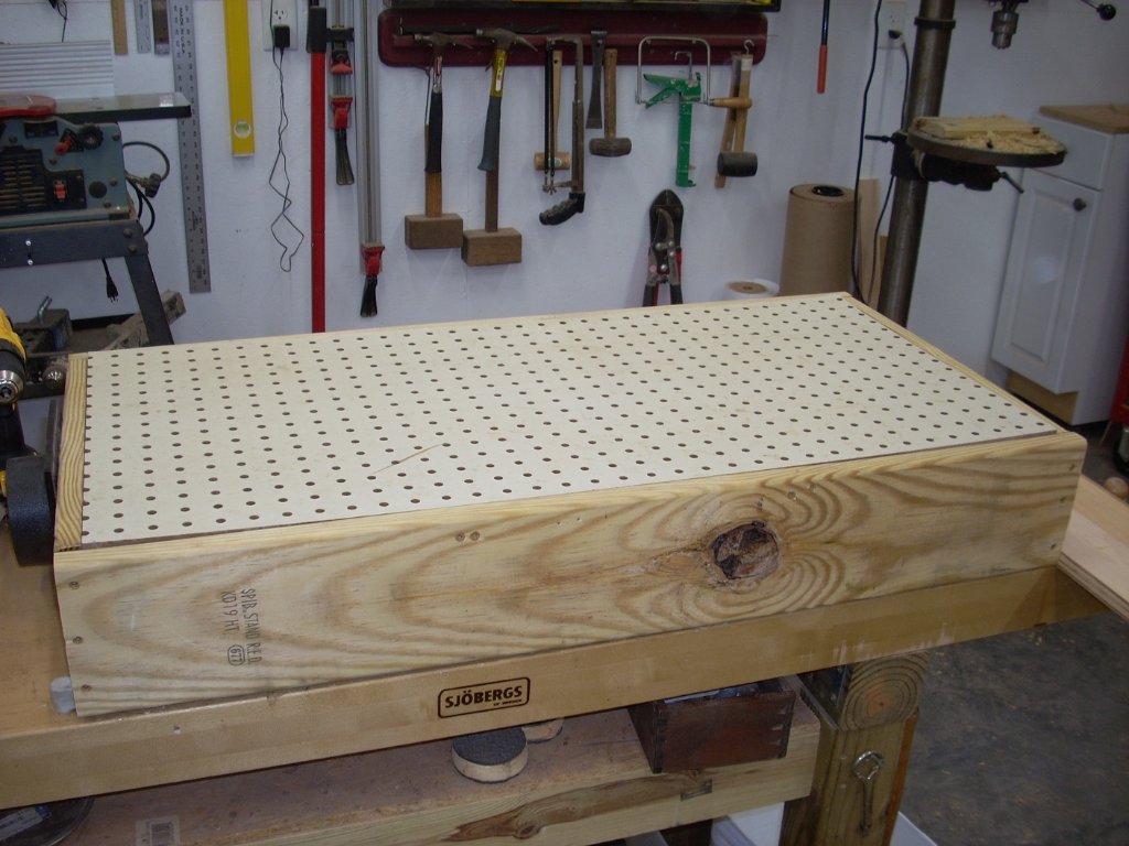

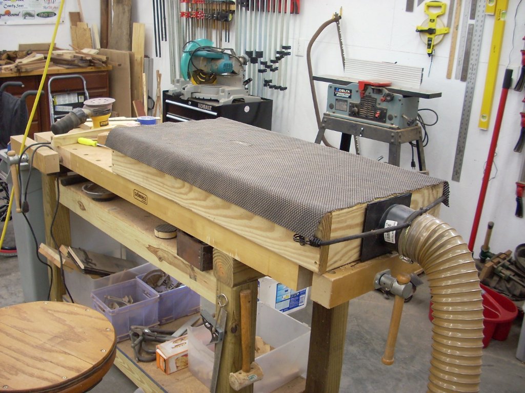

This is the sanding box ready to use. Note there are deck loops on the sides for the dust collector hose to attach to, and I spread my sanding pad on the top to protect the work being sanded. I'll test it this morning and see how it works. The only other mod I might make is to take a slightly larger bit to every other hole in the pegboard to increase the intake of the dust if it doesn't perform up to expectations. ;)
20 ready to go.jpg (207.1 KiB) Viewed 6851 times

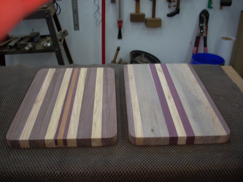

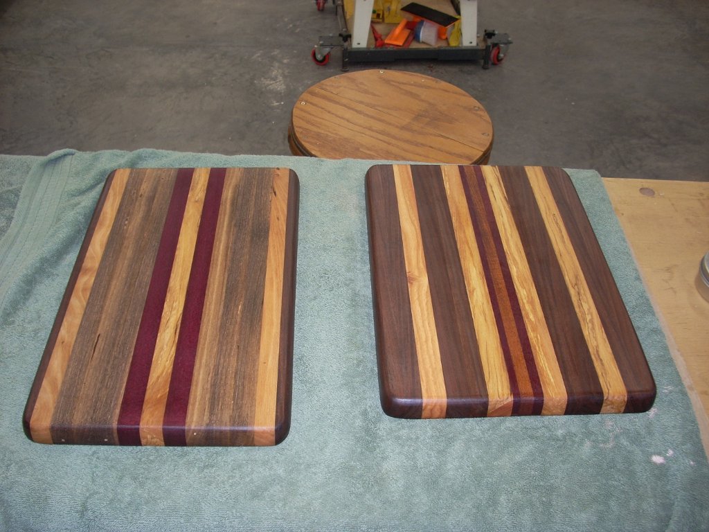

Had a lot of projects around the house to take up my time and haven't been back at these cutting boards for several weeks, but in the last two days, I did find the time to do more sanding, and to take the "step" off the side. I decided I didn't like that transition, so a half hour on each with a plane and it was gone. :) 80 grit, 120, 180, 220, and 320 gives a glass smooth finish. Then time to apply the mineral oil and BOOM, the grain leaps out.

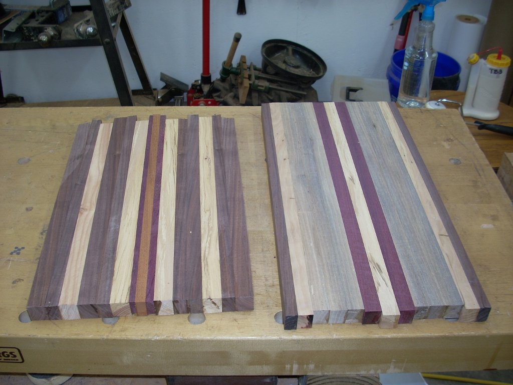

Can't decide which one I like best, but I am leaning toward the Walnut one on the right.
which one.jpg (192.11 KiB) Viewed 6224 times
The board on the left has a walnut edge, then mainly pecan, with some maple accents, with the purple heart strips in the center.
The board on the right is Walnut and spalted maple, with the purple heart and mahogany center accent. Yeah... my fav.
A favorite anyone? Anyone?
These have two applications of Mineral Oil, and two coats of beeswax/mineral oil buffed in. They will likely get one more coat of wax applied and buffed out. It will give them a light sheen. Then I'll apply the feet and we'll be done. Whoever gets them will get a small Tin of the wax/oil mixture. They are suitable for use, but most folks I have given them to don't use them, but put them on a counter with something displayed on them. :)

Amazing what you do Jim! Just hope you don't forget and over do it. I have been guilty of forgetting about the limitations/guidelines regarding my back, and have paid the price! I DO admire your perseverance very much though!☺

Both boards are beautiful, but the board on the right is outstanding and easily gets my vote. Thanks for sharing your skill and craftsmanship with us, Marine. I look forward to each new project and read every single post.

The one on the right.

Cannot decide,🤔 both are beautiful!

I'm a sucker for the purple heart. I am going for the one on the left. Both are beautiful. Wonderful craftsmanship!!
