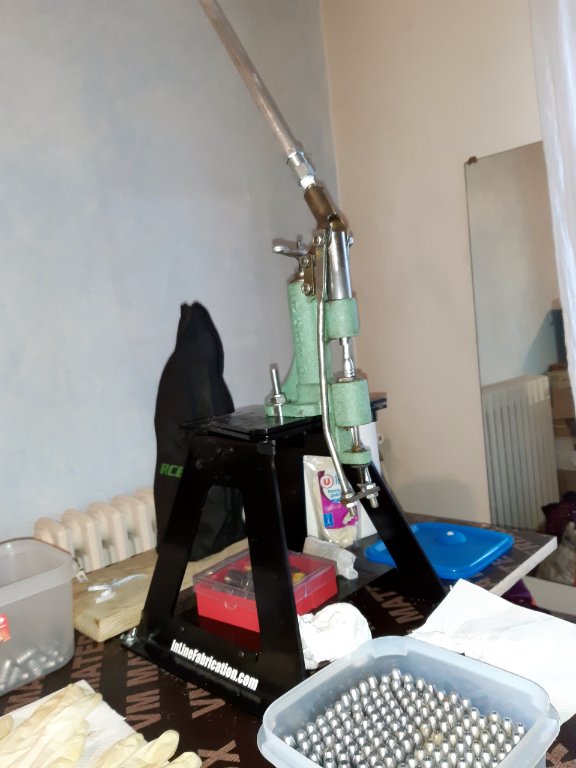

Yesterday morning , enjoying a really gloomy weather (he drops buckets of water here :-()
prepared fifty bullet 45-70 405 gr and a little more in 330Gr.
Some time ago, I was lucky to find a guy who was selling a used one for a low price. really not bad this tool!
sizer die and top punch can be changed , according to the bullet ...
the guy had lost the lever :lol: , I had to make another, but hey, at this price it was worth it. :)
Ultramount riser is extremely convenient to switch from press to lube-a-matic in seconds, or any other tool with their "quick change top plates" system.
It is quite expensive, but when you do not have a dedicated room and a large reloading bench, it is a rather practical saving of space.
and the whole is very very stable.

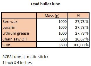

I make the lubricant stick from the following mixture:
bullet lube.jpg (15.72 KiB) Viewed 1962 times
It seems to work well ... and it's very inexpensive...

Brunix, Love the Inline Fabrication ultra mount and quick mount system. It is well made and worth every penny !
