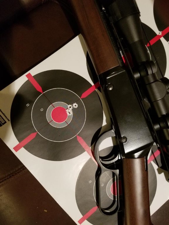

Here's my 50 yard group using CCI Mini-Mags.
