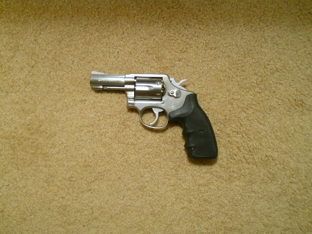

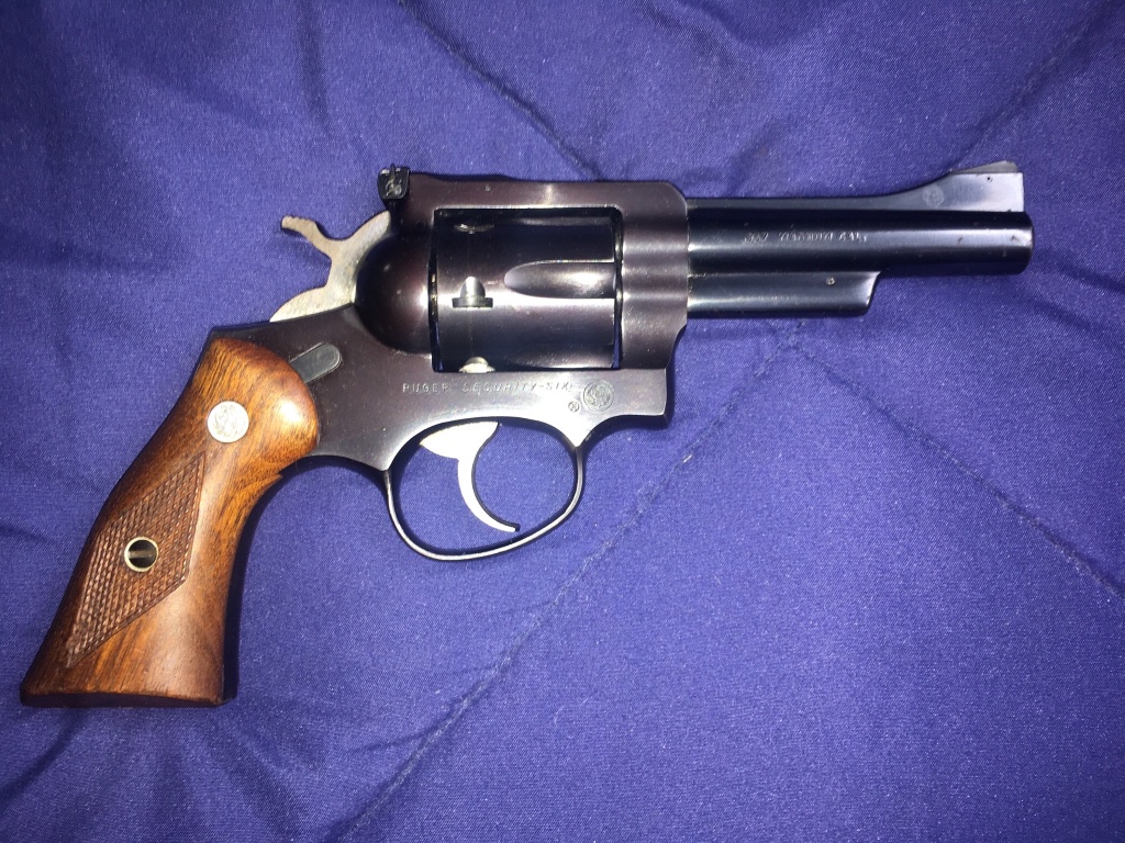

I would like to work on my double action shooting. I don’t do it often, and I’m terrible at it. If anyone has any tips on how to shoot revolvers well in DA, I’d sure appreciate it. My Security-Six would, too.

Nice pistola.

Nice older Security Six!
I had one once but it was really beat up, lots of the bluing gone and I sold it back to the original owner (who wanted it back)
I also do not shoot my DA revolvers DA very often but as a starter it would help to have some larger (and rubber) wrap around style grips for an improved grip on the gun.

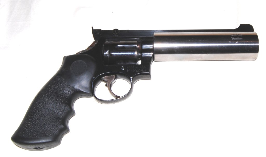

Marine, that is so cool. Love that mod on the trigger. May even try it on my Dan Wessons. I gladly concede that you are the real expert, here. Thanks for sharing.

Thanks, it's an easy mod, but most smiths will ask if it's a recreational or protection gun. It's NOT recommended for a EDC gun or a Personal Defense home gun as it can creep slightly out of adjustment if you over wear the allen screw all the time playing with adjustments because YOU can't make up your mind.
For a target or competition gun all it costs you is a second to make the adjustment and a few points in a match. (At worst.)
On a defense / protection gun you don't want to find yourself fighting the trigger stop and pulling hard to fire the shot, which would pull you off target. It would have to drift WAY out of adjustment to keep you from being able to fire the shot at all.
Hopefully you would have noticed in your monthly practice sessions before that happened... right.
