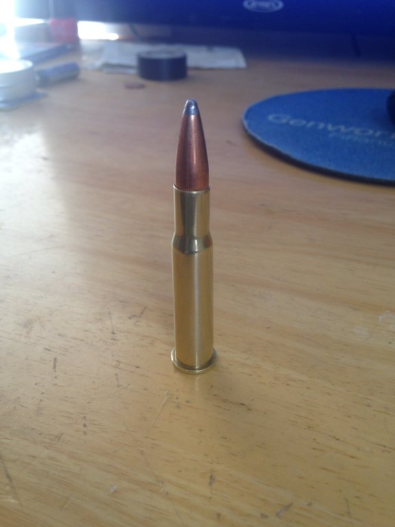

Take a look at this 30-30 round. See anything different?
Ok - it's loaded with a 150 grain Spire Point bullet.
I have been cleaning up my loading desk & re-arranging it and stumbled on a bunch of these I have no other need for so I loaded them up for my 30-30s.
Actually I have done this before and its kind of a fun departure for the 30-30 as the SP bullets will give a little more velocity, shoot a little flatter and give the 30-30 a little more effective range and will demonstrate how much accuracy your rifle is capable of. Some dedicated 30-30 hunters do this regularly knowing the advantage of a spire point bullet for hunting.
The DOWN side is it turns your rifle into a single shot as the extra length of the SP bullet will not feed through the tube of a Winchester - I don't know about a Henry but I suspect they most likely will not either. On the same 'note' loading single shot is not a so much of an issue if just target shooting, or even varmint hunting as well. Heck look how many OWN a single shot rifle. Just because it's a 'repeater' doesn't mean it needs to be!
Anyway if you 30-30 reloaders want a change of pace give it a try sometime!

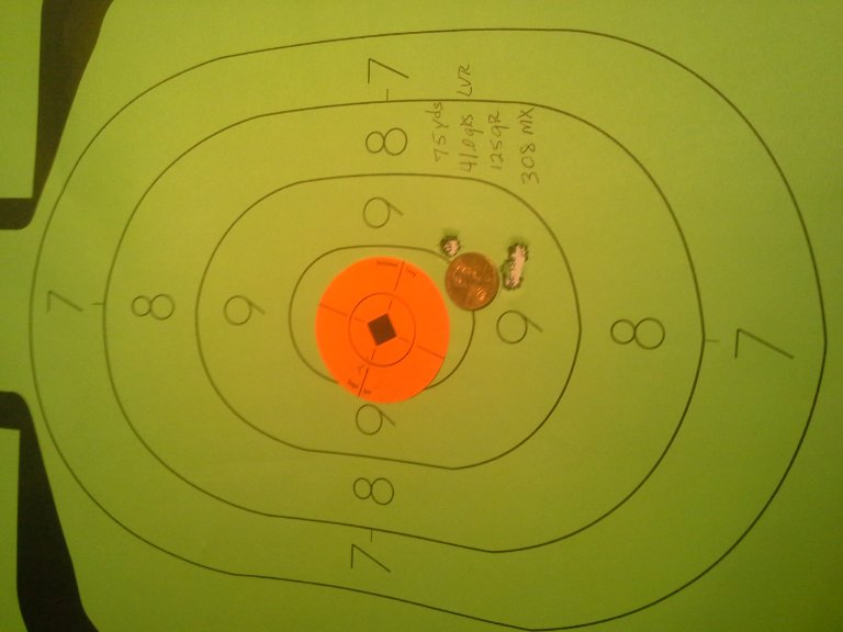

I've shot the 125 gr ballistic tips out of the MX before with good results.
Never tried to see how far, but at 75 yes. they sure grouped. :D

What powder recipe did you use for this, Ed?
Ramshot TAC right at 30 grains.

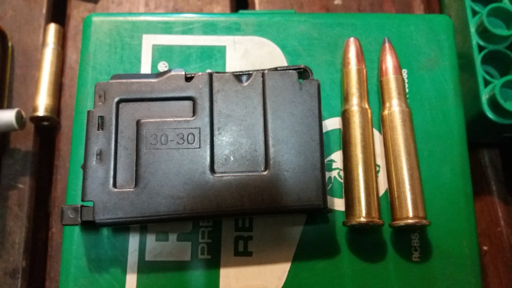

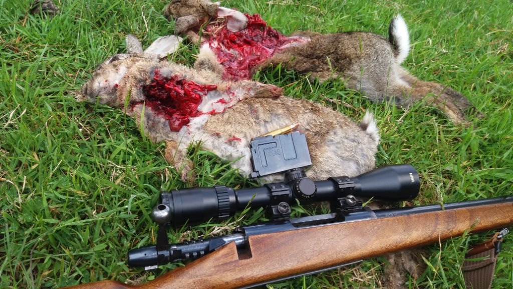

I tried trimming and loading 150 gr spire points for my 788.
But found the 160 gr Hornady shot better.
