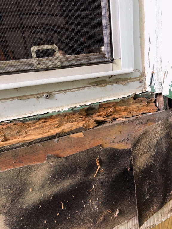

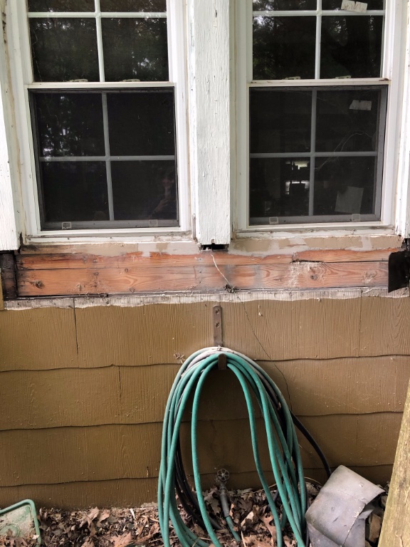

Have to paint the outside of the house this year and I have started on the fiddly stuff like scraping and found 1/2 of the sills have some dry rot. Fortunately it is a single story house and I made a trip to buy wood hardener, putty, epoxy, and some cedar planking. So..... tomorrow morning before the rains start again I will see how deep it goes on the kitchen windows and start the adventure. Already pulled a tick out of my hair, maybe I should get a collar. The good news is I get to use my table saws and planer again. It has been too long.

Working on kitchen windows. Cut out rot, worried it down to firmer wood, coated with wood hardener and now another trip to the lumberyard. Going to fill with epoxy putty, sand and attach a new piece of sill. Had to order siding to fill in broken shingles that will take a week to get but it may take me that long to finish this section and be ready to move on to the next set. Hoping to learn along the way so it speeds up some. Only five more to go.Watched many videos last night and they make it look sooooo easy.

Put the final skim coat of epoxy putty on and called it a day. Will give it a last sand and cut out the sill replacement to glue and screw into place next time it is not raining. Scrape, sand and prime the remainder of the window before moving on to the next one. Pretty impressed with the epoxy but think I will try another brand to save some cost. The JB wood hardener worked well and I may get the Jamestown epoxy wood conditioner to further seal the rest of the wood before priming. Used Jamestown products on both boats and like their products.

Finished repairing the damaged windows today, ordered fibre cement siding from Home Depot to replace cracked and broken shingles, and have to round up all the stuff for the paint sprayer. Took me 4 days to roll and brush last time so I am hoping to cut that in half with the sprayer this time. Hard to say, it takes me a lot longer to do anything these days.

I enjoy figuring things out but I have to think it out before I tackle it, read about it and learn as much as I can. It was with some trepidation that I grabbed the recipicating saw and cut out the old sills. But once out it was just a matter of fashioning new ones and glue, screw and foam in place. Of course the first one was wrong but learned from that one and the rest when pretty well. I get satisfaction from accomplishing these projects. Patience I have, it is time that is hard to come by. If I was retired I could get my chores caught up but if I was retired I could not afford to do my projects so more patience.
