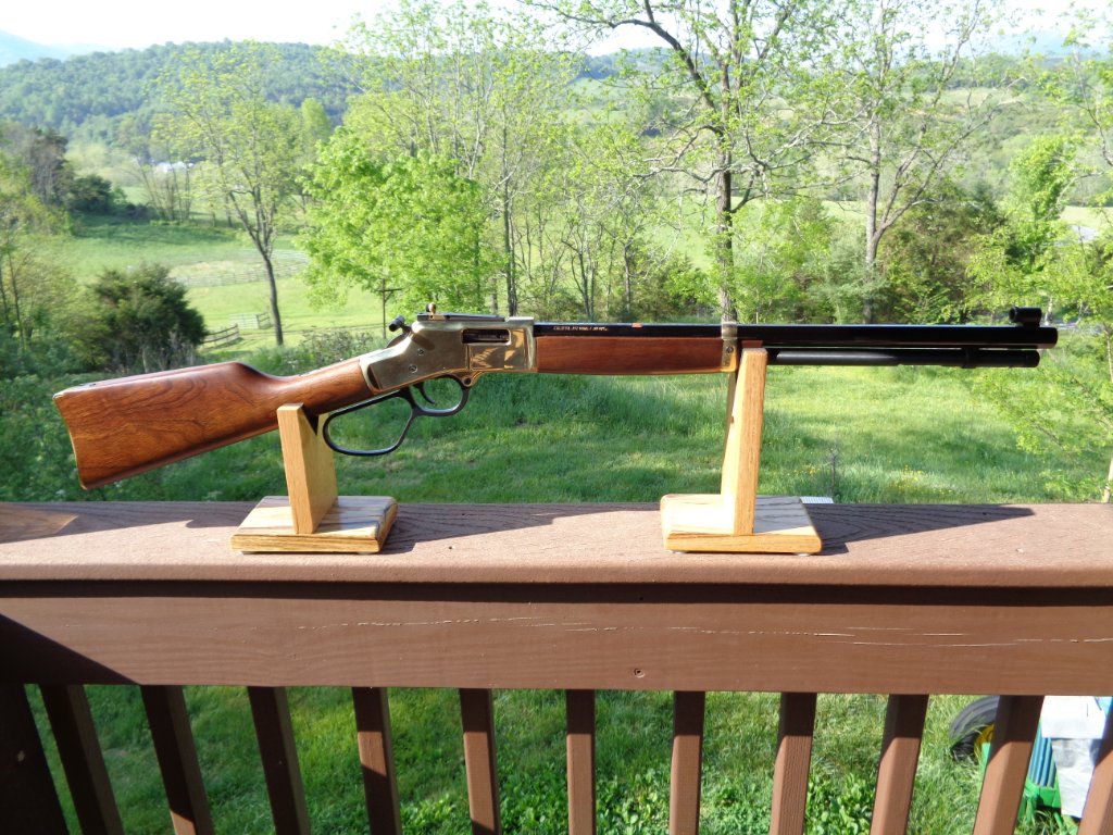

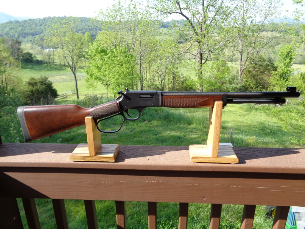

We have a Skinner Express/Lyman Globe on a brass BigBoy 357Mag and a Skinner Low-Pro/Lyman Globe on a CCH 357Mag BigBoy Carbine and steel 44Mag BigBoy Carbine. The Globe sight on the BBB357 is a .495" Lyman 17A. The Globe sight on the Carbine is a .404" Lyman 17A. Lyman 17A Globes come in heights of .404", 495". and .584". My guess is that you would need the .495" version on a BBS357mag with a Skinner Express, but the failsafe method to find out is to mount the Skinner rear sight and then shoot the rifle to find out how it sights in with the stock sights. From there you can calculate what height front sight you will need to work with the Skinner - you want to put a front sight on that ideally will work with the Skinner's stem a couple of turns off the bottom position.Michiganshooter wrote: ↑Mon Jun 10, 2019 9:32 pmtractortad - IIRC, you posted a photo of your set up with globe front sight. I have one on a H E A under hammer rifle (muzzleloader) and I will get that rifle out and see how I do when sighing with the glove - I restored the rofle and haven't shot it in a long time - like many years - IIRC, it has just a single rectangular post insert. Can you expand a little on your set-up? Is it on a 20" barrel and how did you detrain which globe sight (height wise) to go with? What insert do you use in the globe?
We use Lee Shaver inserts in our Globes - they give a much "finer" picture than the inserts that come with the Globes from Lyman. I personally like the cross-hair inserts that Lee Shaver makes.

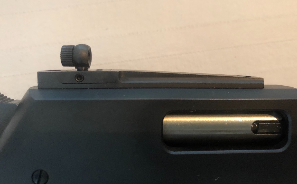

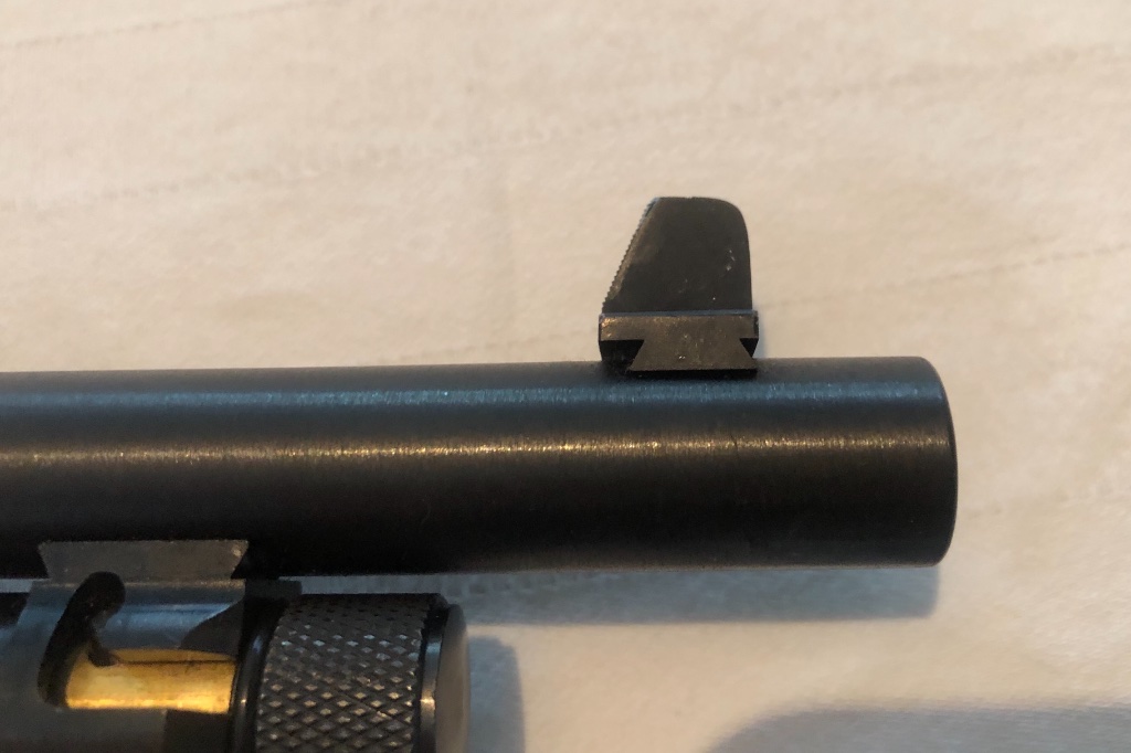

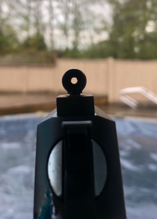

I’ve got the Express and Skinner’s front Patridge on my .357 BBSC. The front blade is 100% better than the stock Henry sight when used with the peep. It’s a much crisper sight picture. I’d order both front and rear together.
- BF62D979-4C44-459C-8D08-054ADD99596F.jpeg (77.08 KiB) Viewed 7080 times
- 3A4E8AE4-0C8F-4069-BE9B-37748C005CE6.jpeg (123.83 KiB) Viewed 7080 times
- 2808F443-EDDC-4EC3-AC23-2B9E5724CE6A.jpeg (133.19 KiB) Viewed 7080 times
