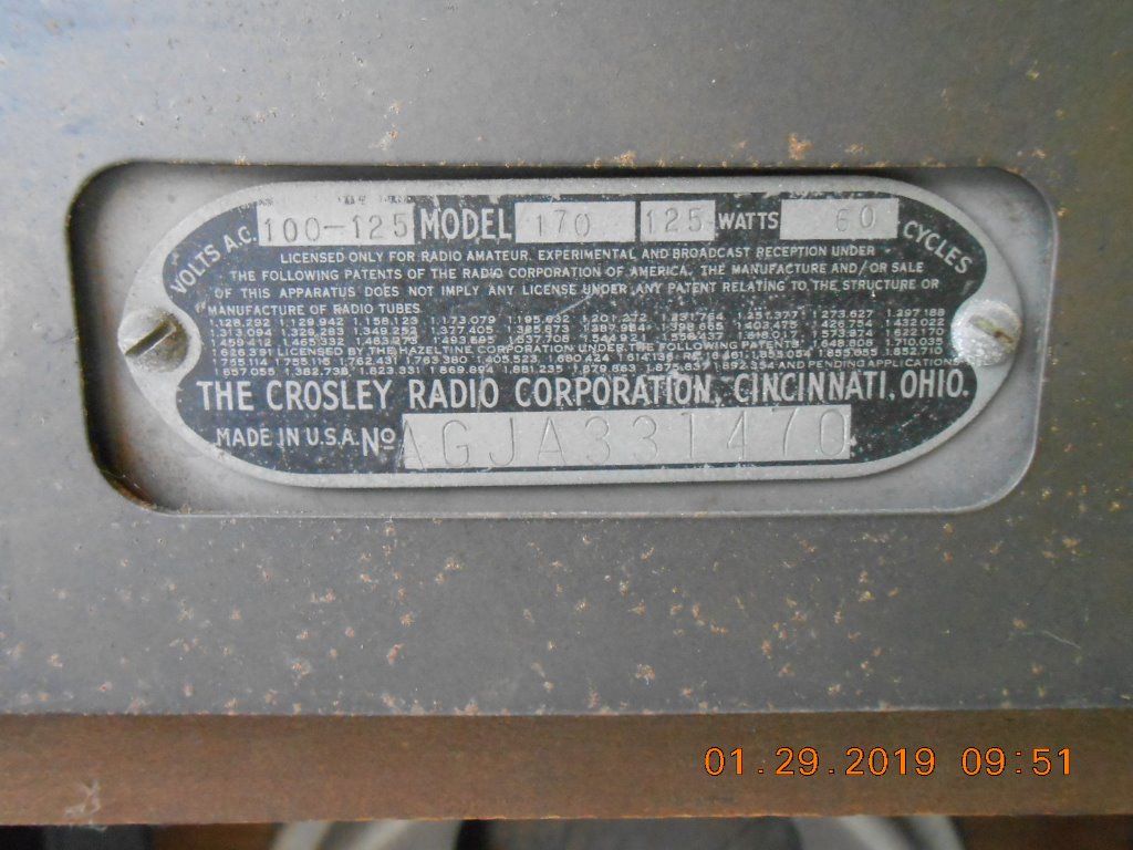

When I was in grade school, I had fun visits and sleepovers at my Grandmother's house -- my Dad's Mom, and she lived next door to our house. Many evenings I would sit and listen to this console radio with her in the living room. No tv yet. I'm thinking my Dad got this for her sometime in the 1940s, so it is possibly is in its 70s; definitely older than me!

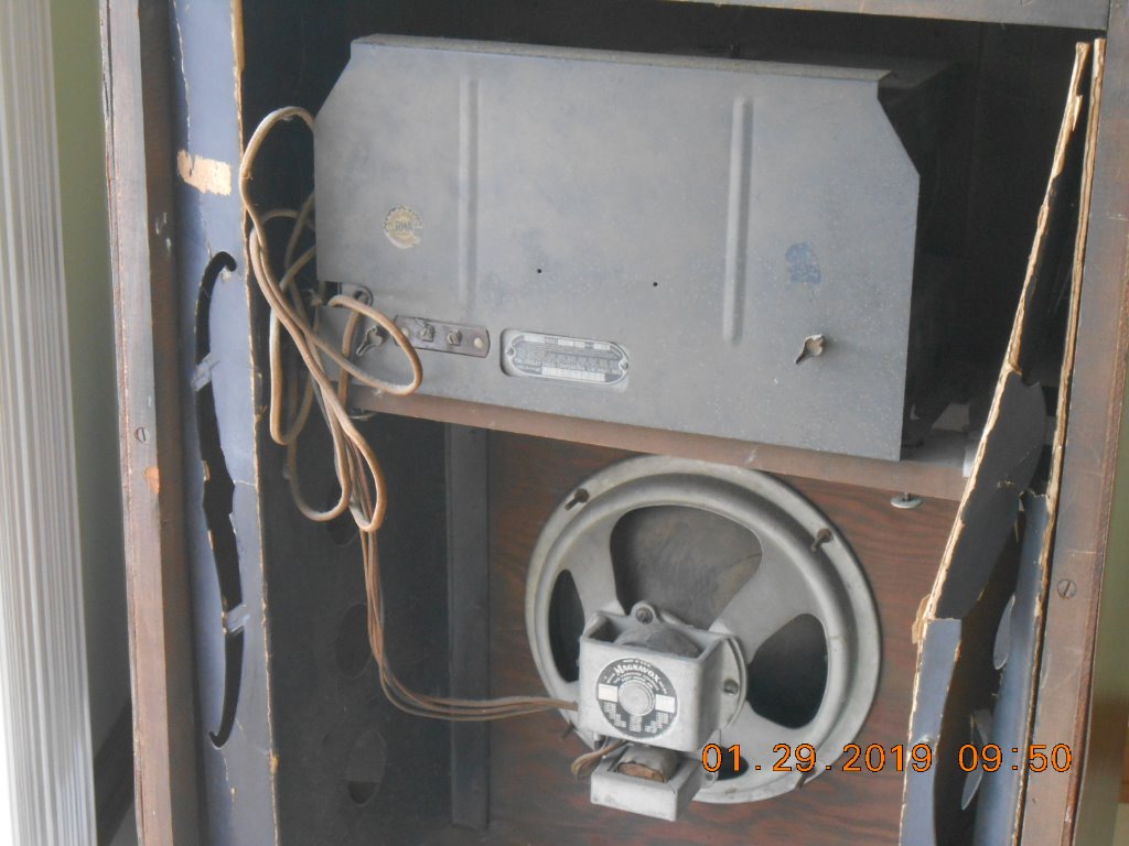

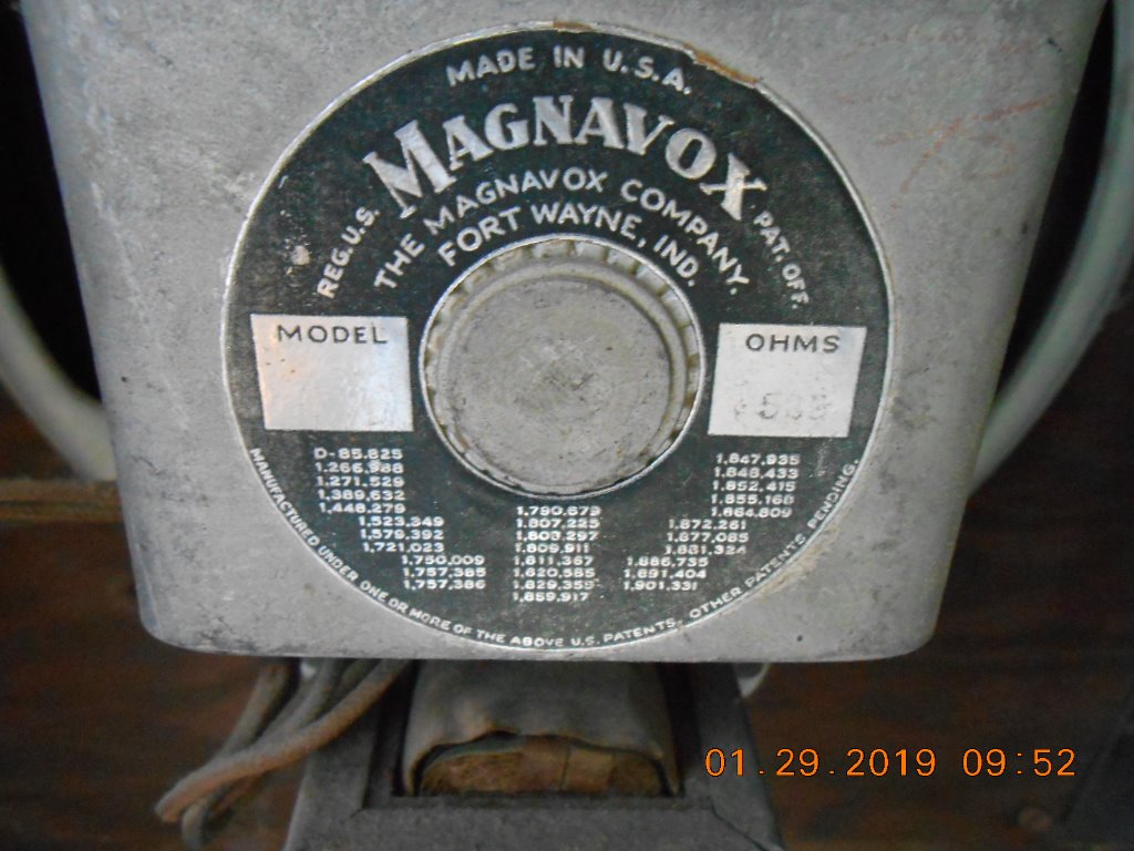

It is a Crosley tube radio with a Magnavox 8" speaker. Tubes are still inside. As you look at the front, the small frame above the knobs is the station indicator. Still is connected and smoothly turns both directions. I remember how cool it was to look at when darker in the house, because it even lit up! Everything made in the USA (Ohio and Indiana).

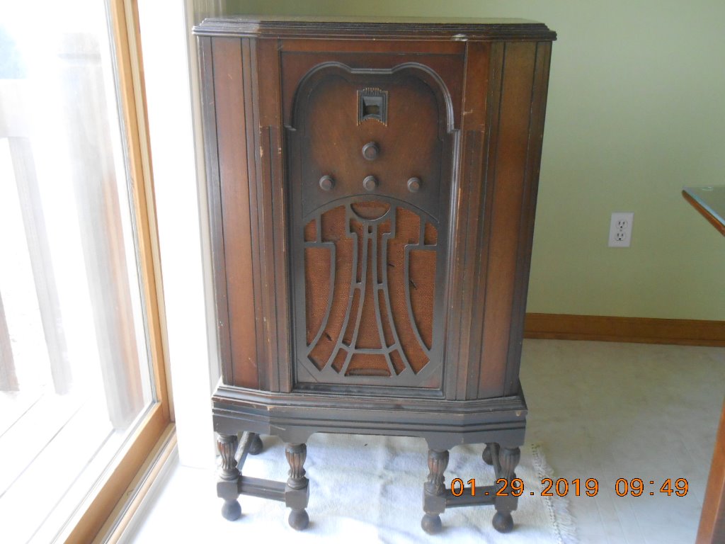

That's my memory, and a little family history. My plans are simply to make look as new as possible again. Shouldn't be an arduous task, because I think it already looks pretty darn good for its age. It also traveled/moved with my wife and I all over the country for my various job positions: IL-->KS-->OR-->IA-->IL-->WI-->back to IL-->KS (with my daughter I'm now living with)-->now here in KCMO. These pics are the "before" pics.
After I clean all the storage dust and cobwebs off it, I'll introduce the console to Renaissance Wax. They should get along just fine. I hope the results make the wood glow! Then I'll post the "after" pics.

You'll need to clean the wood well before you put any wax on it. I'd recommend Formby's Build-up Remover available at most home improvement stores or via Amazon. https://www.formbys.com/products/buildup_remover/

Along with bringing to our house this console radio, my daughter brought my wife's 60-year old wood dining room table, 5 chairs and 1 captain's chair. All were very dirty from the 6-years spent in the storage unit; much worse than the radio. Anyway, my daughter has a wood cleaner and wax remover she has often used called "Murphy Oil Soap." I spent quite a few hours using that "soap," and the entire dining room set turned out very, very good. So I'll probably start with it again on the console radio.

Murphy's is ok if the finish itself isn't damaged, but since it's water based it may raise the grain where the finish is worn thru or damaged. I would also not use it on a shellac finish. Don't know what the finish on your radio is, but could be shellac, since modern finishes were still pretty rare back then. Could also be a varnish or a nitrocellulose laquer. In either case (formby's or murphy's) always test it first on a small spot that won't be noticed.
This will help you identify the existing finish.

Appreciate the "tests" to help possibly determine what an old finish is. I now plan to do that before anything else, Gunny. The wood console radio has been in our family too long to not keep it in excellent condition.

You're welcome. Btw, there's no real "test" for varnish, but if you don't get any reactions from the previous tests, it's likely a older varnish formula (before polyurethane), and you can proceed how you wish without worrying about damaging the finish. The caution about water raising grain in damaged or worn areas where bare wood exists, stands however.
