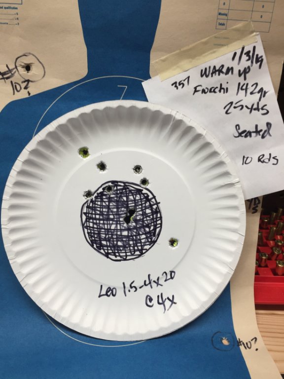

The first target (paper plate on silhouette, 3 layers deep) is just a warm-up, or “control group” of 10 rounds of 142 gr Fiocchi flat nosed at 25 yds, just to see how things might go. As you can see, not a great start. Nothing great about the group as a whole, with one huge flyer. So far, so so-so.

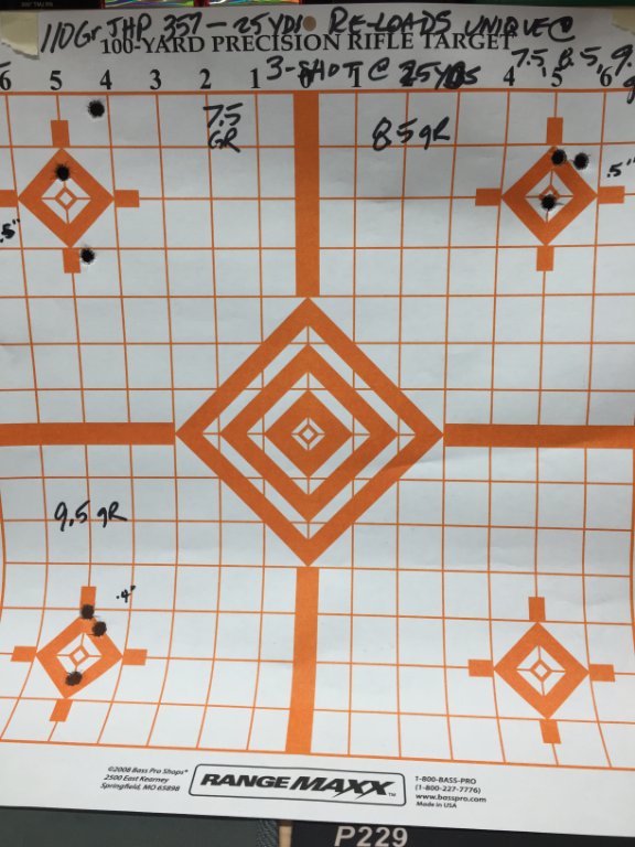

Next target down is 3 rounds of each of the re-loads, again at 25 yds, just to see how they line up against one another and against the control group of factory ammo. NO adjustments whatsoever to the scope, as I didn’t want to bring another variable into the exercise. From these three groups, I can tell almost nothing other than the two heavier loads enabled me to land two shots very close together. Advantage 8.5 and 9.5 gr. But, still, the 7.5 isn’t terrible.

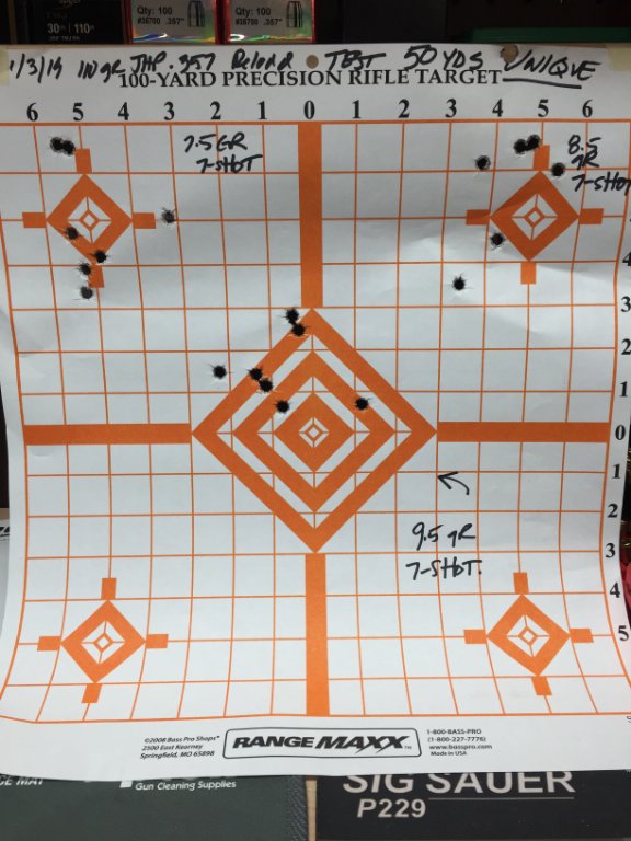

Given the above fairly inconclusive story, see target #3, shot from 50 yds with the remaining 7 rounds of each powder load. From this, I can personally tell even less. They are, for me, all below average groups, but not that inferior to the factory ammo I started out with, and none of the reload variables had the benefit of any scope tweaking (due to lack of enough ammo to have it make sense).

- Reload Test 357 110 gr JHP 1-3-19 002.JPG (90.86 KiB) Viewed 2612 times
- Reload Test 357 110 gr JHP 1-3-19 003.JPG (108.99 KiB) Viewed 2612 times
- Reload Test 357 110 gr JHP 1-3-19 004.JPG (111.74 KiB) Viewed 2612 times

If it were me shooting the biggest contribution to variability in results would be shooting from my elbows. Kinda might point to that in your control group and then it carrying over into your reloads. I think, like you suggested, is to do-over with a gun rest and bags to get better assured stance stability.

My thoughts would be to load the 8.5 to 9.0 grain load again and shoot 5 shot groups. But if it was me I wouldnt place to much merit in these 110gr bullets because I know when you go to buy anymore bullets I would think you would go more for a larger bullet. 125 would be the smallest I would use and most likely a 158. I would also agree with Mags and use some sort of solid rest

I most certainly agree that it is a good idea to minimize variables .... it would seem logical to move to a solid rest, better yet a lead sled .... as a matter of personal preference, I've never had good luck with light weight bullets in a 357 .... Henry uses a 1:16 twist in their BBS 357 .... it might be good to know the weight and profile of bullets that it is designed for .... some folks have reported decent results with 125's .... I've been using 158's since the mid 60's and know they work well

As above, when accuracy testing you must do everything possible to remove your shooting from the equation. You've got to use a good rest and, preferably, a bag both front and rear. You've got to be sure you are consistent in all aspects of your shooting technique. Shooting off of your elbows is fine for informal target work and/or plinking, but it is no way to accuracy check your loads. Now that you're into loading your own, invest in a good rest and good shooting bags.
Also time to slow down and keep that barrel from getting too hot. When switching from one load to the next, allow for a few shots with the new load for your barrel to season to it.
Also of the opinion that 110 grain bullets are a poor choice for accuracy in a 357. The 357 cartridge was designed around the 158 grain bullet and that's what I use anytime I'm checking the accuracy of a new 357. Save the 110s for plinking.
