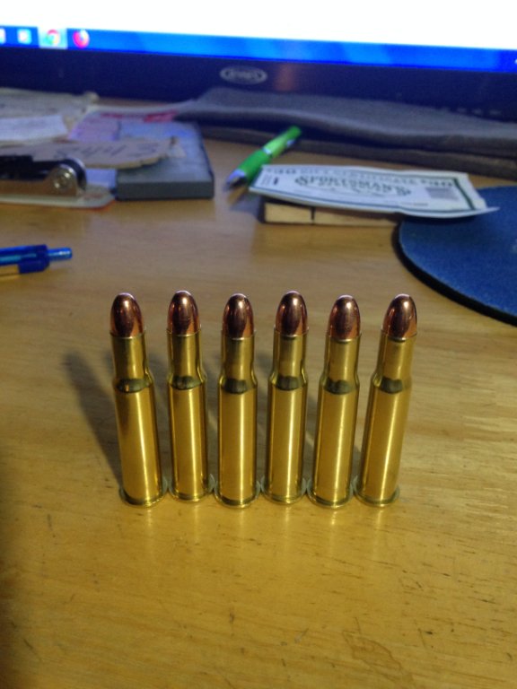

Post by Mistered » Fri Dec 14, 2018 9:11 pm
These 110 Gr. FMJ bullets make some purdy reloads!

Post by Mags » Fri Dec 14, 2018 9:34 pm
Shiny! Nice job buffing!
Mistered
Re: 110 Grain FMJ Bullets
Post by Mistered » Fri Dec 14, 2018 9:35 pm
Nice job buffing!
No buffing required - this is what the brass looks like after liquid tumbling.

Post by JEBar » Fri Dec 14, 2018 9:54 pm
"purdy reloads" indeed .... have you run them through a chrony :?:
Mistered
Post by Mistered » Fri Dec 14, 2018 10:01 pm
Haven't even shot them yet - but hopefully will this weekend.
No chrony - but the 100 grainers clocked in at 1700 FPS through a friends one time.
Never felt the need to own a chrony - always loaded for accuracy & performance & never felt the need to 'know' the speed of the bullet.
Posts: 20441
Post by JEBar » Fri Dec 14, 2018 10:09 pm
having one certainly isn't a necessity but I find it gives me some very helpful info .... I use one for two reasons .... first, to ensure that the loads I develop consistently generate very close to the same muzzle velocity .... a marked lack of consistency with light loading our 45-70 has been an issue .... secondly, knowing the velocity and ballistics coefficient enables me to run the load through a ballistics program to determine the bullets trajectory .... that allows me to sight one it at a short range and know very close to where it will hit at longer ranges

Post by BigAl52 » Fri Dec 14, 2018 10:46 pm
Whose bullet and what powder are you using?
Mistered
Post by Mistered » Sun Dec 16, 2018 11:17 am
The bullets are Speer and 12 grains of Unique.

Post by mrguvna » Fri Dec 21, 2018 2:46 pm
I loaded some of those with 26 gr imr 4198 and they were screamers. I was shooting steel targets out to 400 yds easy.
