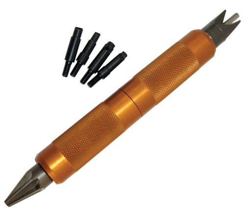

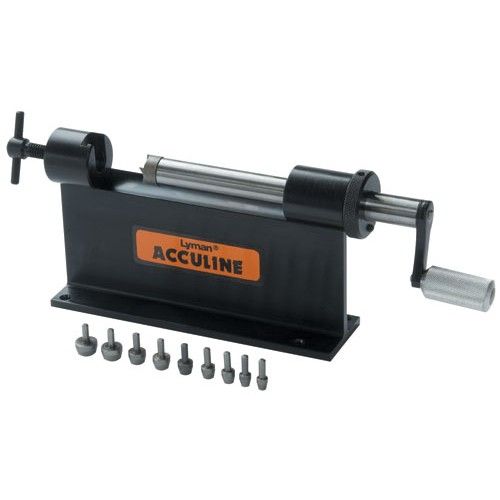

Do you advocate this type of tool ?
...and to remove burrs, and also clean the primer wells :?:
(lyman multi tool case prep)
lyman multi tool case prep.jpg (17.94 KiB) Viewed 2549 times

Straight wall cases dont stretch as much as bottleneck cases do. Both of those tools you have posted should do the job. You will also need a caliper to go along with your tools for measuring. I havent had to trim any 45-70 cases yet and Im almost betting that if one does get to that point of trimming that it may only be done one time. Al

agree with Al .... once I've set our bullet seating die to where the edge of the case is in the crimp ring, I don't resize cases until they reach a point where the edge is outside of that ring .... if you purchase the trim tool shown in your link, find a case that is the correct link and save it .... use it if/when you need to test or reset the tool .... as Al mentioned, I don't find there to be as big of a need to trim straight wall cases as I have with bottle neck ones
