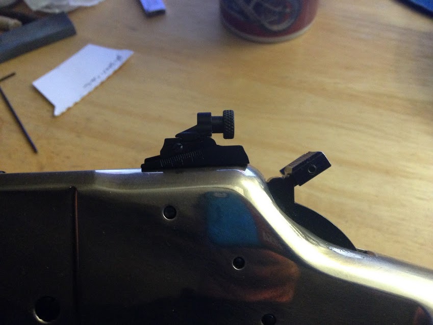

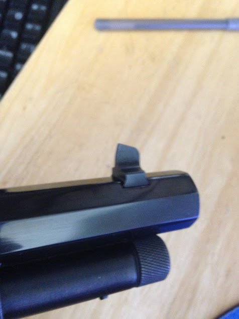

While I like my Henry BBB .357 I hated the stock rear sight from day one. It is literally one of the worst I have ever seen supplied on a new rifle. Tiny 'U' groove (I enlarged mine) small and hard to adjust blade. I shot it a little with mine but eventually installed a Williams 336 top mount peep sight and really like it - which I knew I would considering three other levers I own have Williams' on them. The 336 is intended for the Marlin but fits the Henry like it was made for it by reversing the windage slider in the dovetail and mounting the sight 'backwards' (see my post with a pic of this) then read my range reports with target pics showing the results. It's a less expensive alternative to a Skinner however the front sight needs to be swapped with a taller one for the proper sight 'plane' . I went with a .490 height blade and this works well for me.

and new front sights plus smithing could easily be $50. Make sense?
No smiting required - front sights are easy to swap.

Mistered, your Williams 336 (mounted backwards!) looks very nice, but is there a simple way to attach it to a BBS 357? I'll google that for more info, so thanks! And interesting to hear that front sights are an easy swap. I'm used to the pistol world, where you need a sight pusher and/or a gunsmith.

Post by Mistered » Sun Jun 24, 2018 2:40 pm
If the BBS has the same two (.5 on centers) holes on the as the BBB does then it will mount the same - with the two screws provided.

Post by Mistered » Mon Jun 25, 2018 9:51 am
Yes, I believe all the Big Boys are drilled identically.
Well if this is the case then a Williams would be an inexpensive (about $39), and easy install. You would still however need to install a taller front sight.

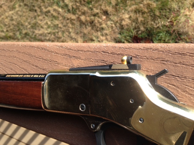

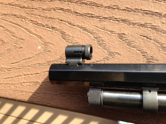

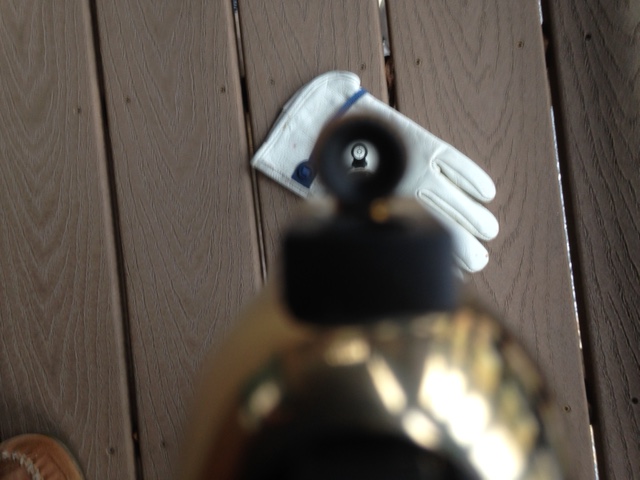

Welcome to the forum from Viginia's Shenandoah Valley, ESquared. A 357 steel BigBoy is an excellent choice for your first Henry - very fun and versatile caliber in a lever gun - congrats.
Here is another option for a sight setup:
Skinner peep on the rear, Lyman Globe on the front. For me, this setup works much better than the factory buckhorn/front bead set that comes on a new Henry. In good lighting, this is almost like looking thru a 1x scope, but still keeps the old "lever gun" look for the rifle.
BBB44 (2).jpg (127.58 KiB) Viewed 2821 times

Post by ESquared » Mon Jun 25, 2018 10:54 am
Thanks, Tractordad, that looks like a very nice setup! I did a quick search on Amazon for the Lyman Globe, and, of course, there are a few of them, at different heights. Do you recall which one you installed?
Looks like they come in .404", .584" and .700".
And, then it looks like they sell inserts.
Can you tell I have no idea what I'm doing?

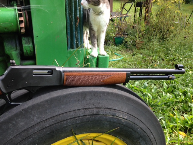

Post by tractortad » Mon Jun 25, 2018 11:42 am
ESquared wrote:Thanks, Tractordad, that looks like a very nice setup! I did a quick search on Amazon for the Lyman Globe, and, of course, there are a few of them, at different heights. Do you recall which one you installed?
Hey ESquared - I didn't know anything about Lyman Globes or Skinner peeps before I got my first Henry, either. I learned about this from another great Forum member named Squatch (unfortunately recently passed), who wrote an excellent post ("The Process") on his experience while setting up this same setup on his first Henry. I'm just repeating his knowledge.
The setup you see in the previous pics is a .494" 17A Lyman Globe front sight paired with a Skinner "Express" BigBoy rear peep and Lee Shaver inserts (they are finer looking inserts - better for target shooting). This same setup would probably work on your steel 357Mag BigBoy, but you really don't know until you try it. I have found the best place to buy the Lyman Globes to be Midway or Brownells.
Don't want to make it more difficult for you, but here is another setup that would probably work on your Henry:
A Skinner "Low-Pro" rear peep with a .404" 17A Lyman Globe on the front. The Low-Pro is a less expensive Skinner option, but still works great on a Henry. If you go with this, make sure to get the 8-40 threads.

Post by ESquared » Mon Jun 25, 2018 2:27 pm
This is very helpful, Tractortad, regardless of where the information originated. It's so nice to be able to tap into the wealth of knowledge and experience here!
That "Low Pro" option is very appealing to me, not because of the cost difference, which is a good thing, but because of the way it looks.
To my untrained eye on these Henrys, "less is more" in most cases, and that certainly fits that bill. That's kind of the knock on putting scopes on these beauties, isn't it? Just sort of distracts from the classic look. What you've got there is a very clean, uncluttered look, especially once you remove the buckhorn.
I'll continue to explore ALL of these options, but right now, the Low Pro is at the top of the list.

Post by ESquared » Mon Jun 25, 2018 2:34 pm
Me again.
There seem to be lots of Lyman Globes that start with "17A". There's 17AHB, 17AUG, 17AMI, 17AML.
So sorry to continue to go back and forth, but can you confirm which one is in your picture? I'm guessing it's the "17AML", as that seems to be the only one that's .494". Do I have that right?
