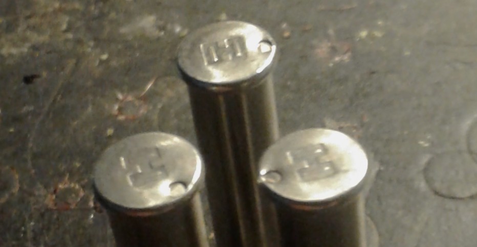

The only thing to add is the base of the expended shell looks bulged or rounded.
That's the best shot I could get.
I have ideas why the keyholeing is occurring, bullet length my first thought, but the odd looking spent shells add another variable I can't explain.

I contacted HRA today about my 22mag Octagon. The bore on my 22lr and 17hmr have substantially deeper gooves than the 22mag. The grooves of the 22mag can be described as whisppy. The 22mag also has several straight lines running the length of the bore.
