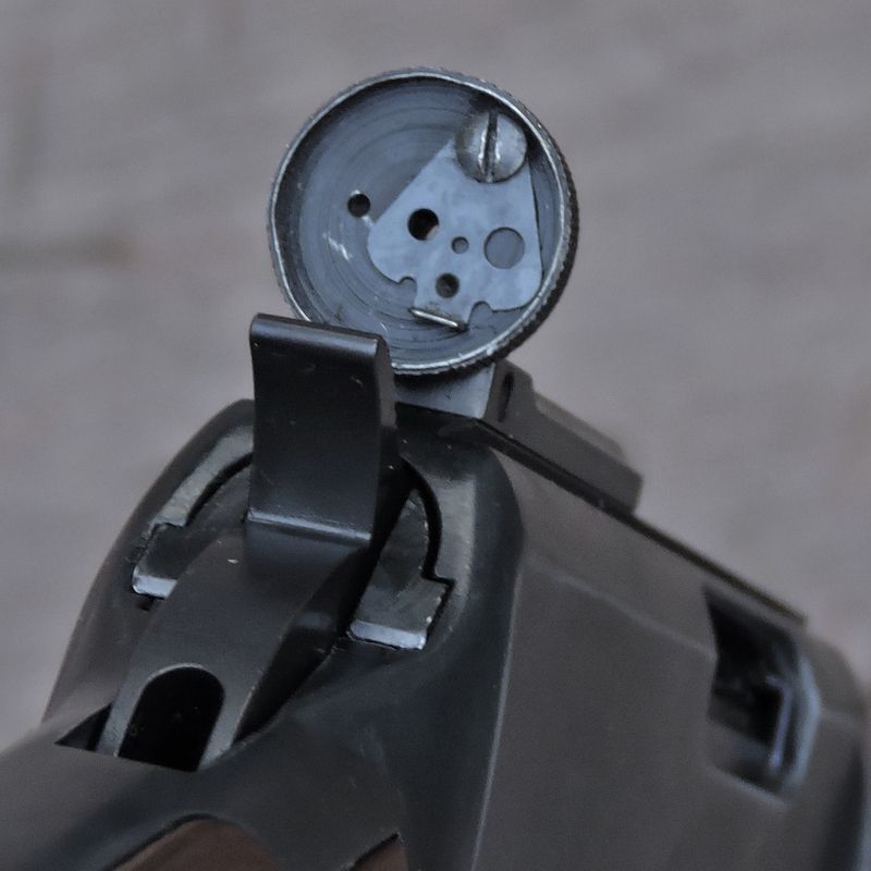

This is a Steven's No 105 three-hole peep. One peep does it all with just a quick change.
